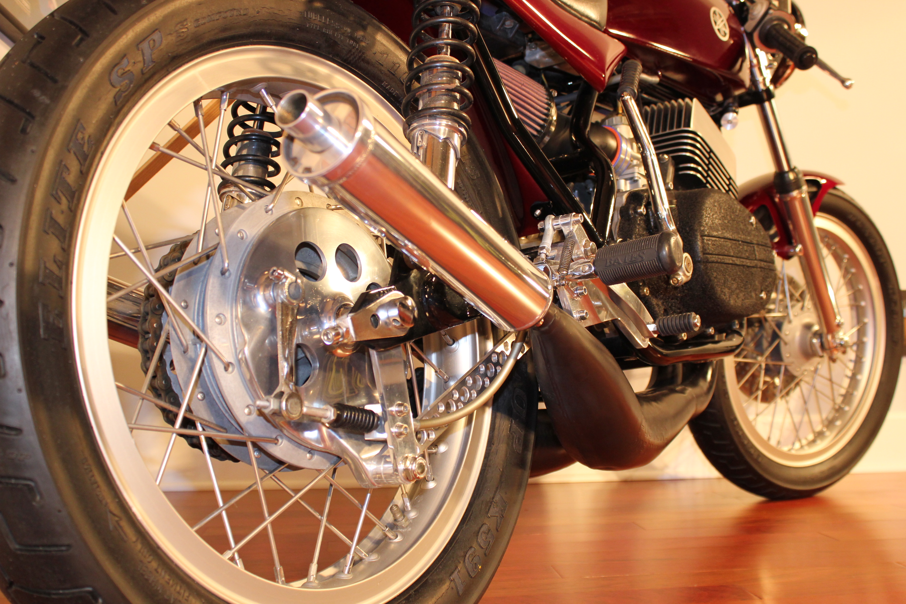

Gill,
I've scrapped the design I had for the brake side. I'm going to run a cable brake on them. Waiting on some cables to come in so I can get the brake stay rod made with the cable stays.
I made one with the cable stay on a separate bolt-on part. The cable ends are silver soldered on to the cable - very strong, the cable will part before the soldered connection, but time intensive for making them for sale at a reasonable price. Are you thinking of placing your cable stay on the brake stay arm? That would probably be simpler but I couldn't determine a cable routing I liked. Looking at it now it seems like it would be pretty easy to simply have added it to the brake stay. Easiest would be to weld a boss on the brake backing plate, but hard to sell it not being a bolt on scheme.
I'm going to sell them as a bolt on kit. The cable stays will be on the brake stay arm. A billet arm will be included with the kit, along with the cable.
It may be a bit pricey, but they will be top notch quality.
