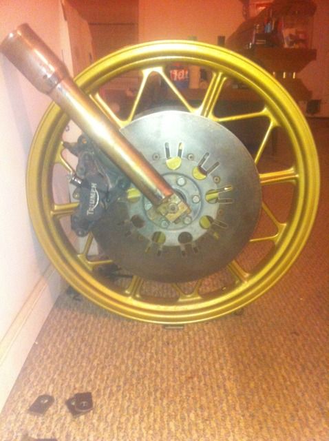

Dropped the lower legs off at the machine shop today to have the "flats"  milled into the ends of the legs to give the spacers a place to rest and also have the spacers made. I fit the calipers from the Ninja ZX1100 and they will work nicely. Important part is they clear the spokes. I wish I could have a fixed opposed piston 6 pot caliper, but it is what it is.
Mockup with a wood broom handle for an axle, hey it works for mock up.
Offline o1marc
  • Posts: 2242
    • Creative Candy Powder Coating
Re: 1970 Triumph Tiger 650
« Reply #5 on: Jan 12, 2016, 20:20:59 »
 Got the lower legs back from the machine shop today, got lucky and they knocked it out over night. Had the flat machined on the inside surface and a couple of wheel spacers to center the wheel:
Caliper mount brackets cut and ready to weld on and that should complete the swap at the wheel.
Just need to fab a sheetmetal bracket for the proportioning valve/splitter under the lower tree.
