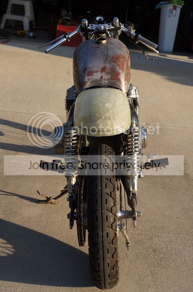

First thing I did was ditch the original '78 K tank in favor of an earlier model.
And because I can not leave well enough alone... I made up some mounting tabs and welded them to the tank for turn signal mounts.

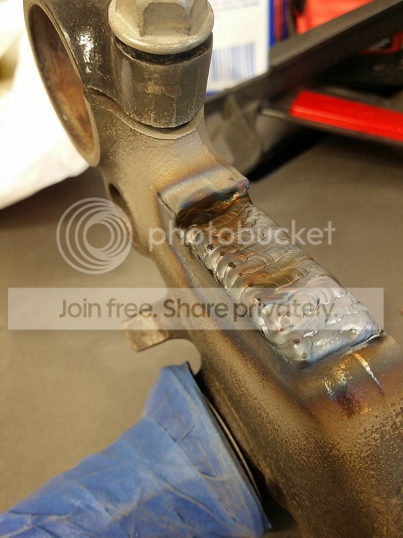

I de-tabbed the entire frame and shaved the swingarm.

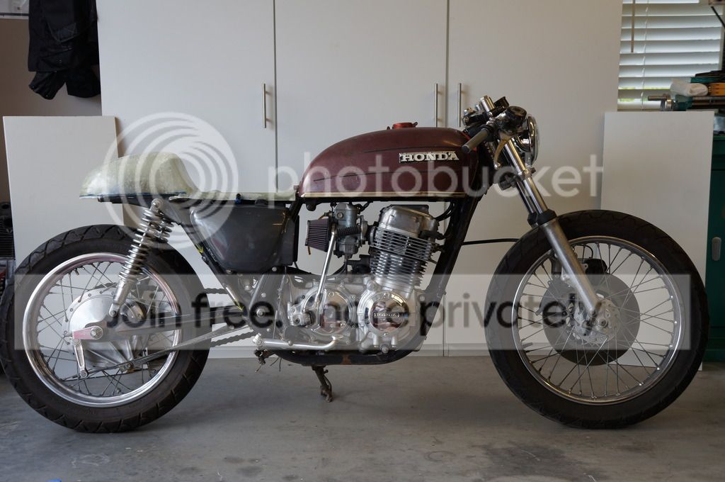

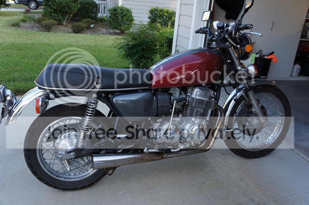

A quick before and after.
Because, who doesn't like before and after pictures?
