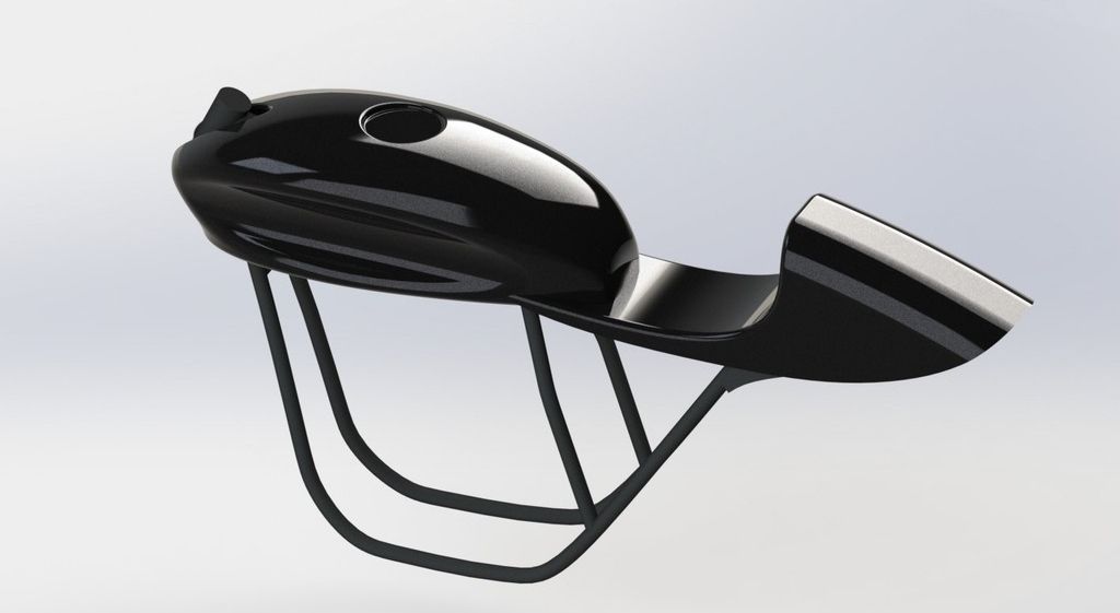

Long time.. Little progress...
I have made the upper part of the tank and it looks pretty mean! But sadly that's about it for this update.
Here are a few timelapse videos of the process
I vacuum bagged the part into the mould. It has 2x layers of basalt, 1x layer of kevlar, and I think 4x layers of glass.
Here's the part in the mould with the peel ply removed:
And fresh out of the mould:
There are a bunch of bubbles and a few big voids which will need patching with epoxy and polishing back. Luckily though most of these imperfections are on the upper half of the tank which will be painted over so I think I'll get away with it. I think one of my big mistakes with this part was mixing up 500ml of epoxy at once which started to heat up and gel really quickly meaning that the first batch of epoxy in the mould was nearly set by the time I applied the vacuum. I should've mixed much smaller batches and possibly done the part in a few separate layups. Still planning to make a second one of these parts so hopefully I can do a better job on the next one.
Finally, I gave the tank a trim (damn hard to cut through kevlar btw. took two nights and a few hacksaw blades) and mocked it up on the frame. It's just temporary and not sitting in the correct spot but pretty happy with how it transforms the look!
Did a quick photoshop which shows what I'm aiming for. Added some paint, shifted the tail and tank to their correct position, removed the cans (not sure exactly what I'll do with the exhaust), shortened the subframe, shrunk the front fender, and raised the rear sus.
Next step is to make the mould for the base of the tank, line the inside faces with Caswell tank liner and glue the halves together to finish off the part. Once I've got it together and checked it fits the bike then I'll go back and lay up the second tank.
