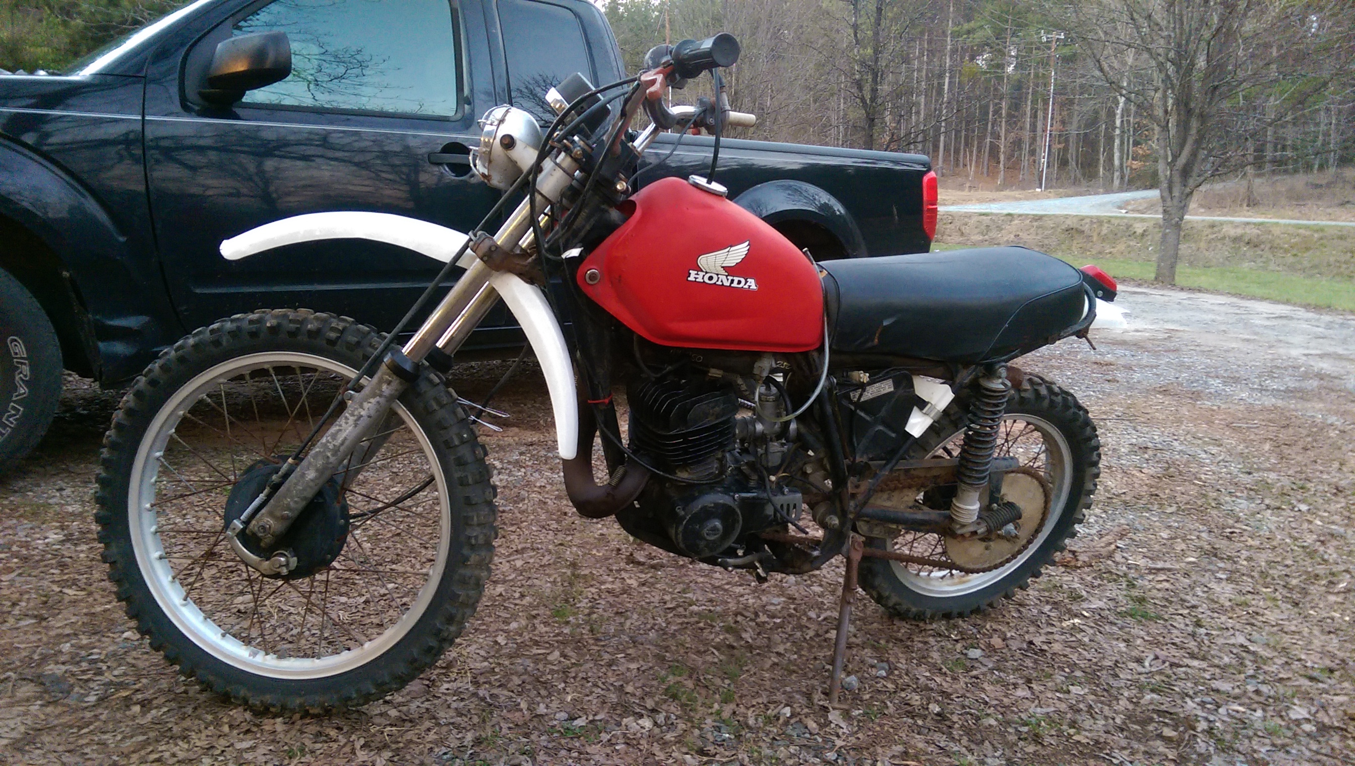

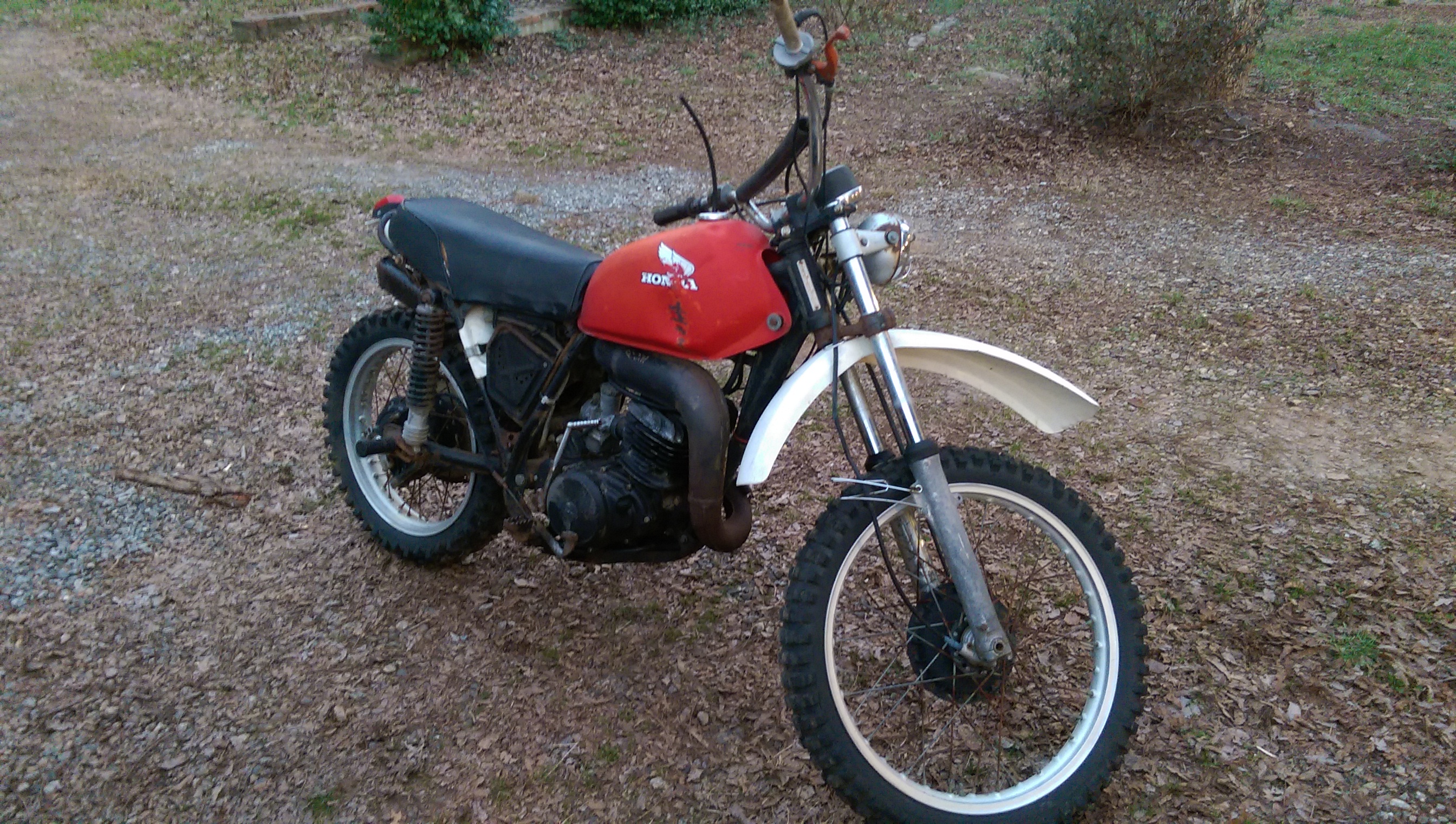

This place needs more Elsinores  :)  So its been a few years, time for another abomination from my garage.  This time it's time to get a bike ready for the Vintage 1000 this summer on the Trans America Trail.  The bike to be used is a '76 Honda MR250 Elsinore.  Here's the deal:  The bike needs to stay under $1000 excluding tires.  My wife bought me this for Christmas for $400. So I hope I can keep it under the limit.  Its surprisingly complete.  It even had the requisite swamp mud in the motor.  A bit of messing with it and its got spark. even sputtered once.  But before I jump on it too much the motor is coming out for a full freshening up.
