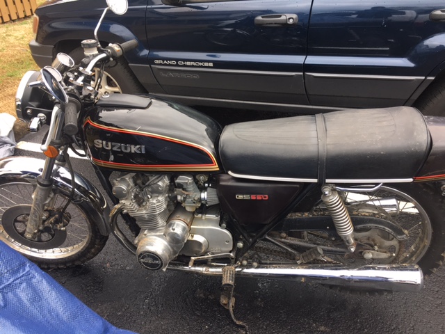

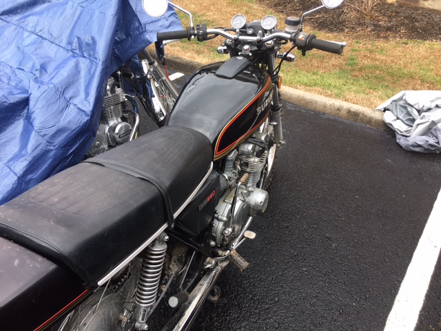

H everyone. Long time lurker, first time poster. Just bought a Frankenstein Suzuki GS550 that has a '78 frame, but parts from various versions of the GS550 up through 81, including the E and T. Around 8000 original miles and runs like a dream. I'm taking a lot of inspiration from...

Image of the bike as I bought it is attached below.

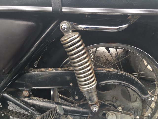

First thing I did was take off the 13" stock stocks and put 10" shocks, as I'm average height at 5'7" but with a VERY short inseam of around 28". I'm about to reduce the height in front the same way he did in his videos, removing the insert, cutting the spring, and cutting the tube. Pictures forthcoming.

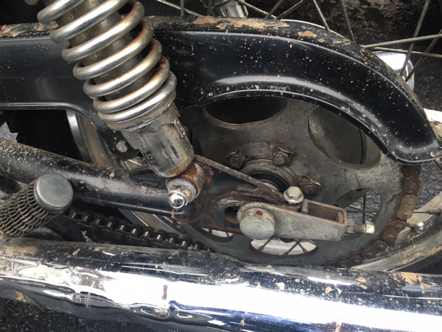

Spent some time this weekend working on the new rear shocks. The original OEM shocks came with the bushings permanently installed in the shock assembly, but I needed the metal insert out of the center, so I took a hand torch and melted the rubber on the original bushings, and beat the inserts out with a hammer. Then, I put them inside the newer (and smaller) rubber for the new shocks, and used a wooden mallet to beat the new bushing assembly into the new shocks. No pictures of this process as it is pretty self explanatory, but if anyone has questions about this process, let me know.
