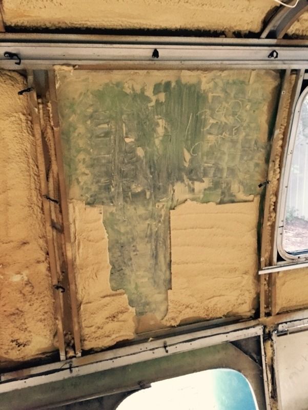

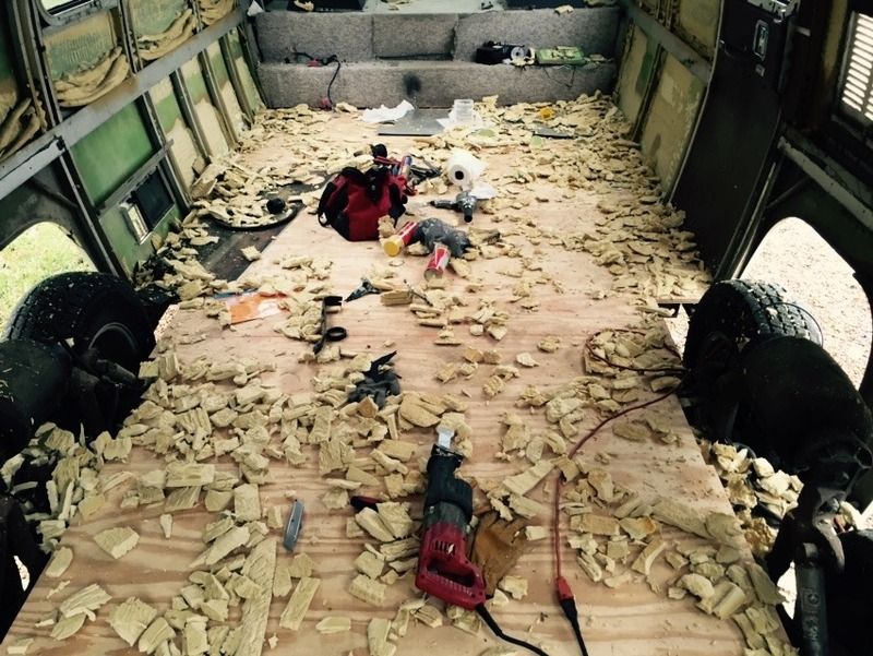

From there I spent a ton of time with a sawzall removing all the 40 yr old insulation. This was a HUGE bitch, and will never be repeated. If I do this again, I will simply spray over the old foam with new to fill in the shitty factory job. Way more work than it's worth.
