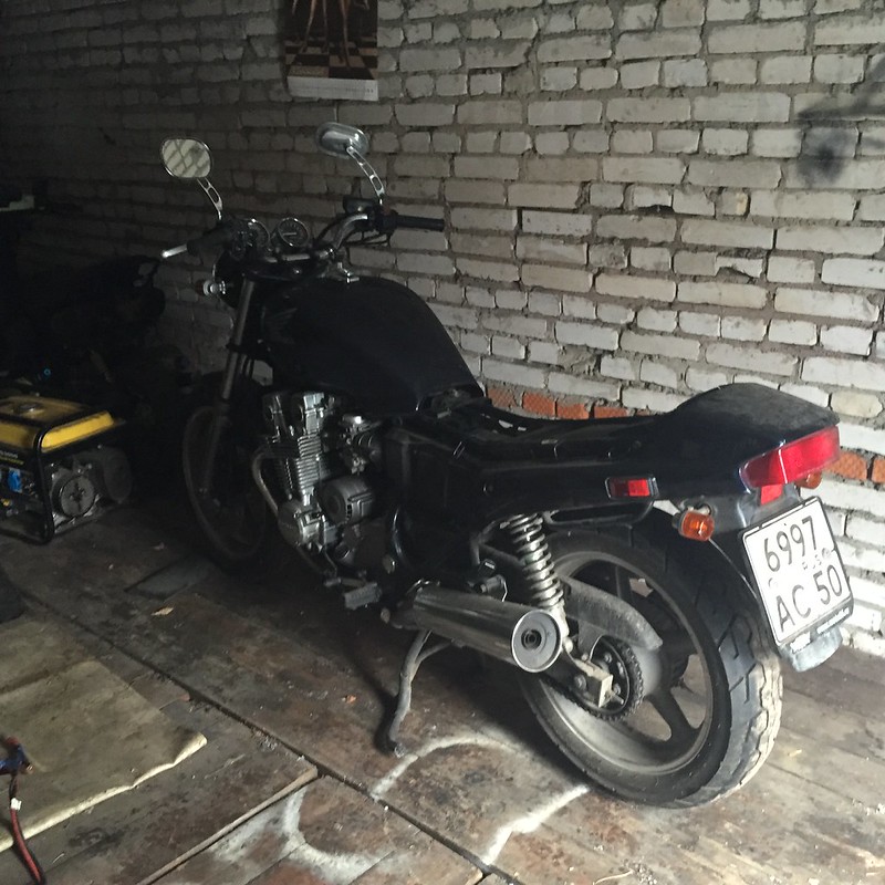

Couple original pics. Imported from japan in 2013 (fun thing it have no VIN at all) and stayed in garage for most of the time since that time:
Did a few test rides in garage before disassembly. (russian license plates size is a bad joke)) Engine was running very good, brakes fine, just wash it and ride)

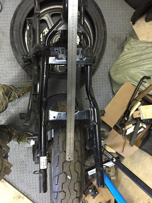

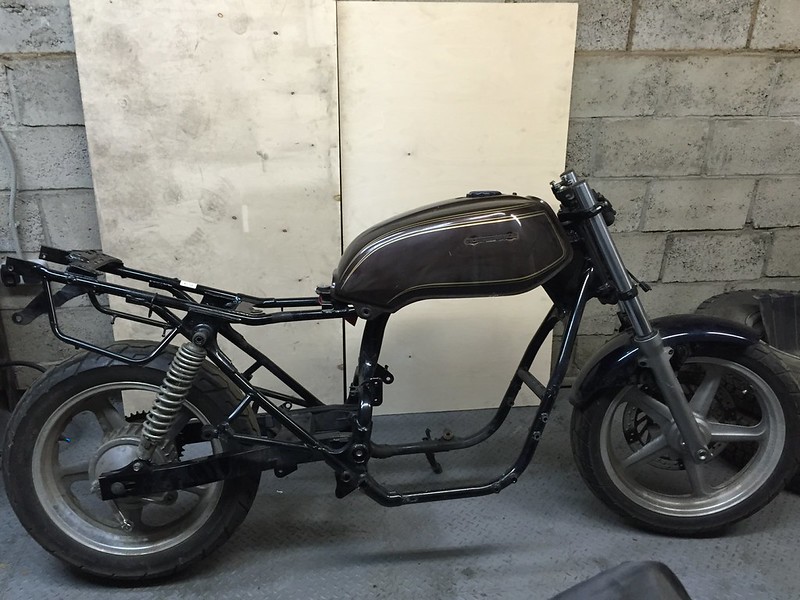

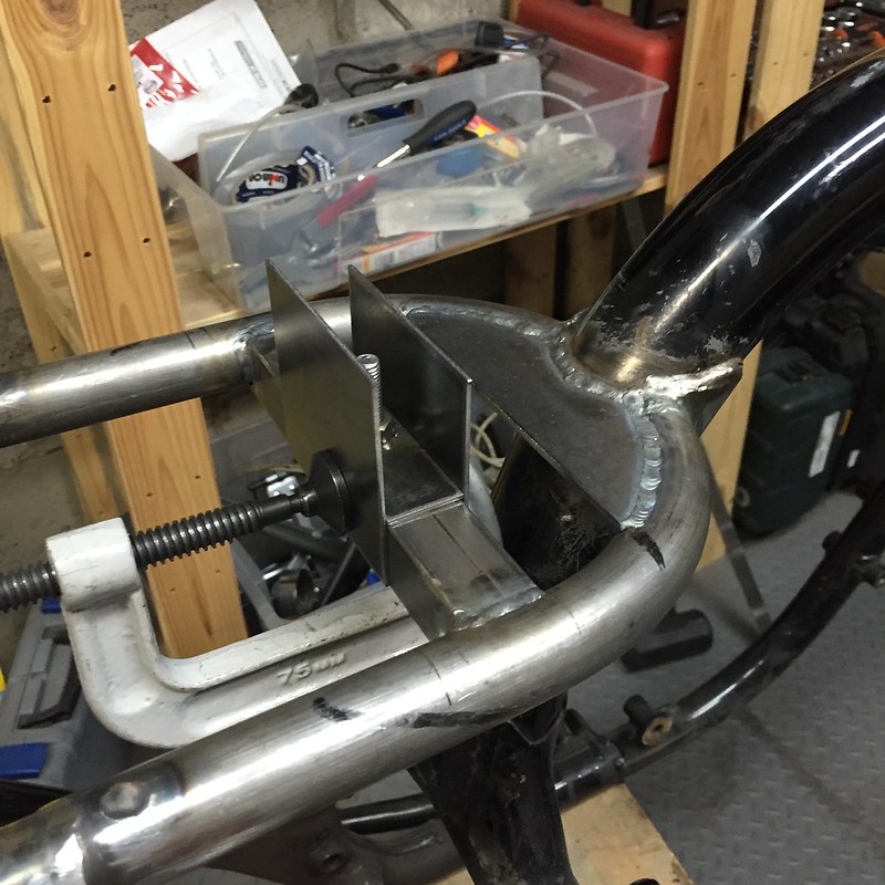

Yeah so anyone who would try to build something from 199x cb750, beware of pretty messy tubing
swings up in the middle of seat
looking upside down is a pain
Just had to cut all that
And then using dime city's frame loop set, put it on top. Managed to keep stock upper shock mounts and very glad about that.
Tank is some '79 cb750
I considered few options on seat/rear solution, and somehow liking/moving towards upsweft seat, no cafe cowl..
Cheers!

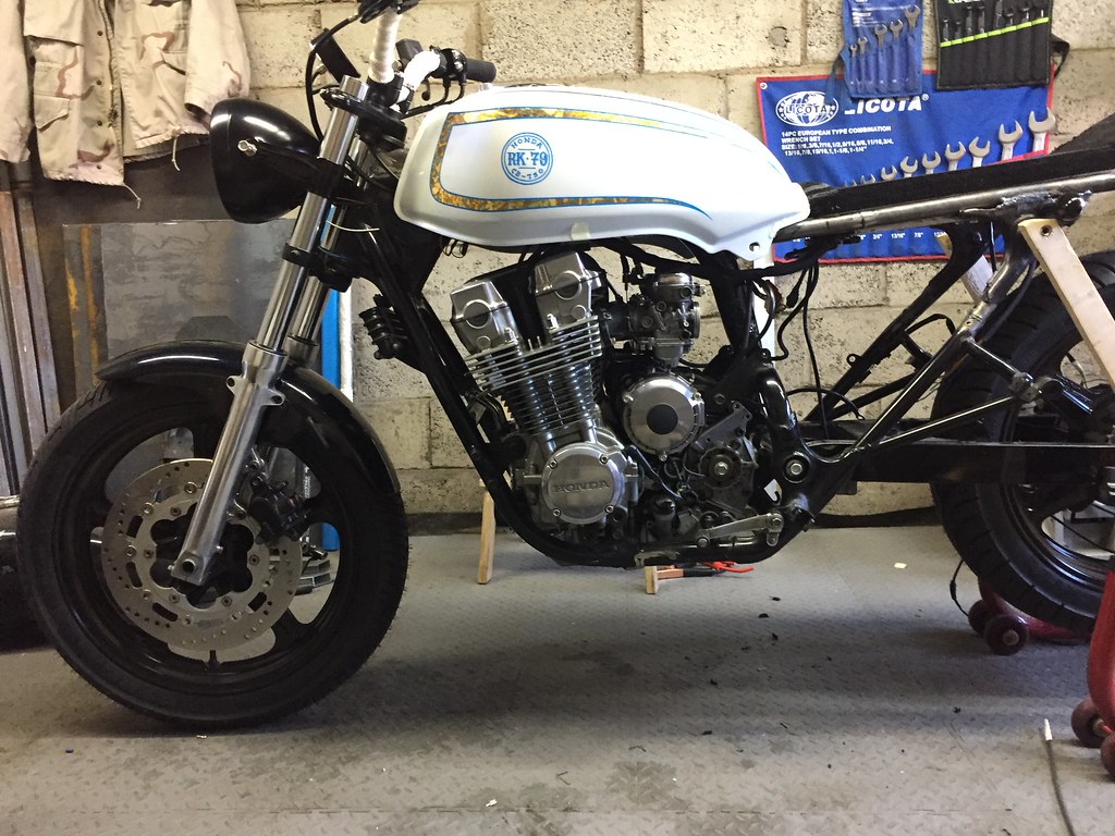

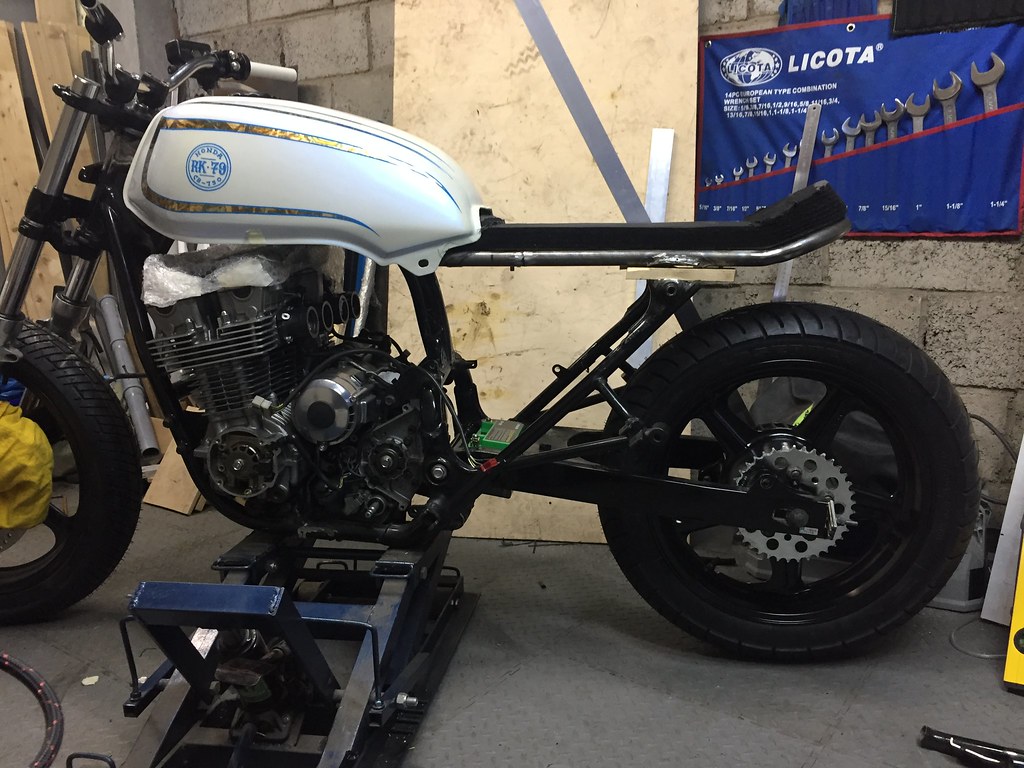

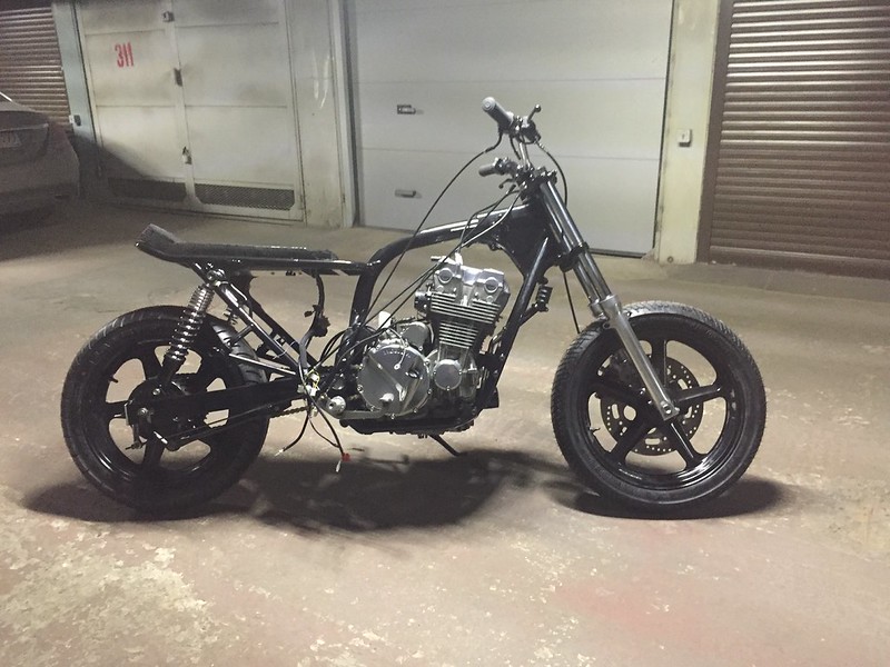

Bulid's going on.

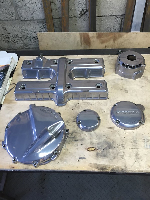

Aluminium parts cleaned and polished
Engine getting almost done after top end overhaul with clean covers on

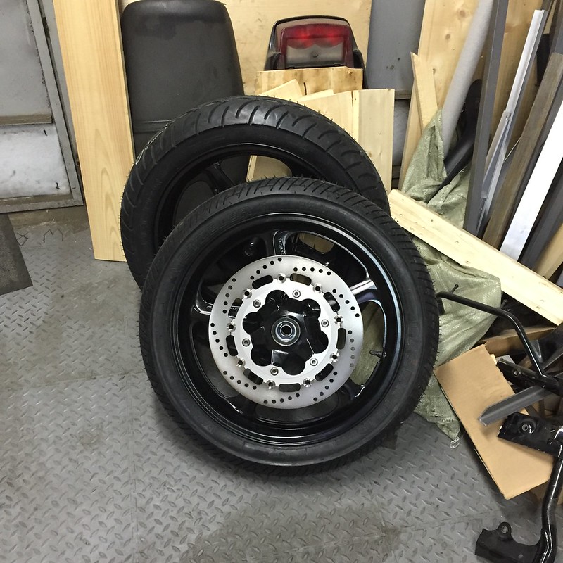

Wheels painted and assembled
New tank mounts in progress
Bike wont make it for 2016 gentleman's ride.. But next year for sure, winter is long..

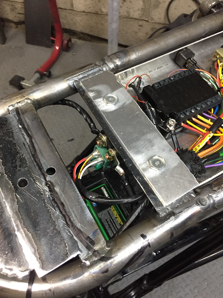

Some progress with tank, halfway done. About to throw some stripes in stock paint style and some more stuff.

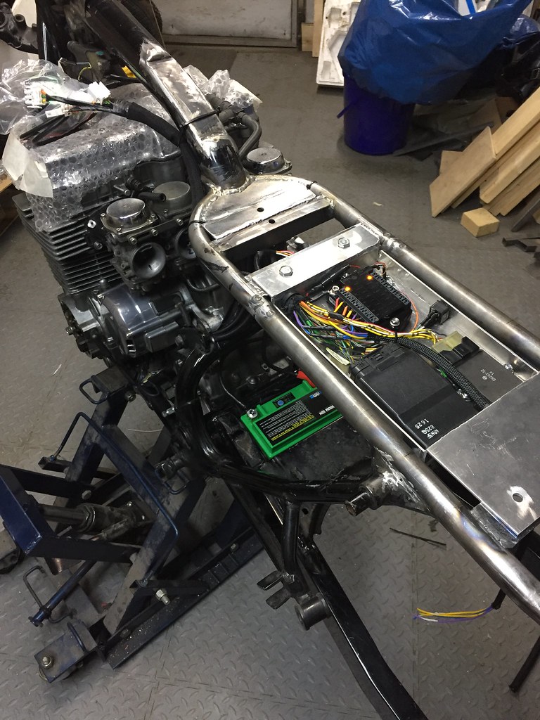

Aluminum electric tray in progress and lipo battery found its place in swingarm:

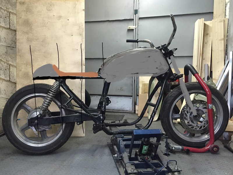

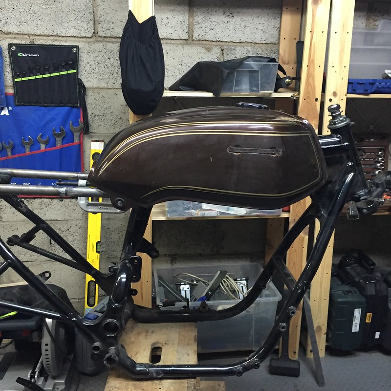

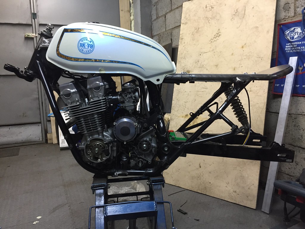

Guys who did tank repaint, they mostly do bobbers with all that gold leafing and flaking stuff.. So it went totally other direction with me comparing to what I originally thought and ended up pretty wild. Still somehow looks good) Anyway repainting is the easiest part, now about to assemble this alltogether..
In fact '79 tank fits 1991 frame very bad, due to backbone raising high. So tank is too high and too far from neck and with petcock hitting carbs. Its fotoshopped desired placement here.. Will figure out actual fitment on next garage session..

i used a 78 tank and had some of the same issues but i am getting there a few more days and i will tear it all down to make it pretty

Ok so electrics (version 1 at least) seems pretty much done now
With starter relay found its place under seat
And some connections towards handlebar hidden under the tank.. And new tacho looking awsome..

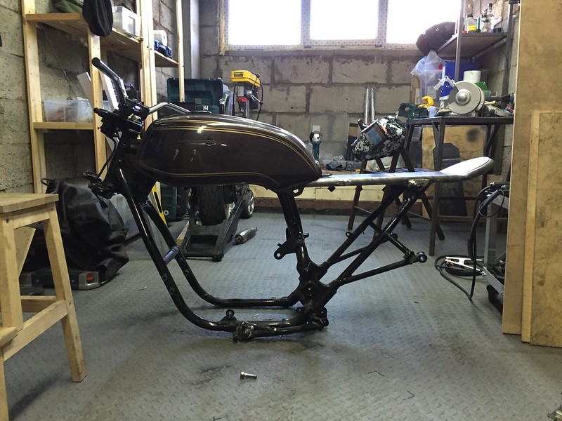

With seat pan, looks clean and nice..
And tank finally sits properly in place
Feels excited on how nice it all comes together so far.. Front end is next for assembly, let's see..
