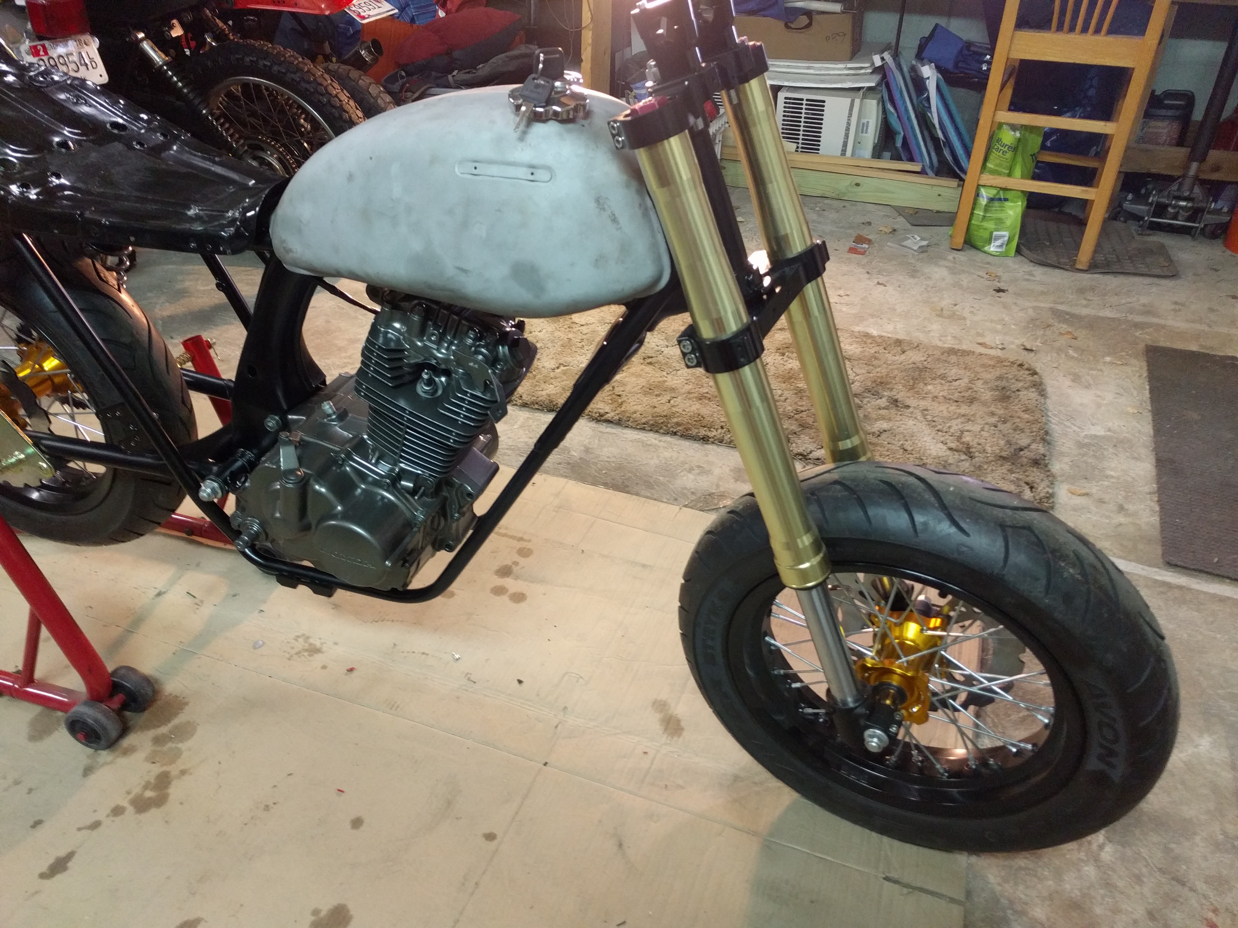

SL125 frame
The SL100/125s are pretty cool imo
330mm shock, 700mm front forks, 16 inch rims
CB160 swingarm to get a little more length over stock
Not crazy about the mags
Found these 3.00x14 spoke rims on aliexpress
I went with 120/80-14s front and rear
The front end is from some pit bike
An ebay'd xr200 motor can drop into this for a 220lb bike; need something capable for stints on the highway
Here it is in the middle of tear down and inspection, for new top end, beefier clutch plates/springs, and modern oil pump
glad I did, because whoever had this motor before me didn't know how to tighten the cam chain so it chewed into the cylinder
and washed the whole thing in metal shavings.
And oil spinners work really well.
-1.5" on the seat
since it was originally drum brake, I will sort something for the rear disc conversion
Por-15 on an old seat pan
Thanks

I got a few more bits to move ahead with
motor is starting to come together.  Finally got the machine work done and back.  High comp piston, new cam and new valves
little battery to keep the lights on.

- reamed the axle tube to accept a 14mm axle, which is what this cb175 swinger needs to work with my frame
- found some shocks
- finished the motor and fitting/bracketing
- tryin out the exhast
I think I like the low straight the best.

I have made a little bit of progress on this build.
Have all the wheel spacers made and the front and rear brake hangers fabbed as I am going with Brembo 84mm crabs instead of the KTM calipers I originally had.  This means I had to switch out for larger brake rotors becuase the crabs hit the spokes on the wheel with the smaller rotor diameter.
Time for paint
« Last Edit: May 10, 2017, 23:23:58 by cbinvb »
