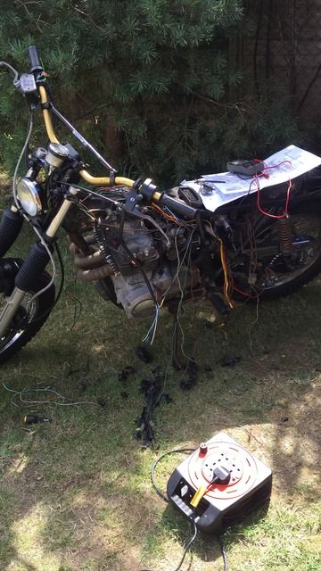

So while I was away over Christmas 2015 my dad saved this bike from the side of a guys garaged where it had been for 15 years.
Over the next 9 months I got it up and running, renewed stock parts, removed some parts and added some new parts. I also bought a CB750 rolling chassis and used the front end. The main parts are :

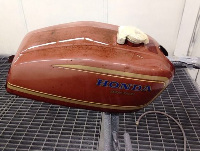

The tank has been lightly rubbed down and then Lacquered over the topm, a friend of mine got this done and it cost me a 2x 24 bag multipack of crisps

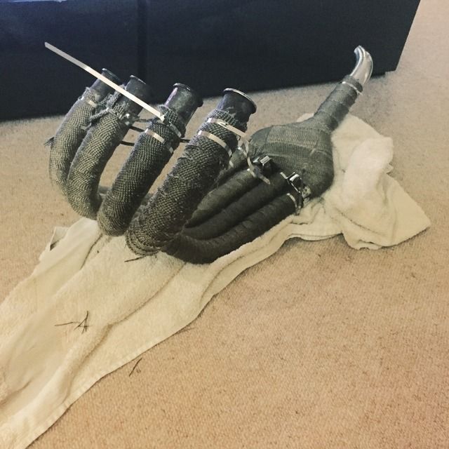

The exhaust has been wrapped with a baffle welded inside and then a tip on top, the metal tie wraps have been binned and the wrap is now held in place by locking wire
Anyway.... Here are a couple of build pictures from along the way.

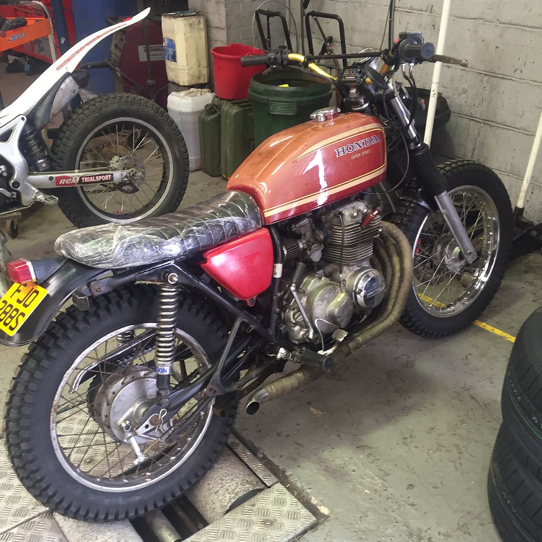

Then came the MOT
Offline SonOfNoRiders
  • Posts: 3
Re: 1977 CB400f Tracker Long Term Project
« Reply #1 on: Oct 13, 2016, 15:10:41 »
It Passed the MOT !!

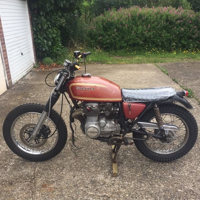

After this I had to change the main jets as they were too big and I have just balanced the carbs, here are some more pictures of it:

Nice work with 400....it has a life again and looks good as well, enjoy the ride!
