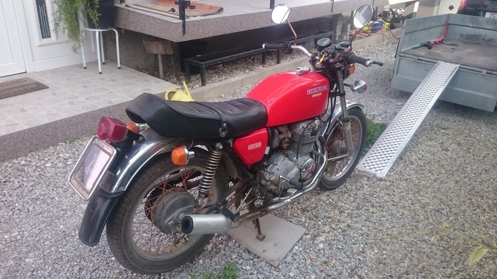

I have purchased the CB400F in rather poor state, but all original parts were there an it was a good base for what I hoped will become a Cafe racer project. But somewhere down the stripdown process, where I have seen the real state of the original parts, I have chose to make an restoration of the bike. So here I am, starting this thread to show my progress and to gather some useful tips and advices during the process.
Here's the bike when i brought it  home:

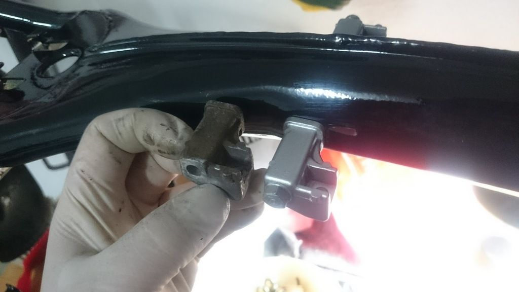

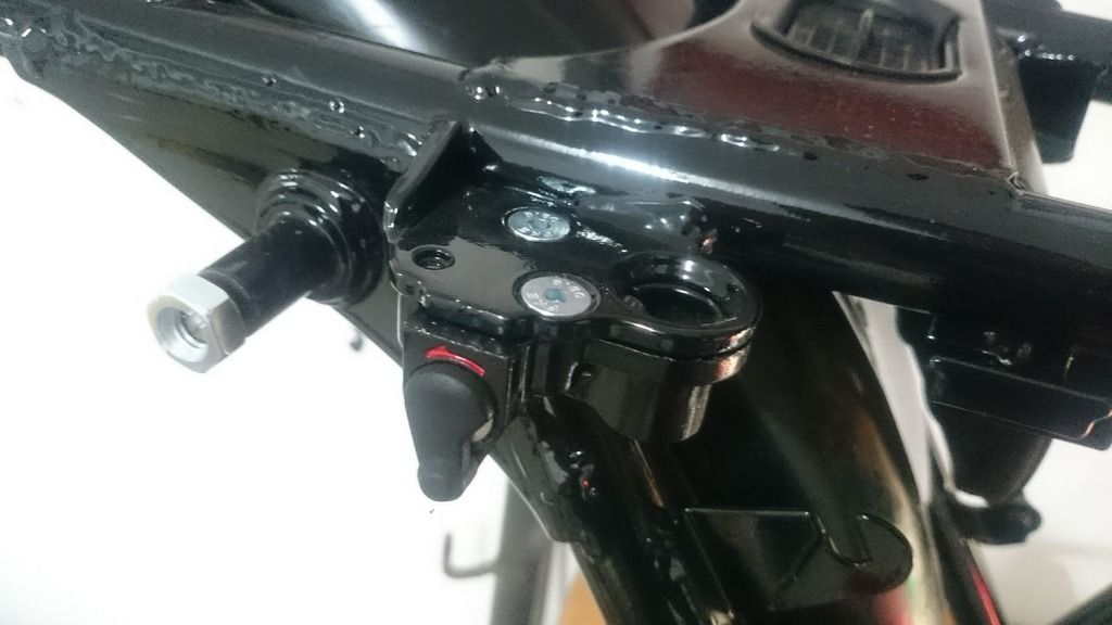

Frame and other bits were powder coated, so I started with reassembly.

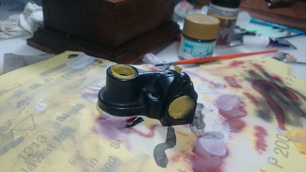

Seat lock repainted, and reasambled.

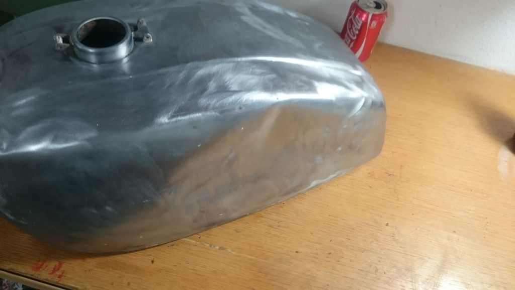

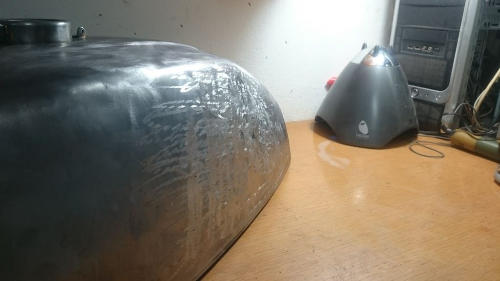

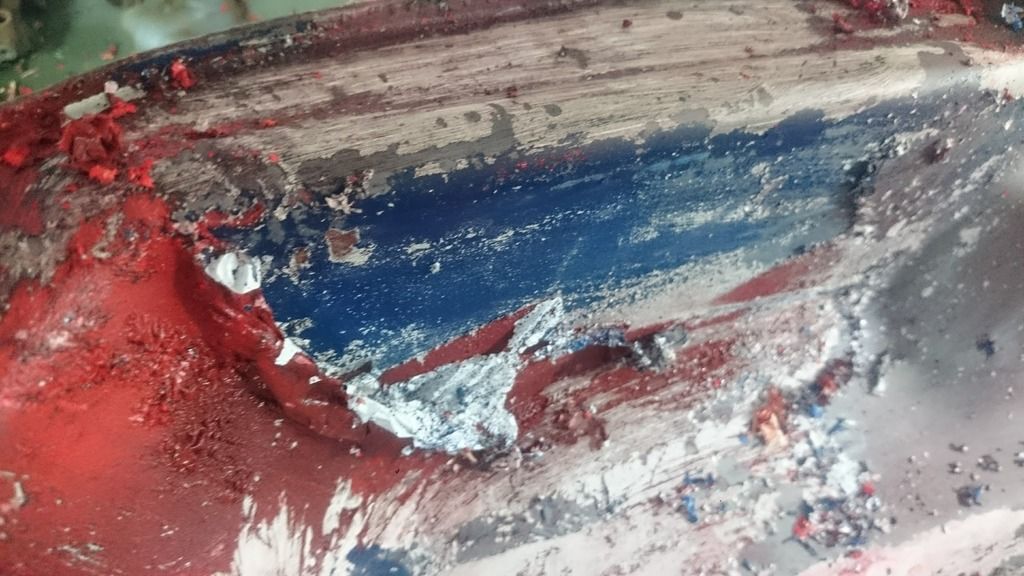

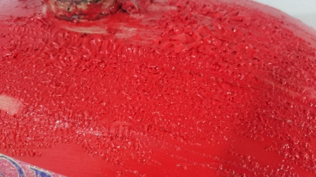

Fuel tank paint stripped down

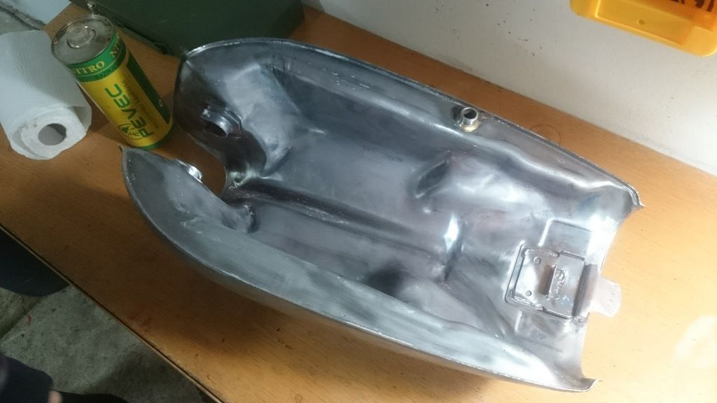

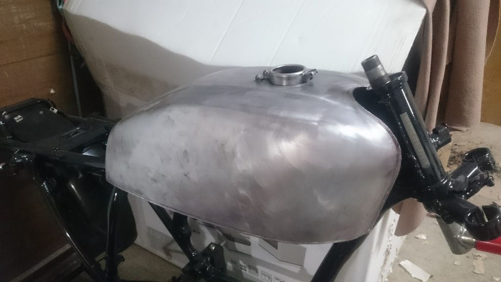

Fuel tank had a dent on left side, so it was sorted out. Next job is to clean and seal interior of the fuel tank. Anyone had any experience with POR15?

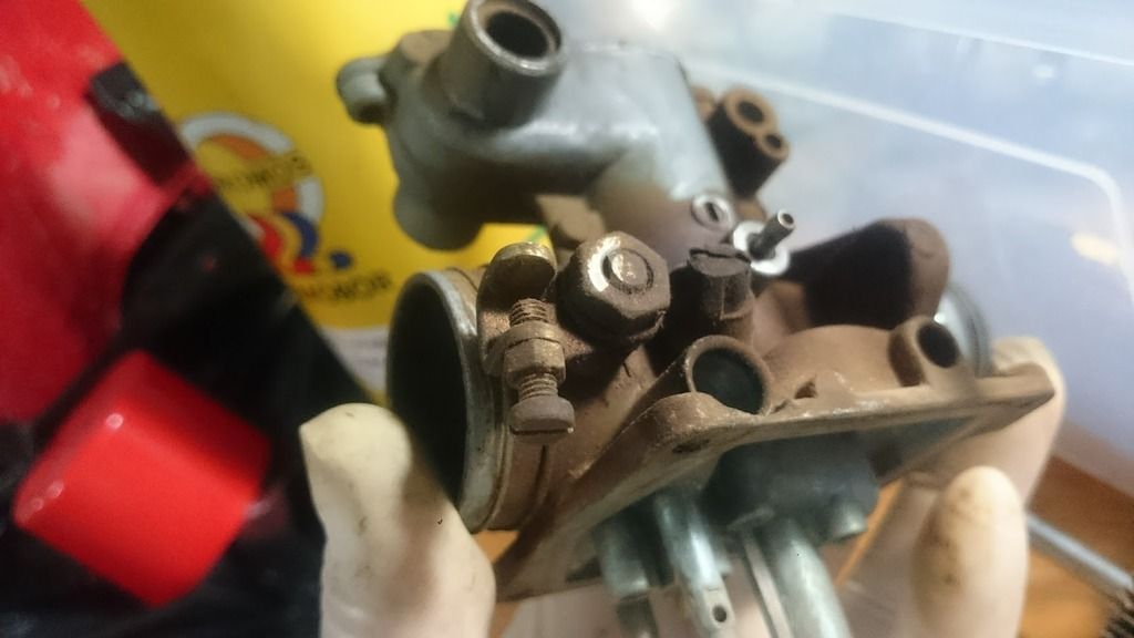

I have started to clean the carburetors, which were in horrible state from the outside, on the inside only one was in poor condition, and will need new float and jets.

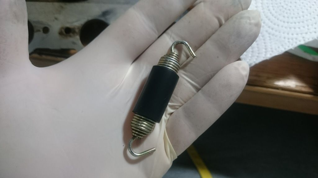

Spring cleaned

 POR15 works great just be sure to prep it well use phosphoric acid to derust and etch then rinse with denatured alcohol before coating.

« Reply #5 on: Oct 16, 2016, 23:32:34 »
If the tank is good inside why coat it? Keep it full of gas and use sea foam or similar to keep the ethanol issue minimal.

I was thinking about the POR15 because it will postpone(and maybe eliminate) rusting of the tank. Inside job even now isn't too good, so I think that any additional protection would be better option in the long run.
