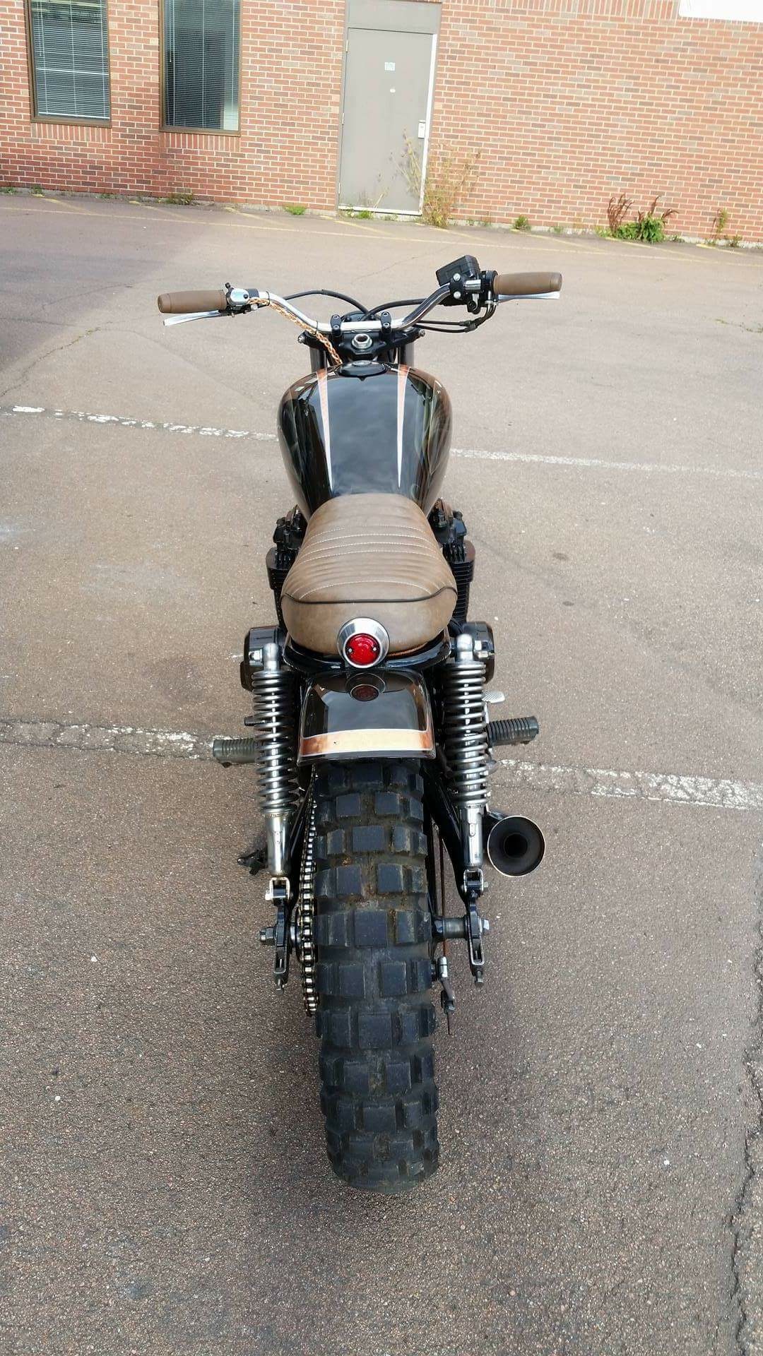

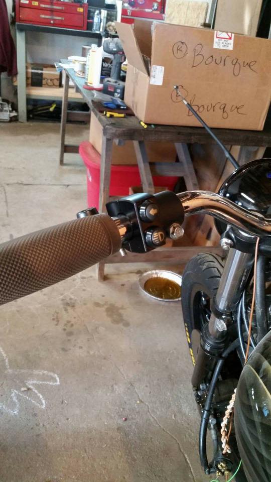

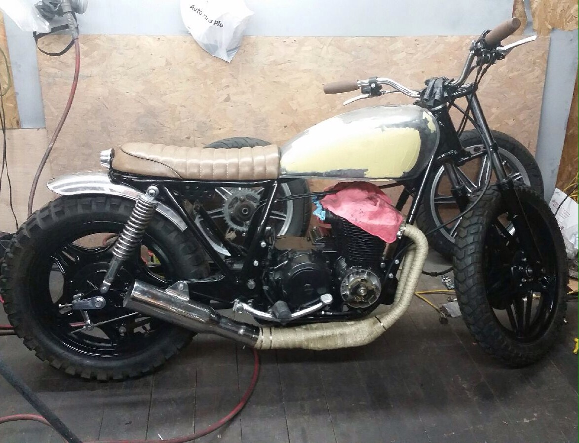

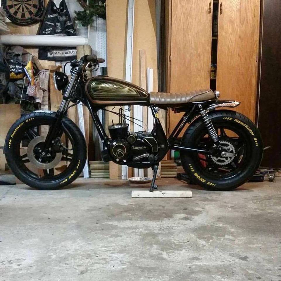

Here's my latest build -'79 CB650 (tank is off an '81) Bought two years ago not running, ended up just being a matter of cleaning the carbs out properly and fired right up. After that I Stripped the bike and altered the frame a bit to accept the new tank and eBay seat, made sure I could tuck most of the electronics out of the way, built a battery box, painted pretty much everything that could be painted, rebuilt/rejetted the carbs and added the stacks, as well as rebuilt the forks, lowered them 1.5" and added knock off emulators. This winter I plan on adding 14" ikon rear shocks, GM HEI ignition conversion and a clutch that hopefully won't slip as well as tires that will stick to the road a little better. Thanks for looking. (Sorry the pics aren't in any sort of order. I'm horrible at build threads)

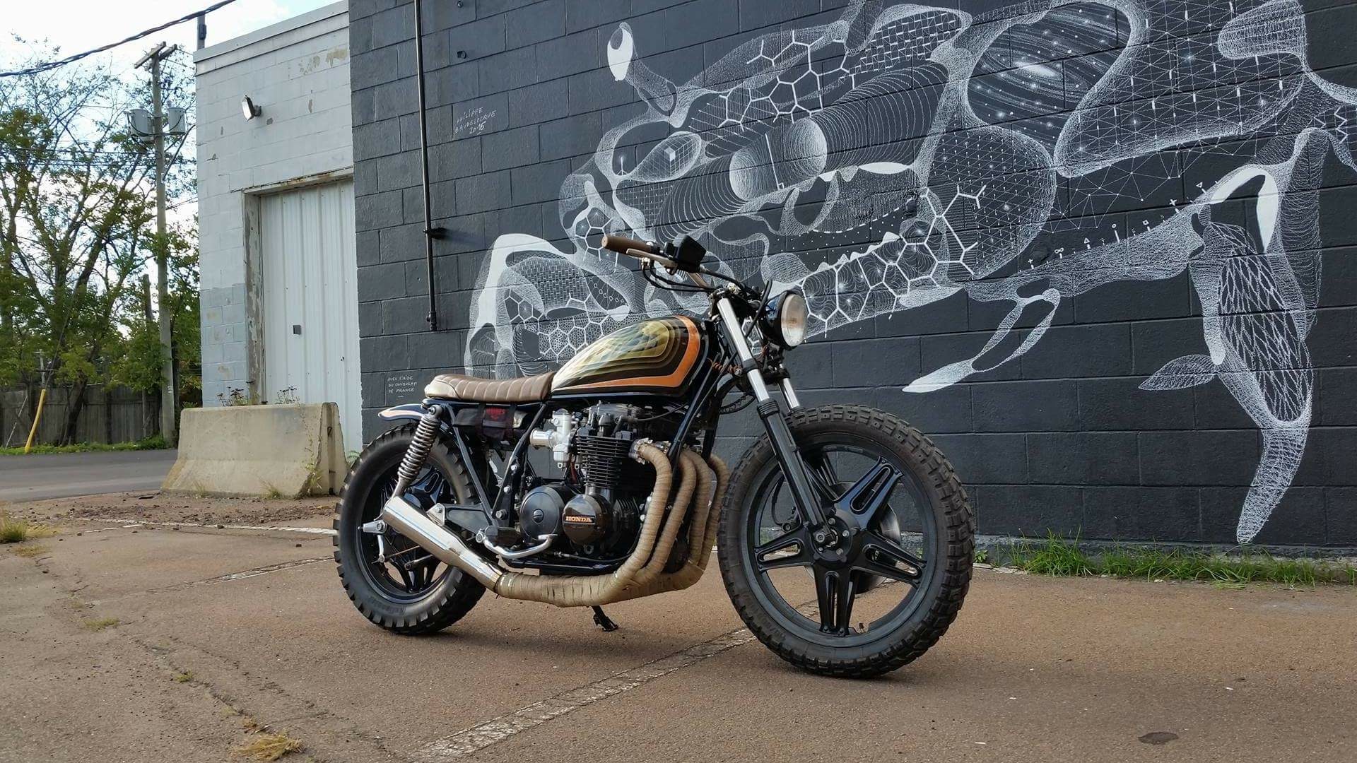

Here's version 2.0. This winter after testing compression and getting 60psi on 2 cylinders I decided to rebuild the engine and make some other improvements, it got:
Dynoman 10.5:1 cr 674 big bore kit, mike rieck stage 2 ported head with 550 valvetrain/kibblewhite springs (so I can throw a monster cb550 cam/hardweld rockers in this winter) gm hei ignition modules powering dyna .5 ohm coils, motogadget m-unit, turn signals, hagon 2810 shocks, tires that stick to the road, cone engineering muffler and a better quality seat upholstered locally (made the pan myself from fiberglass) amongst other things
