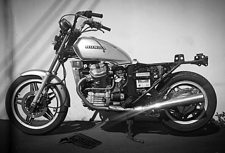

Looks so much better without that extra junk. I'm seeing potential!

Cool project.  I had never seen a silver wing frame before, looks like it is much nicer/better suited to custom builds than the more popular cx500.  Rock on!

Exactly what I was thinking, I wasn't expecting it to be so flat. Looks good.

Thanks man. Yup, flatter than an Illinois cornfield.
