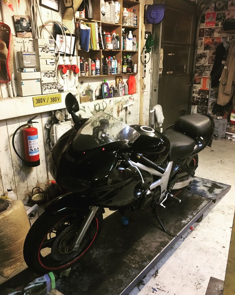

Here is the bike:

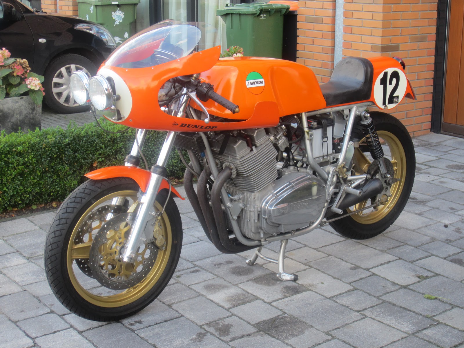

Here's my inspiration:
