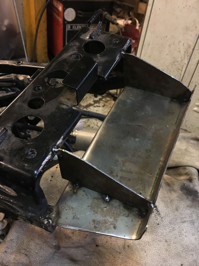

All the electrical components where distributed on the subframe so I'll have to make new mounts and extend some wires to make them all fit in the seat hump.
First, the battery tray tacked on

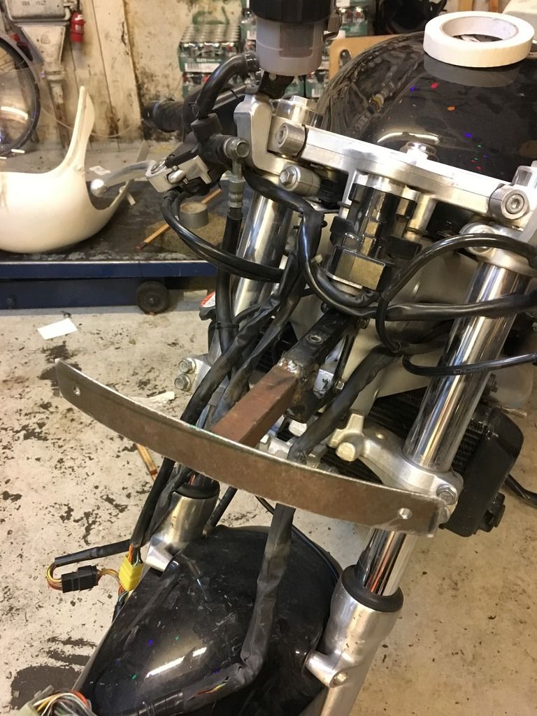

New mount in the making

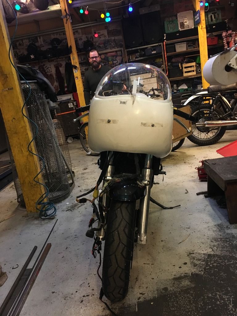

Test fitting on the frame
And after three rounds of measuring, I drilled holes and fitted the fairing on the front mount - happy times so far!  8)

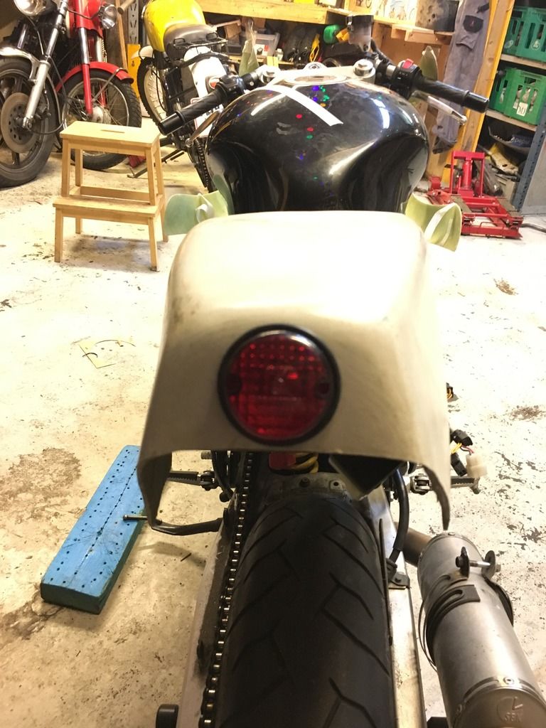

The tail light got installed as well. I decided to make the hole a bit smaller and insert the whole unit from the inside so the red lens wouldn't protrude all the way. I used a rubber O-ring as a black trim around the lens, I am pretty happy with the outcome  :D  I now need to make a bracket to hold the light form the inside...
Next up are more fasteners for the fairing and seat plus a bit of a puzzle with the electrical stuff...
