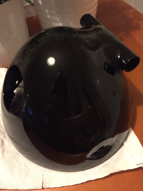

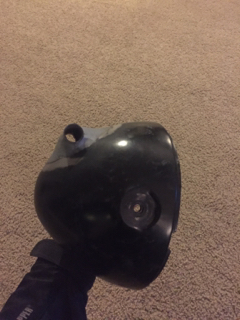

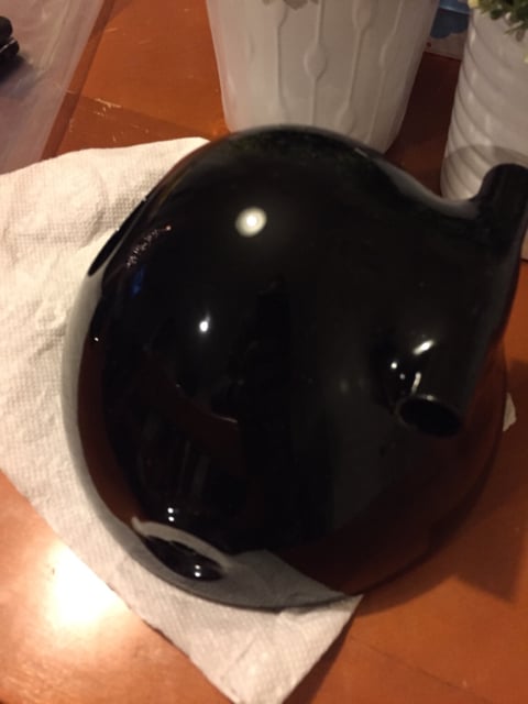

Here is the step by step progress on my headlight bucket. I welded that tubing to the back of the bucket so that it will mount up to the stock bracket. I used quick steel (JB stick) to shape it. I smoothed jt out with glazing putty, and then epoxied it.

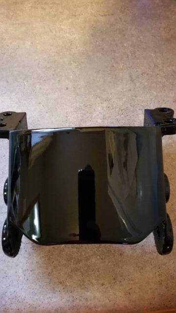

« Reply #6 on: Nov 27, 2016, 18:50:40 »
Good job!
Just let it sit for a long time, it won't be fully cured for days or even a week or more depending on temperature.
I just baked this yesterday, about 5 minutes after spraying a heavy coat.

That cover looks great too. What did you use for the letters?
Offline verboten1
  • Posts: 359
  • Der konig
Re: Baking Appliance Epoxy
« Reply #8 on: Nov 27, 2016, 22:46:43 »
Thanks, I just used a toothpick and a little bit of the engine enamel.

Here's how it's looking after curing for a couple of weeks.
I also had the bracket powder coated:
