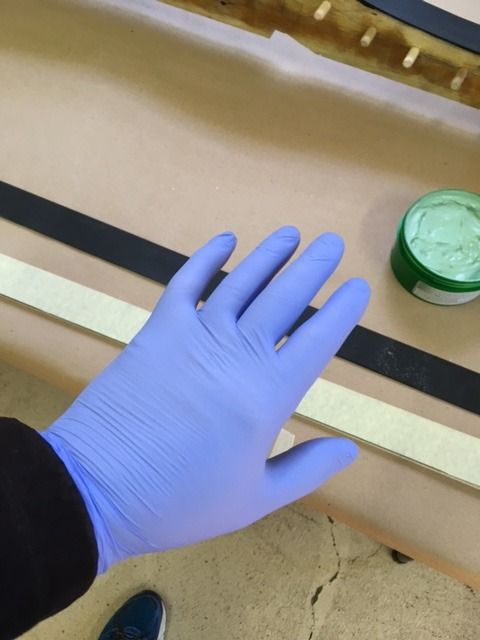

Then I got the wood and fibreglass strips cut, cleaned, and high temp tape on the shiny side of the fibreglass, which means that I also need to wear rubber gloves from this point forward to keep everything clean
