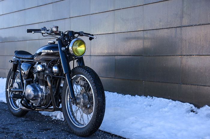

For long-term plans, I'd like to turn it into a brat style bike. I really like the more upright posture compared to the low handlebars of a traditional cafe racer, and building it like these bikes would allow me to have a passenger if I ever needed to. Here's a couple of inspiration images that are similar to what I'd like to build.

I made the exhaust on the bottom bike. Let me know if you're interested in one.
  Mark Kouri
  www.MerlinCycleworks.com
Sent from my Pixel 3 XL using Tapatalk
Awesome, I'll keep you in mind. Right now it has the original 2-into-2 exhaust but I definitely want to put a 2-into-1 exhaust on it someday to try to get a little exhaust scavenging.
