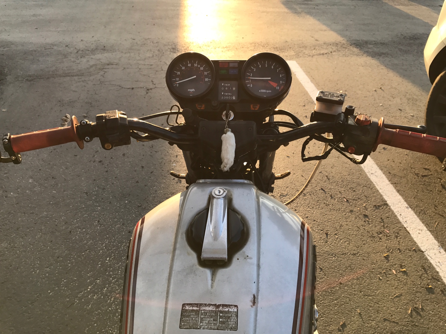

« Reply #5 on: Apr 15, 2017, 23:36:25 »
Offline 88SS
  • Posts: 94
Re: Good report, but where to begin...
« Reply #6 on: Apr 15, 2017, 23:38:18 »
These were taken when I first got the bike. I'll get some fresh ones next weekend. I would love to get a Corbin seat for it
