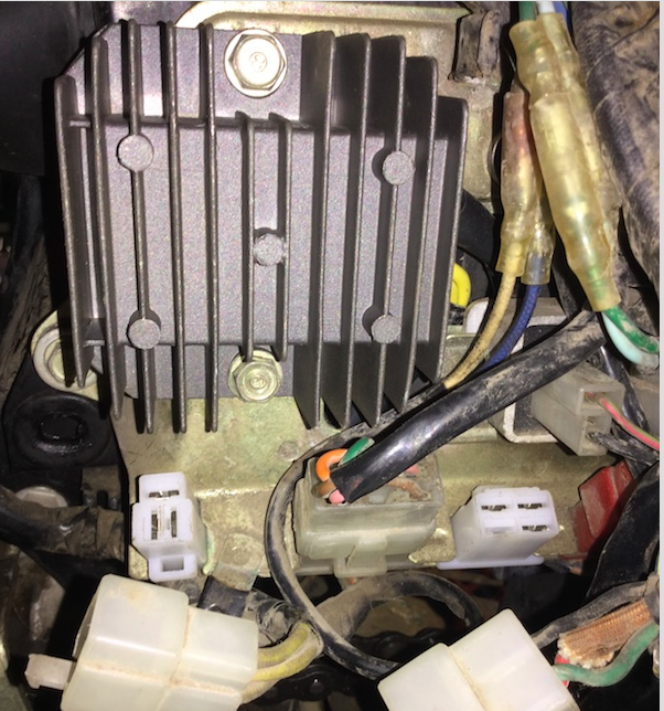

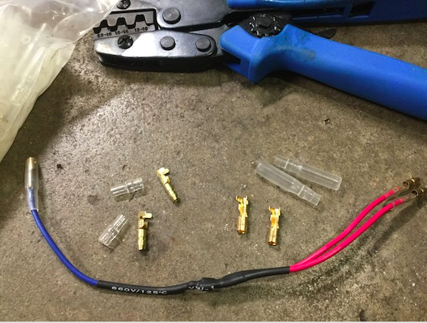

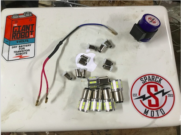

Got the sparckmoto.com R/R on FRIDAY!  Thanks Matt.
I had to swap the red and black wires inside the connector.  Other than that perfect fit.   8)
Tamed the high voltage issues.

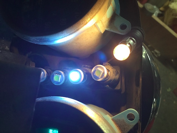

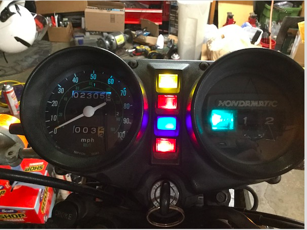

The (other goodies). I guess it pays to be a loyal sparckmoto customer these past years.  This is my 3rd machine using Matts stuff.

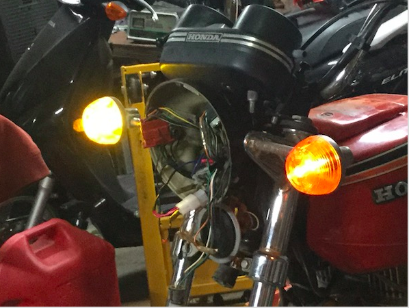

Comparing LEDs to old dash bulb.
Ererything working great.
The LED turns and tail light = AWESOME!  Atleast 50% brighter than bulbs.

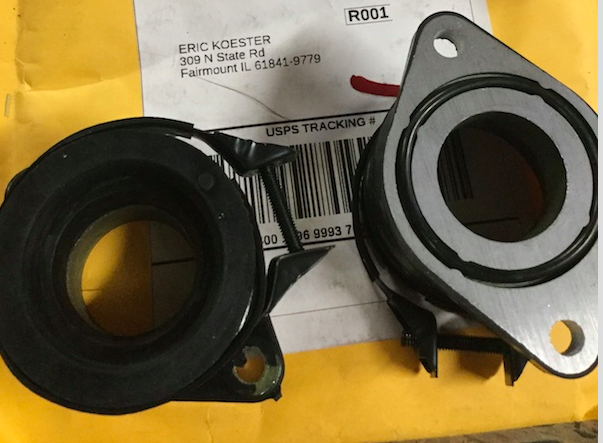

My buddy Ron soldered the cracked overflow tube.  99% its gonna work out.  Holding gas sitting on patio.
I will install it for fun and keep the other on the standby shelf.
New insulators are no longer "unobtainable"   :)
