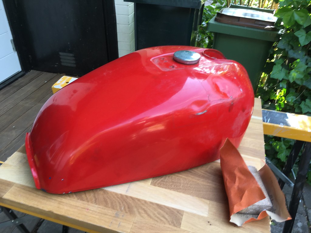

- Got a tank from a a different model 550 (E?). It's got a couple of dents, but I got it cheap and it looks good internally. With a bit of modification of the front frame mounts it now fits perfectly.

Dented 550 tank
Sanding...

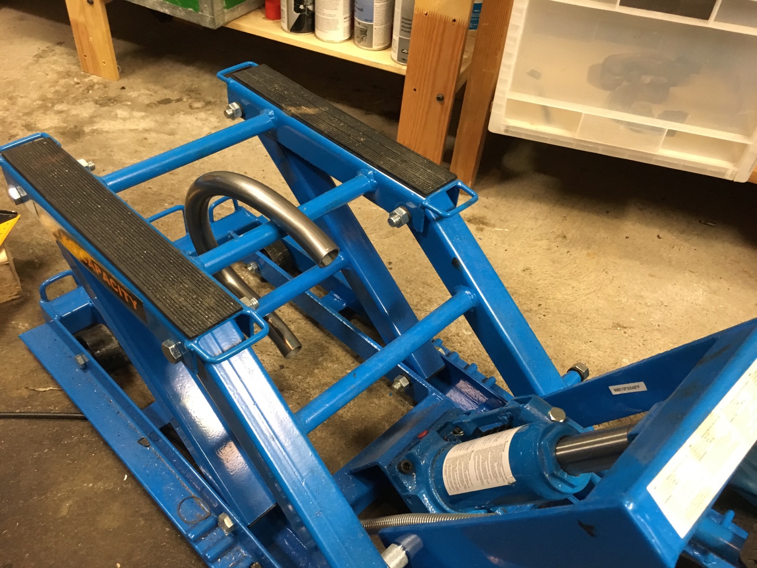

DIY metal bender and projectile weapon, formerly a bike lift, sorted out the issue though.

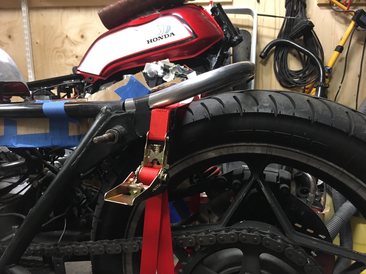

...and did a ratchet strap clearance test in the back. Looks like I'll be good, and I'll probably go with a bit taller shocks too.
Thank god you checked the clearance with the straps, was worried this was another jwilde. At first glance it was pretty iffy looking, looks great so far though

Thanks! I'll do one more check with the straps when I have the hoop tacked in final position.

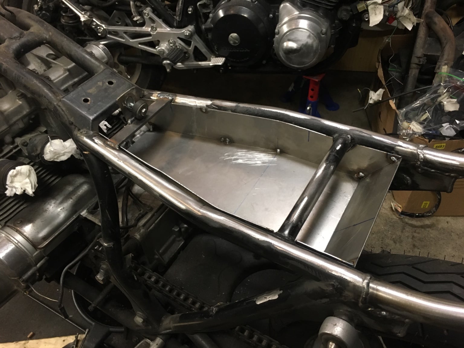

Bit of progress, got the hoop in place and welded up a battery/electrics tray.

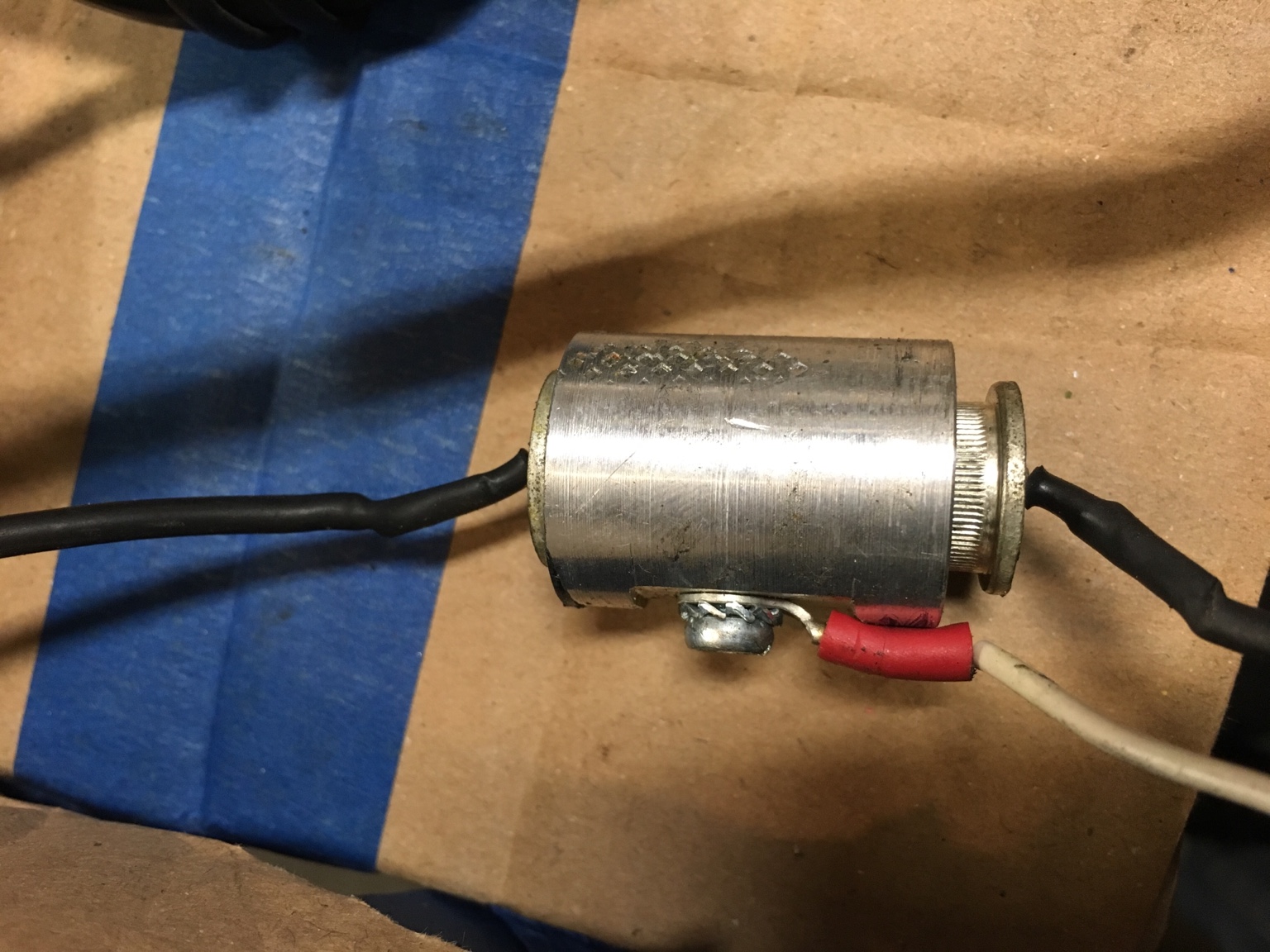

Electrics on the bike was working but there were some funky balls of electrical tape and a couple of semi-charred connectors so I will be redoing the harness. Also found one mystery component that does not look stock. Looks like a pretty big capacitor? Anyone with ideas what this might be doing there?
Next up is mounts for the seat, and then weld everything in final placement so the frame mods are done. Waiting on my ignition too, which will be moved to the box under the seat.

Connector to the mystery capacitor is an it charred...

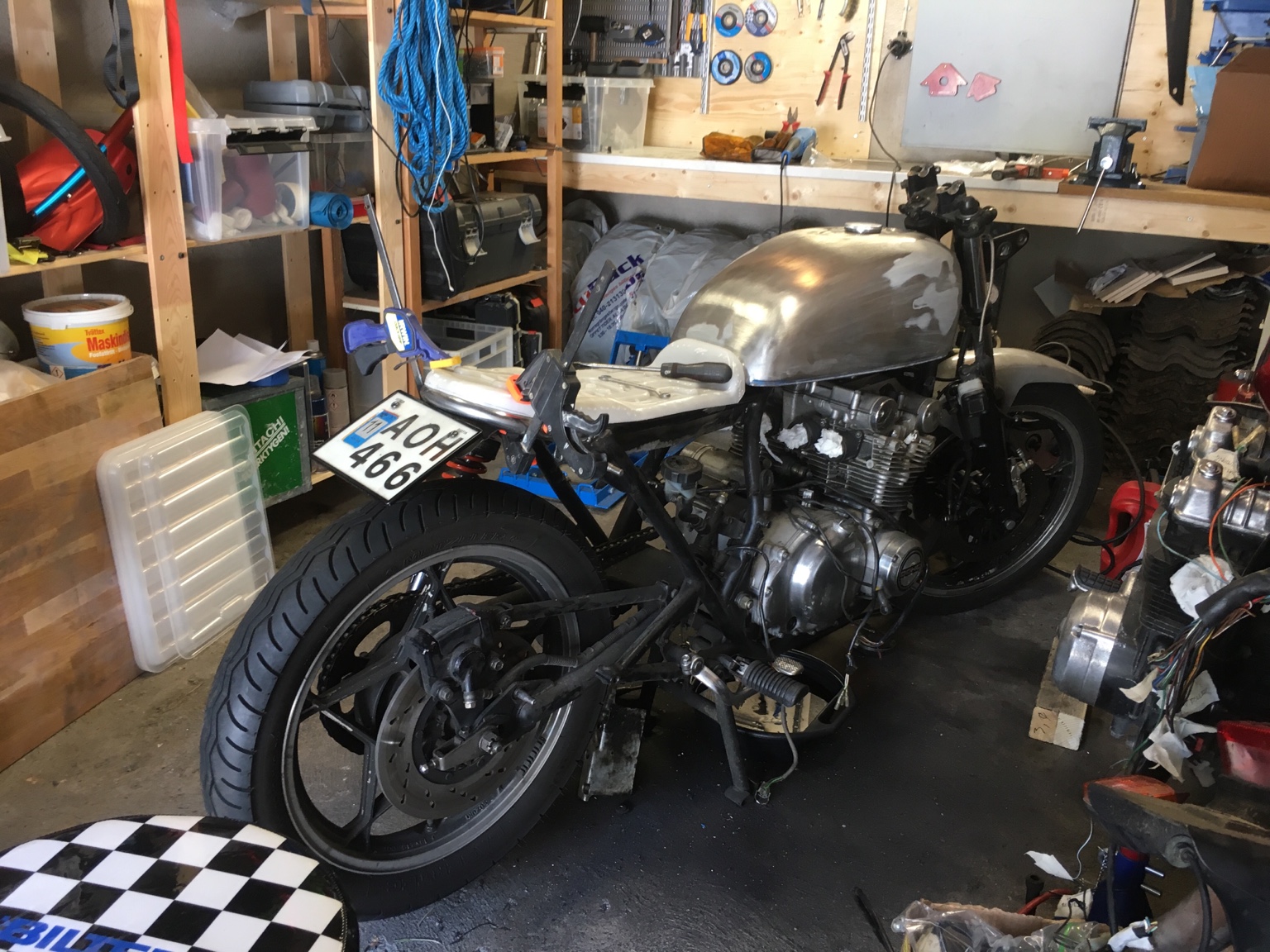

Work on the frame mods is moving along, seat mount in place.
Also played around with using the stock inner fender and plate mount.

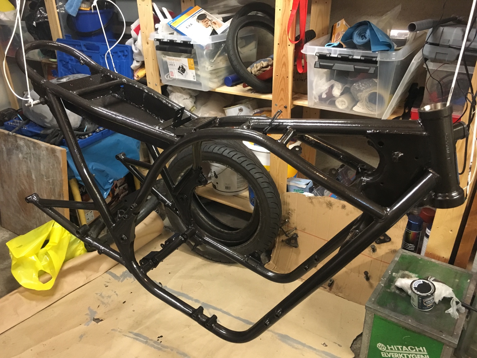

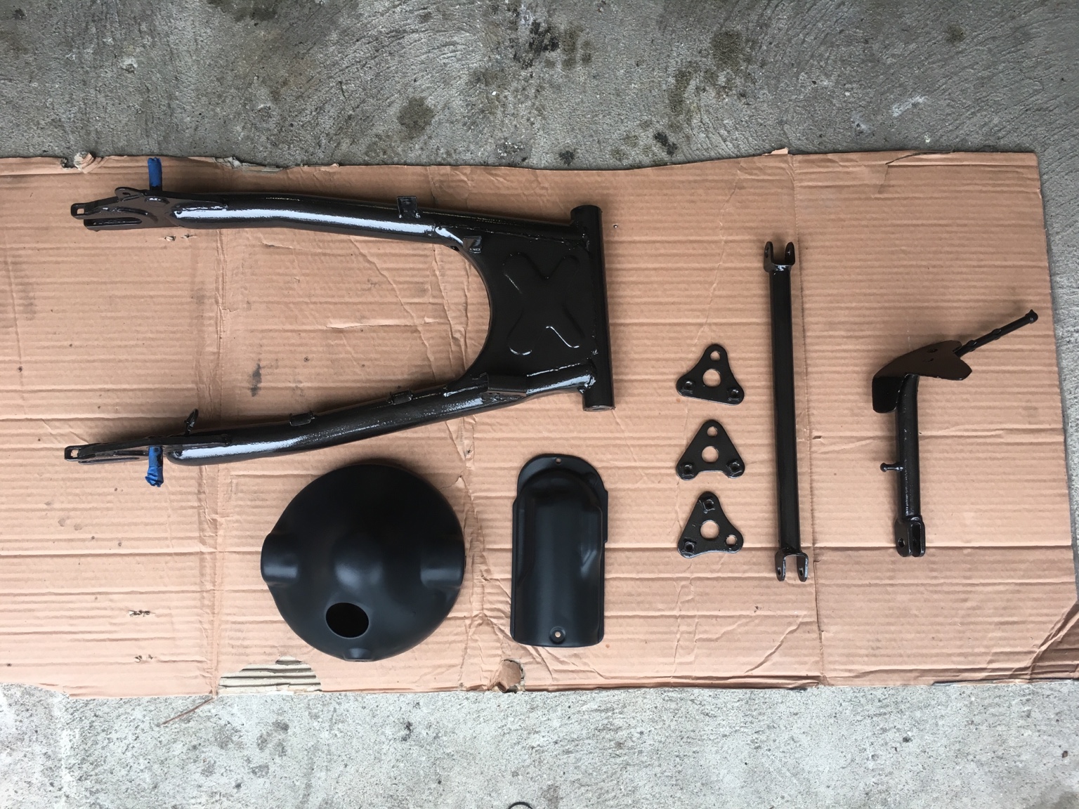

Frame, wheels and top triple (trimmed off risers) have gotten a coat of paint.

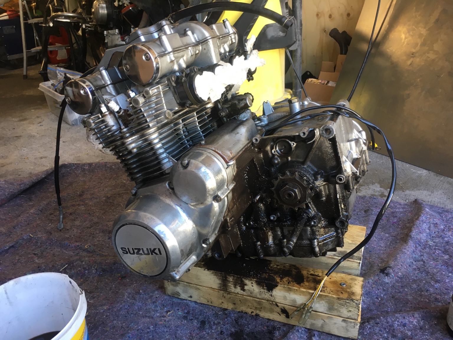

Won't be tearing into the motor more than necessary, but figured it'd be a good time to do valve adjustment while it was out of the frame. Lots of gunky gaskets to clean up, I'd guess it was a while since it was apart... Both intake and exhaust were definitely on the tight side. New shims ordered so will have to wait for them before finishing up the task.
Generator cover gasket will also need to be replaced...

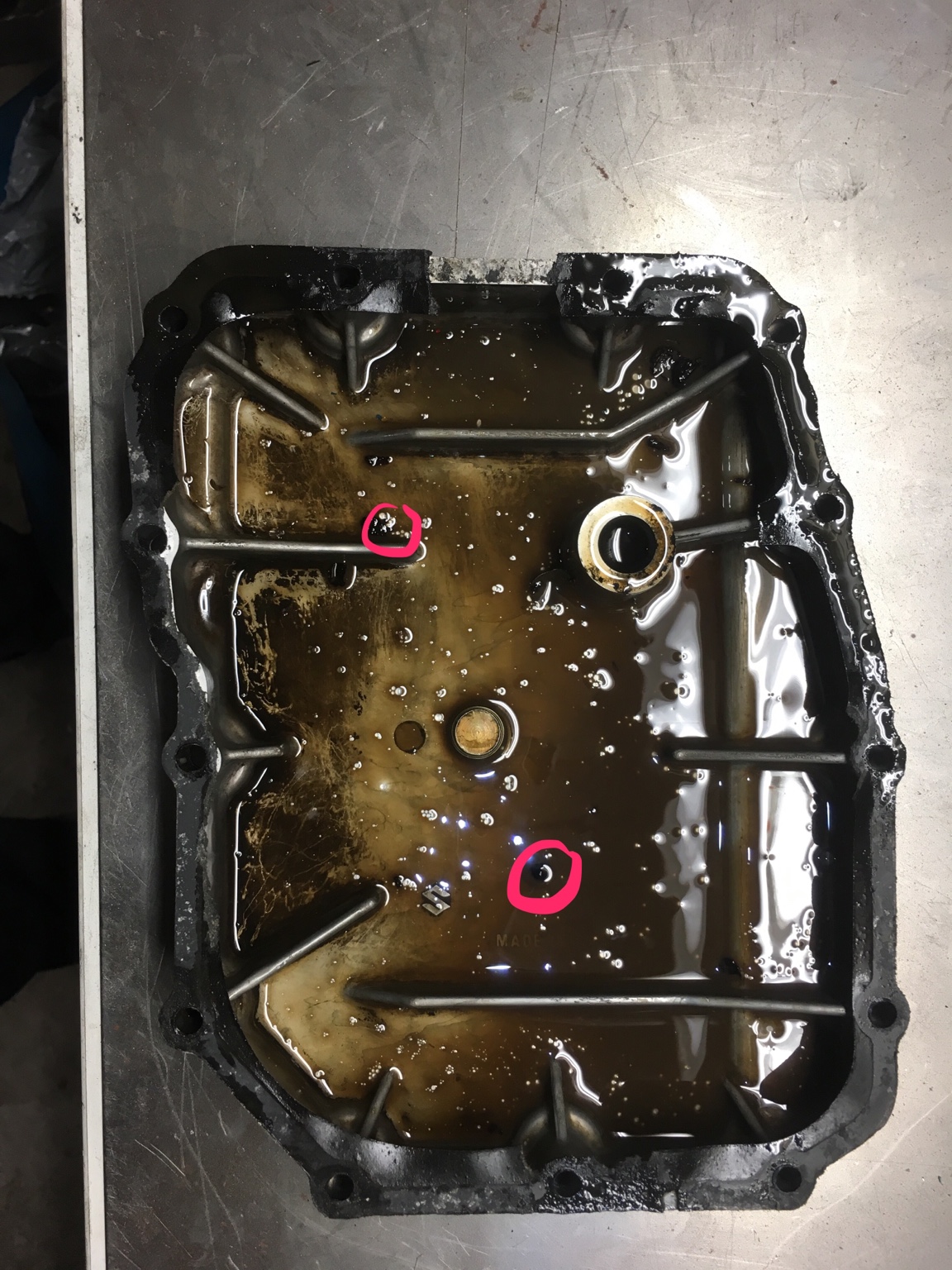

Also dropped the sump to see if there were any nasty surprises hiding. A few small bits of what seems like charred plastic (really brittle). Came off chain guide perhaps? Unless someone says otherwise I won't be tearing the engine apart for that :)
(Bright spots in the pic are air bubbles)

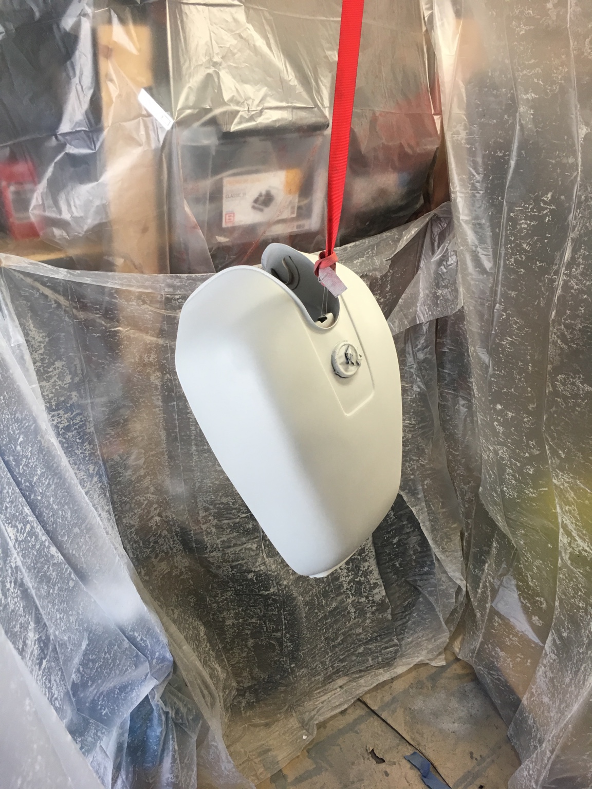

And set up a little paint booth for the tank, which has been primed.

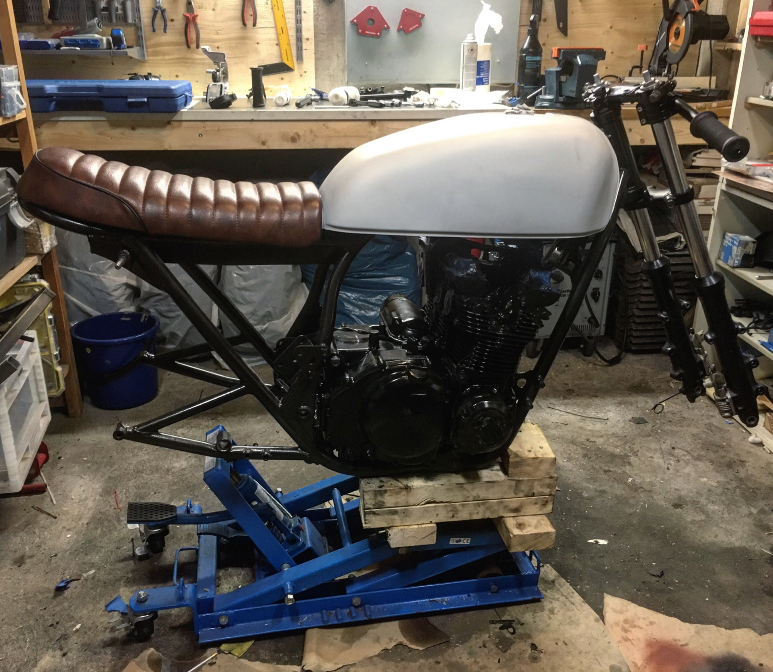

It’s been a long, cold winter and not much has happened... but now there’s some progress.

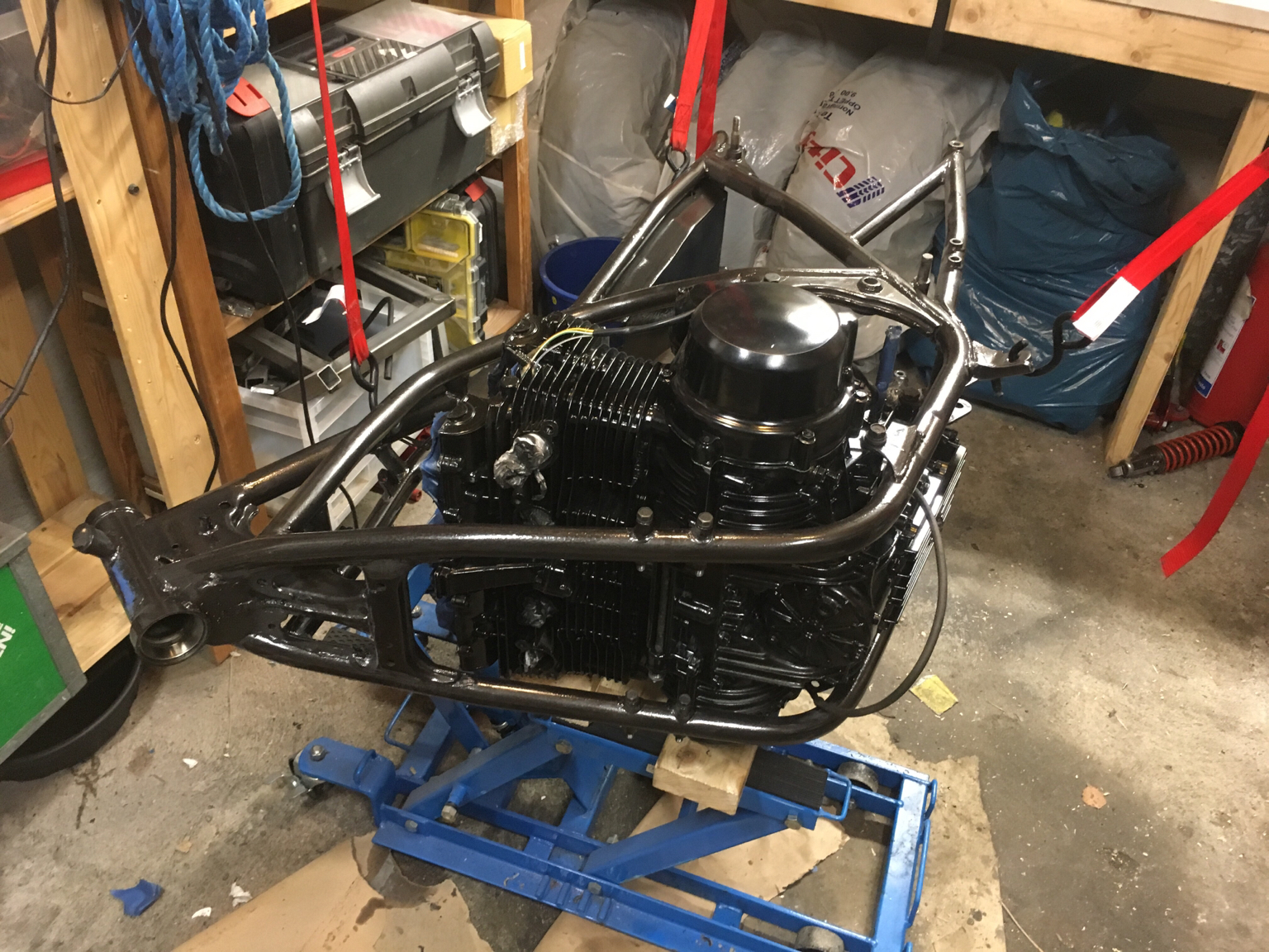

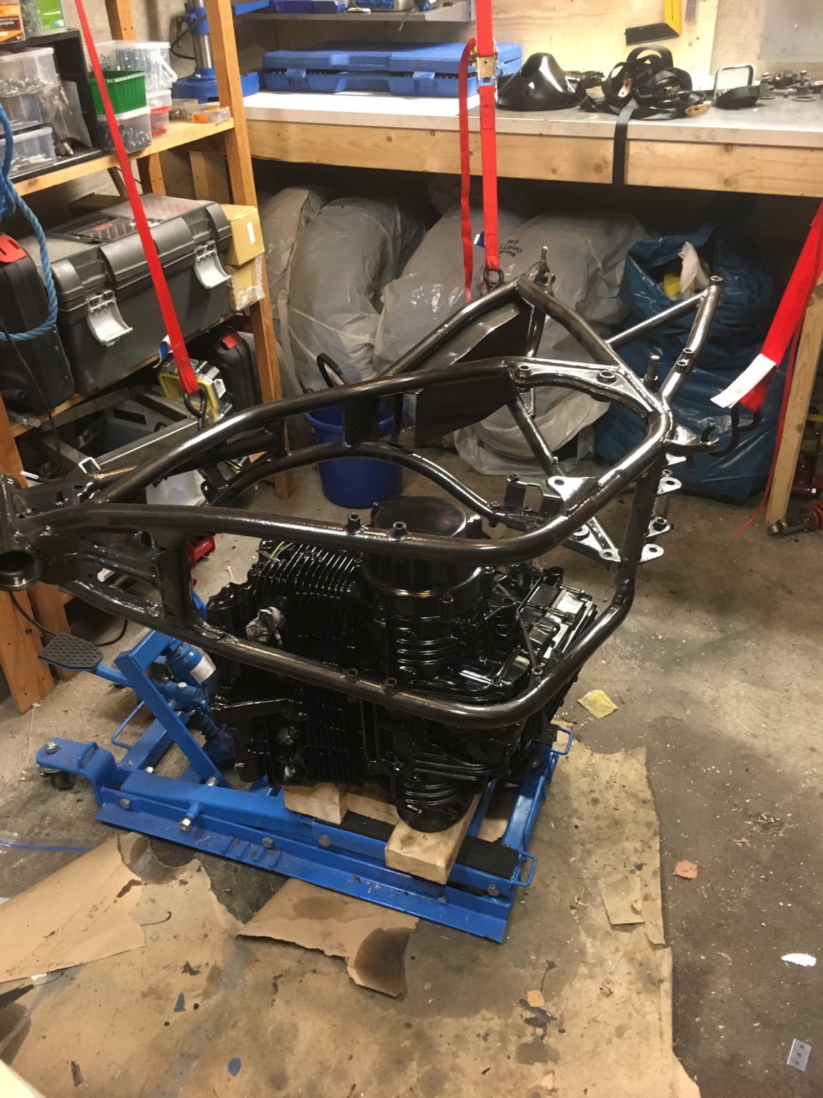

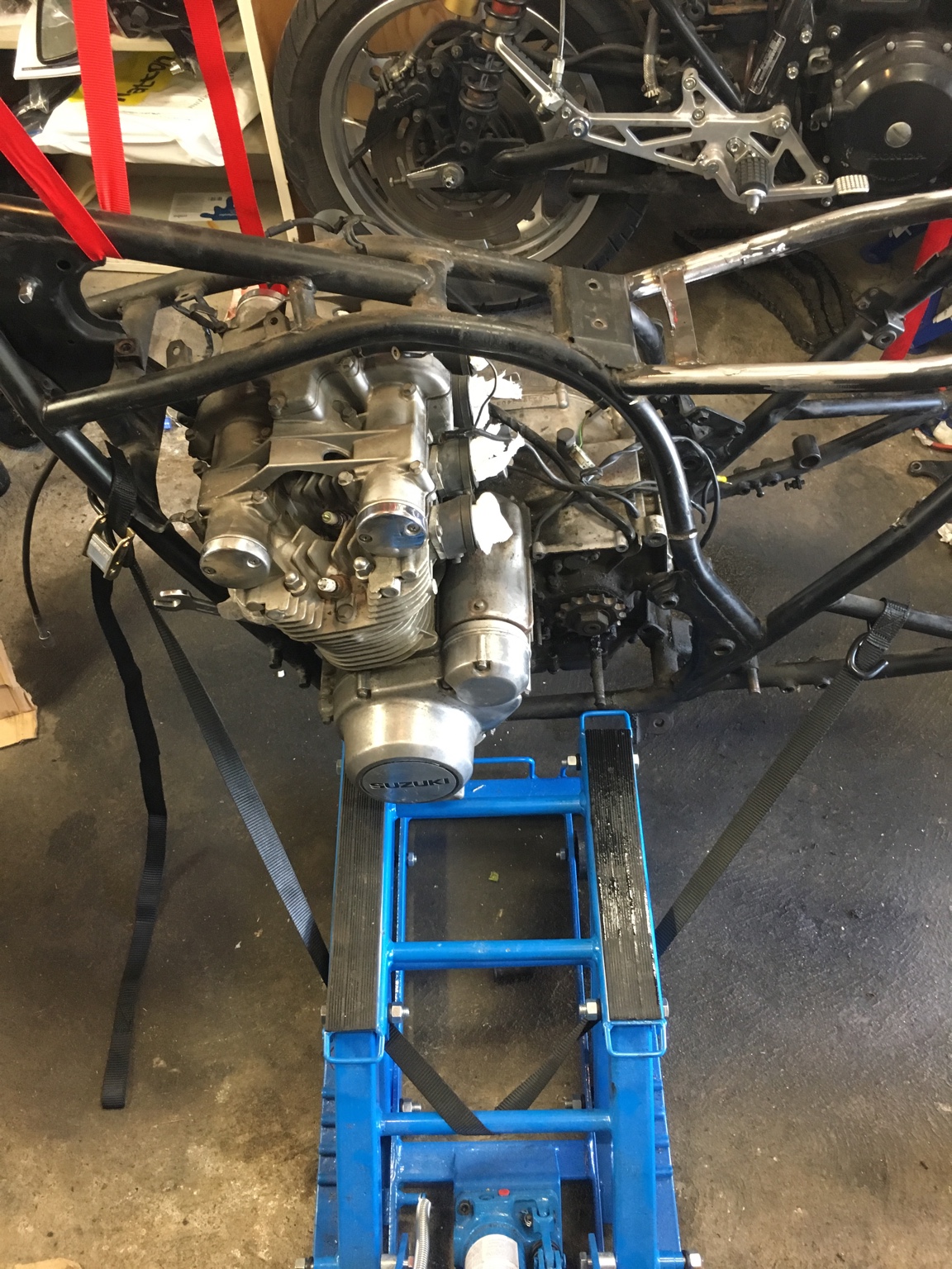

Came up with what I thought was a pretty innovative take on the old put-engine-on-the-ground method of installing the engine in frame. I suspended the frame sideways and then jacked up the engine into it. Nice and controlled, no lifting and minimal risk of scratching paint on either frame or engine.

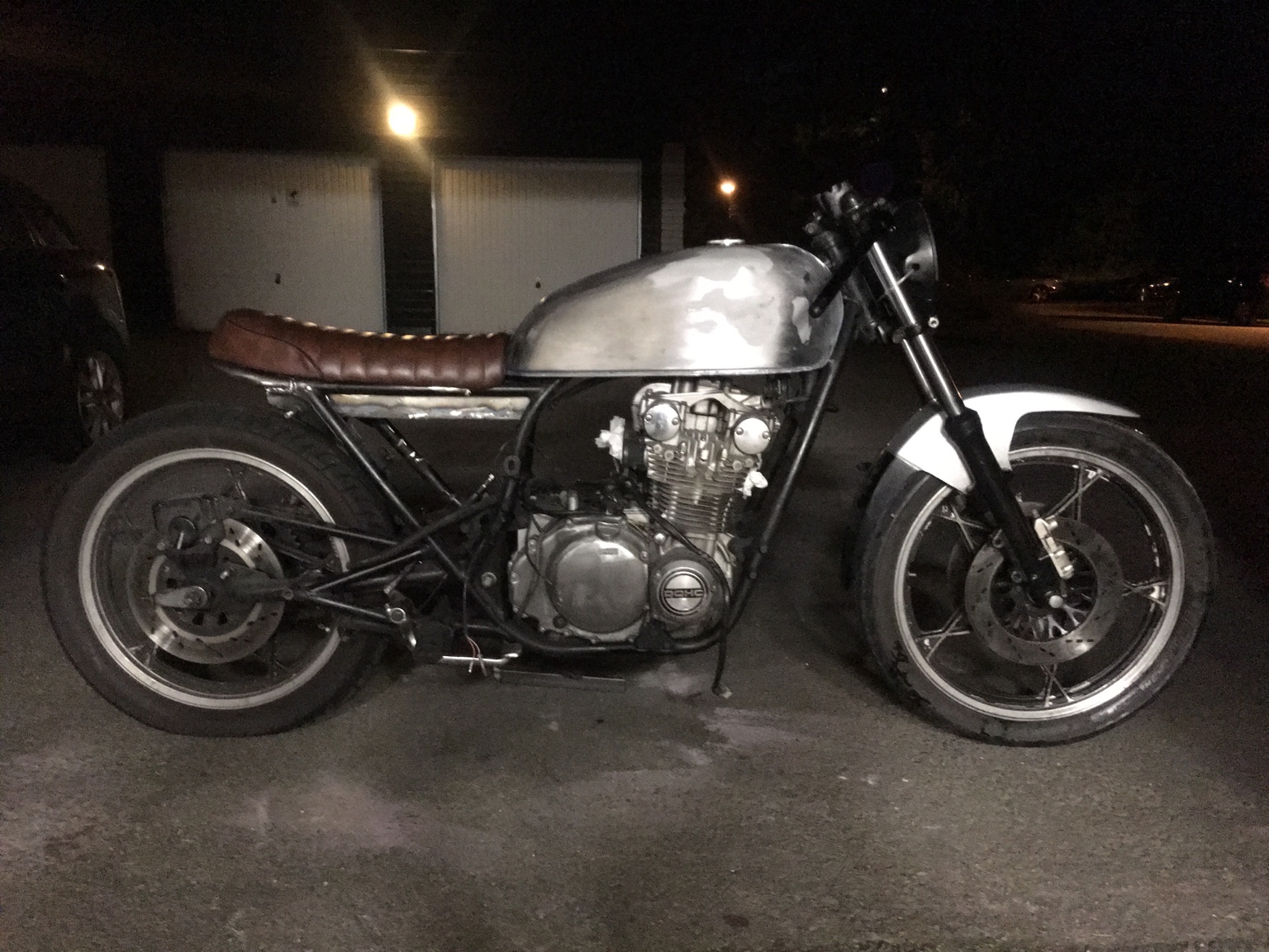

Threw on the tank (primer only), seat and forks just for inspiration :)

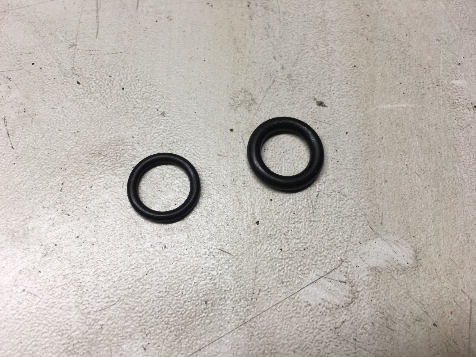

Had my first go at mounting tires. Getting them on took quite a bit of patience, soapy water and sweat but went without drama. When I was gonna pop the bead I noticed my new angled valves were leaking and I couldn’t get the bead to pop either. Gonna have to see if I fudged the installation of them somehow...

Sorted the valve problem with a bigger o-ring that fit much better so that’s a win.
