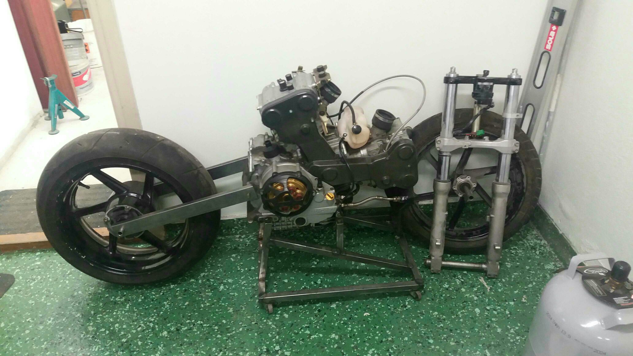

Found a really cheep Ducati S4R monster engine and some parts. So thought I build my self a Cafe racer. Something light and fun to zip to and from work.

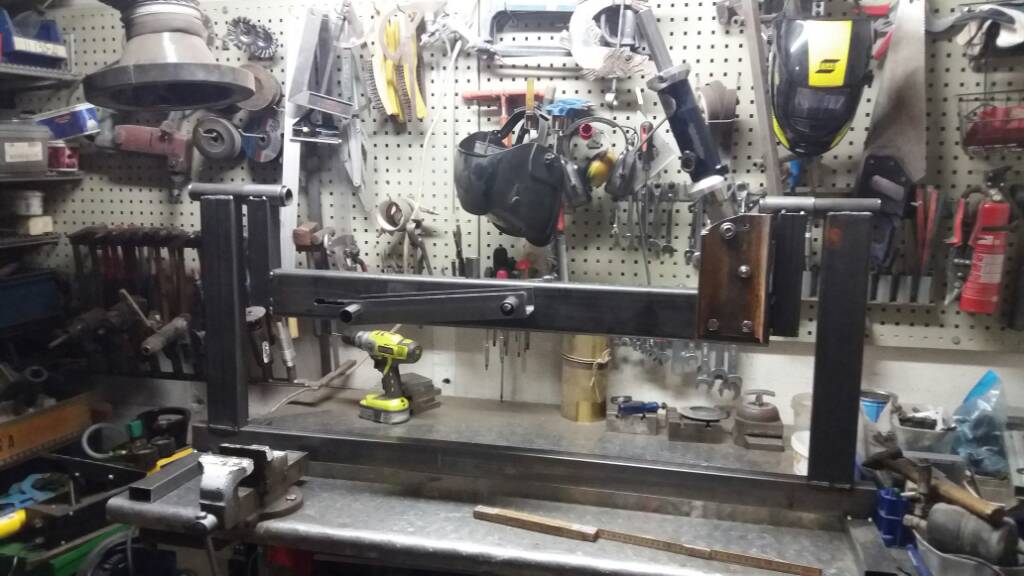

I'm currently working on the frame jig.
Parts I got so far.
Duc S4R engine
Honda cbr 600 front and rear wheel.
Suzuki gsx 600r RSU fork.
Frame is going to be a light weight in CrMo made by me.
Fuel tank is going to be imola style aluminium tank made by me.
Swing don't know right now. I'll see what I can find and modify. I want dual shocks at the rear.

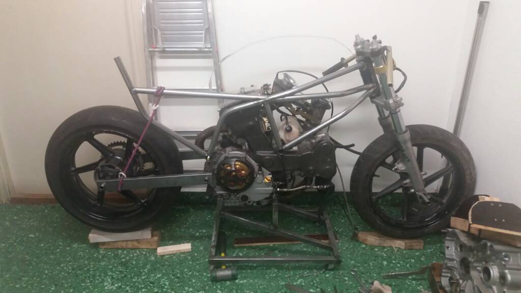

I had a bimota db2sr. I regret selling it. But I made drawings of the frame. And I made fiberglass molds so maybe another time.
No this frame will be narrower than a Ducati frame.

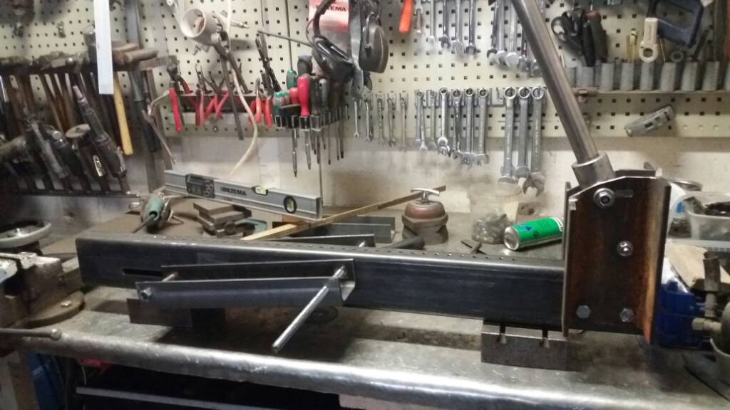

Did some more on the jig. Drilled and taped 36 holes. Did some curved milling for locking the steering head angel. I can adjust it between 0 and 30 degree. More than necessary.

that looks a bit like an ss/sc frame.  you won't have any access to the vertical head with a frame like that.  unless you want to drop the engine to service it, you'll need to go around the vertical cylinder, not over it.
