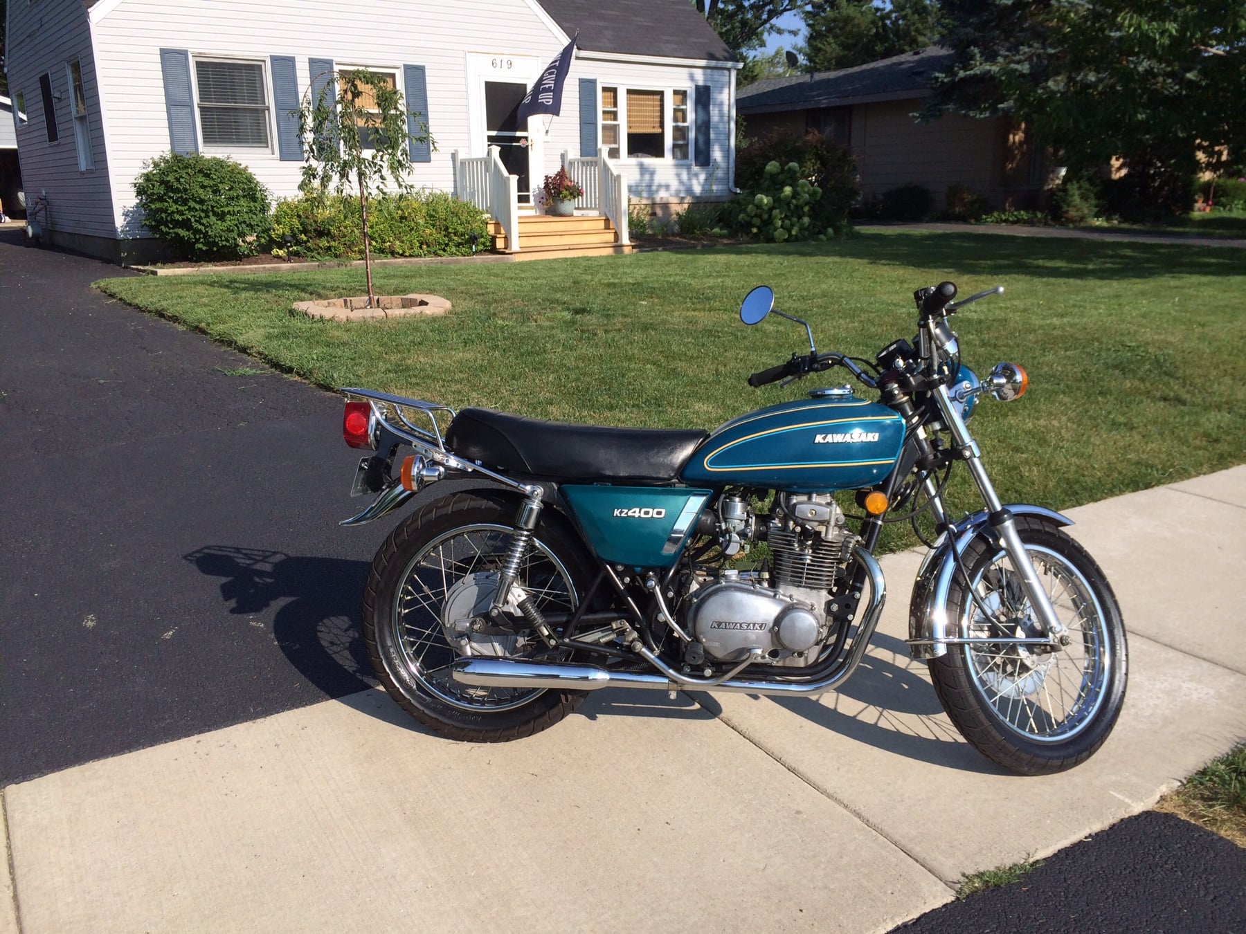

I've been meaning to do a build thread for a while even though the bike is basically done by now. So I'm just gunna start this damn thing and take it one step at a time. It may not be chronological, it may not even be logical but I think it's worth sharing because I learned a shot load and I think I've got some good info to share about things I've seen other people struggle with.
So here's the story. Bought the bike in 2012 from a nice man while I was living in Fort Wayne, Indiana. Craigslist find, 9000miles, wasn't running, cost....$400. 1976 KZ400-D3. The thing that drew me to this bike was the condition of the metal. No corrosion anywhere, perfect chrome. It might have seen some sun from the faded paint, but it looked like it rarely saw rain.
First pic of many. Rolling it into my then apartment to get it running.

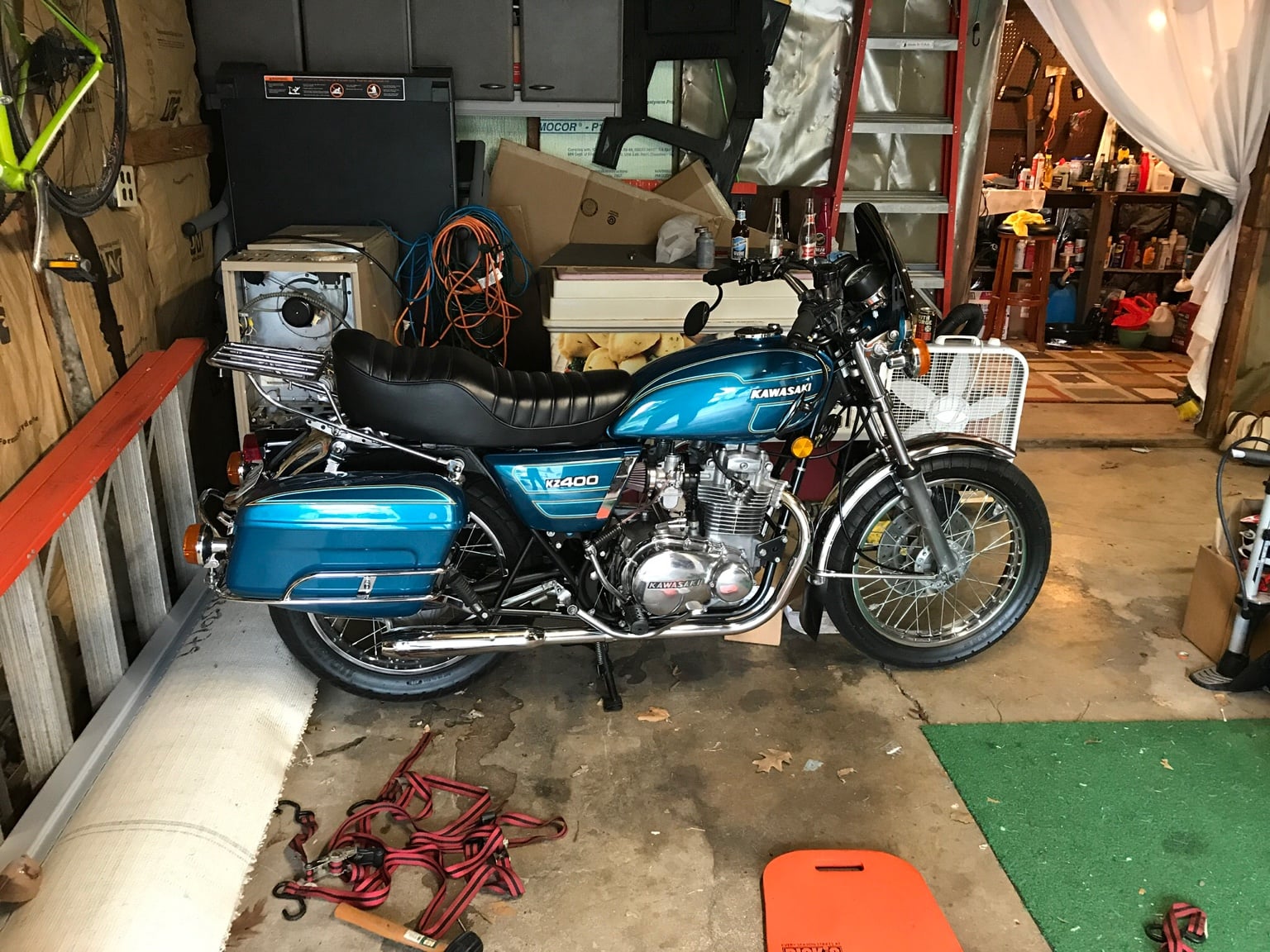

And here's a tease of how things look about 5 years later.

I love the ol' hardbag setup for these.   I'd love to find a set for my 400.

« Reply #9 on: Feb 28, 2018, 15:11:55 »
I found mine on eBay, but Iíve seen parts bikes of the 77 KZ400 A1 (the one with the bags and fairing).
