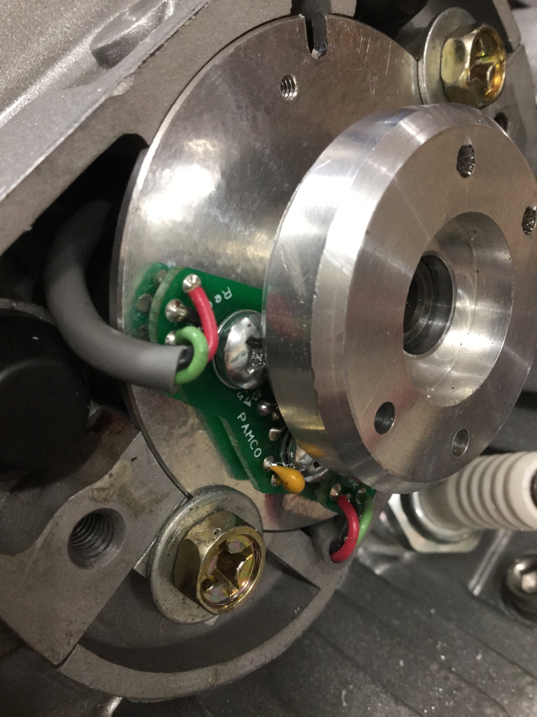

I'm setting up a Pamco electronic ignition for a cb360 and have run into an issue that I just can't seem to account for (with no luck searching DTT / elsewhere):
According to The instructions, the included rotor should be a direct-swap using the original hardware (just a bolt w/ washer into the threaded shaft).
With the "plate" (which replaces the points /w 2 circuit boards) seated properly, I have interference between the rotor and the screws that run through the circuit boards into the plate; the screws rub on the rotor.
The rotor is "keyed" to the shaft, so there's no room for a missing washer.
Can anyone shed some light on this?
...I did confirm that I ordered the correct (for a 360) Pamco ignition, but wonder if I was sent a rotor meant for a different application(?)

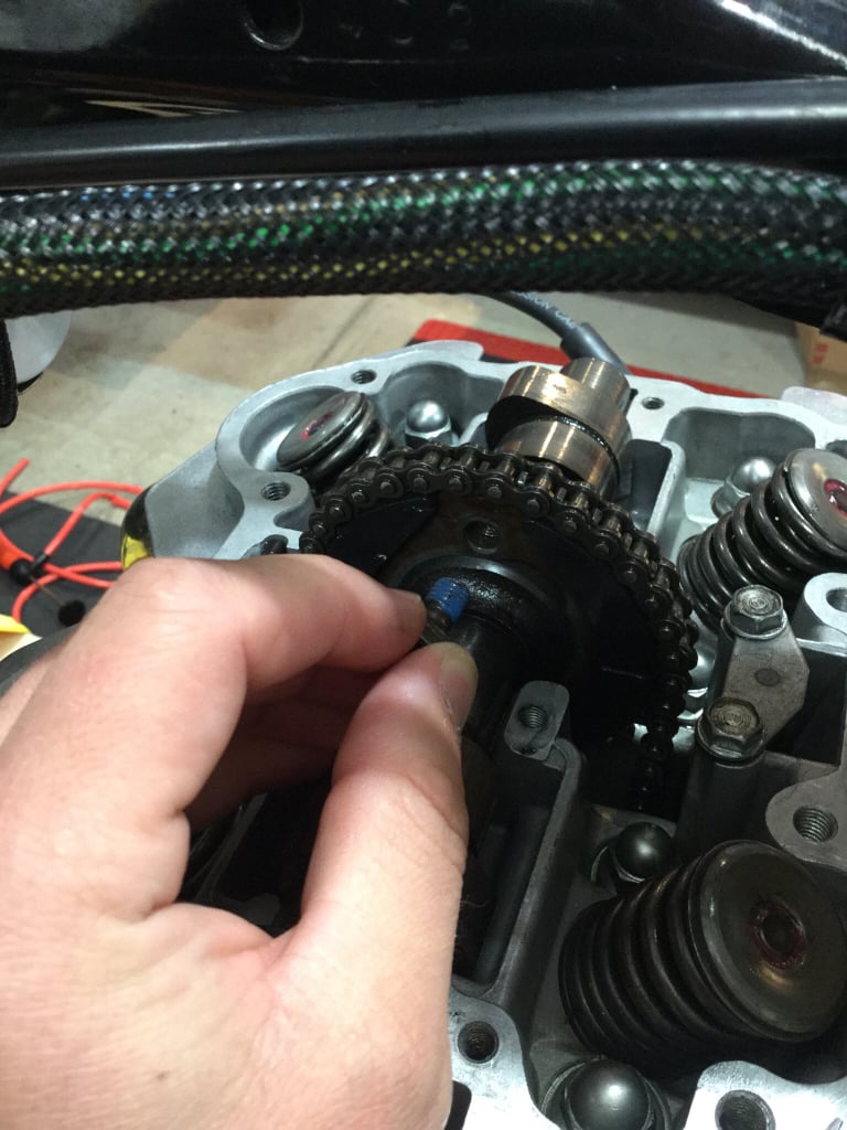

It is possible that the thrust washer to adjust side clearance on the camshaft was installed on the left (points side) of the engine.
this would move the end of the camshaft closer to the pick-up plate at least 1mm. You would have to pull off the rocker box to check.

I'm hesitant to start shaving the screw heads because the difference in clearance isn't minor and I assume the gap is relatively important.
Any idea what the gap between the rotor and screw-heads (which serve as a contact) should be?

I just posted a few minutes ago before seeing your response @turnturtle...
I think you may have hit the nail on the head. I'll refer back to the factory manual to be sure I understand before doing anything else.

Absolutely right @turnturtle.
This was a mistake on my part when completing the top end rebuild. I was so sure I hadn't missed anything...

Great catch indeed! I could have been chasing my tail on that for a while (or worse)...Thrust washer is now (correctly) installed.
I'll continue to update as I set the static timing/reassemble the rocker assembly/go through the process of setting up the ignition.
