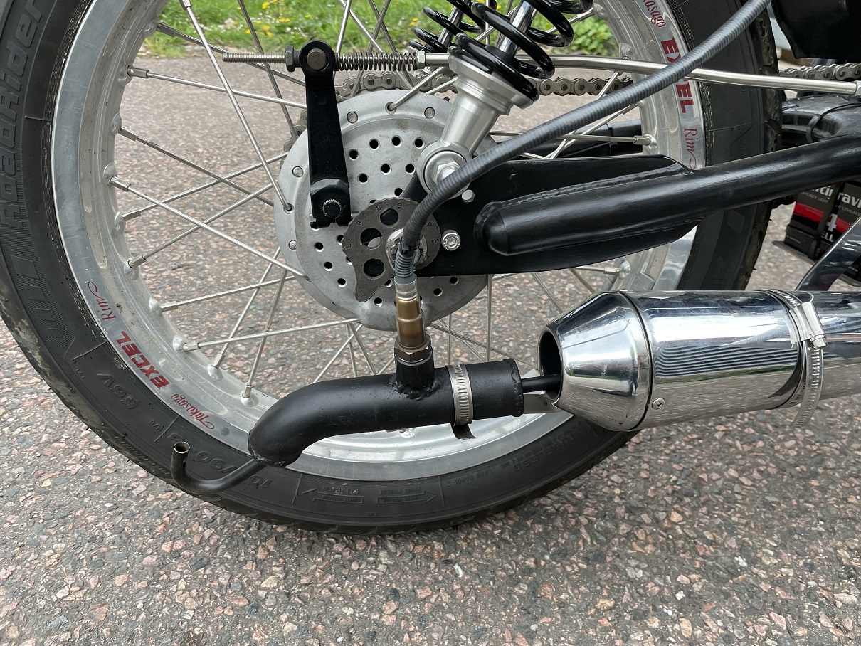

It may sound like a boring start, and it isn't where a lot of other people start but perhaps should...  Tyre choice.
For this lightweight racer I will matching tyres to rims first.  Then re-lacing them to the stock hubs with the Jadus 18" stainless spoke sets.
The tyre of choice is the Avon road rider, for many reasons.  It is tried and true, can handle the speed and handles really well - from both reviews and personal experience with one up front on the other Jadus SR.
http://www.avon-tyres.co.uk/motorcycle/roadrider
The size of choice will be a 90/90-18 up front and a 100/90-18 at the rear - will be plenty wide enough for this kind of power and will keep things light (always good with less rotating mass).
This means that rim choice will be aluminium for light weight and a size 2.15"-18 rim for the front, 2.50"-18 for the rear.  Here are some guides I used:
https://ridewrightwheels.com/pages/motorcycle-tire-wheel-fitment-chart
https://www.scribd.com/doc/253007466/Motorcycle-Rim-Width-Tire-Size-Chart
http://dropbears.com/motorcycles/utilities/tyrerim.htm
So next pay check, wheels will be the first purchase.
