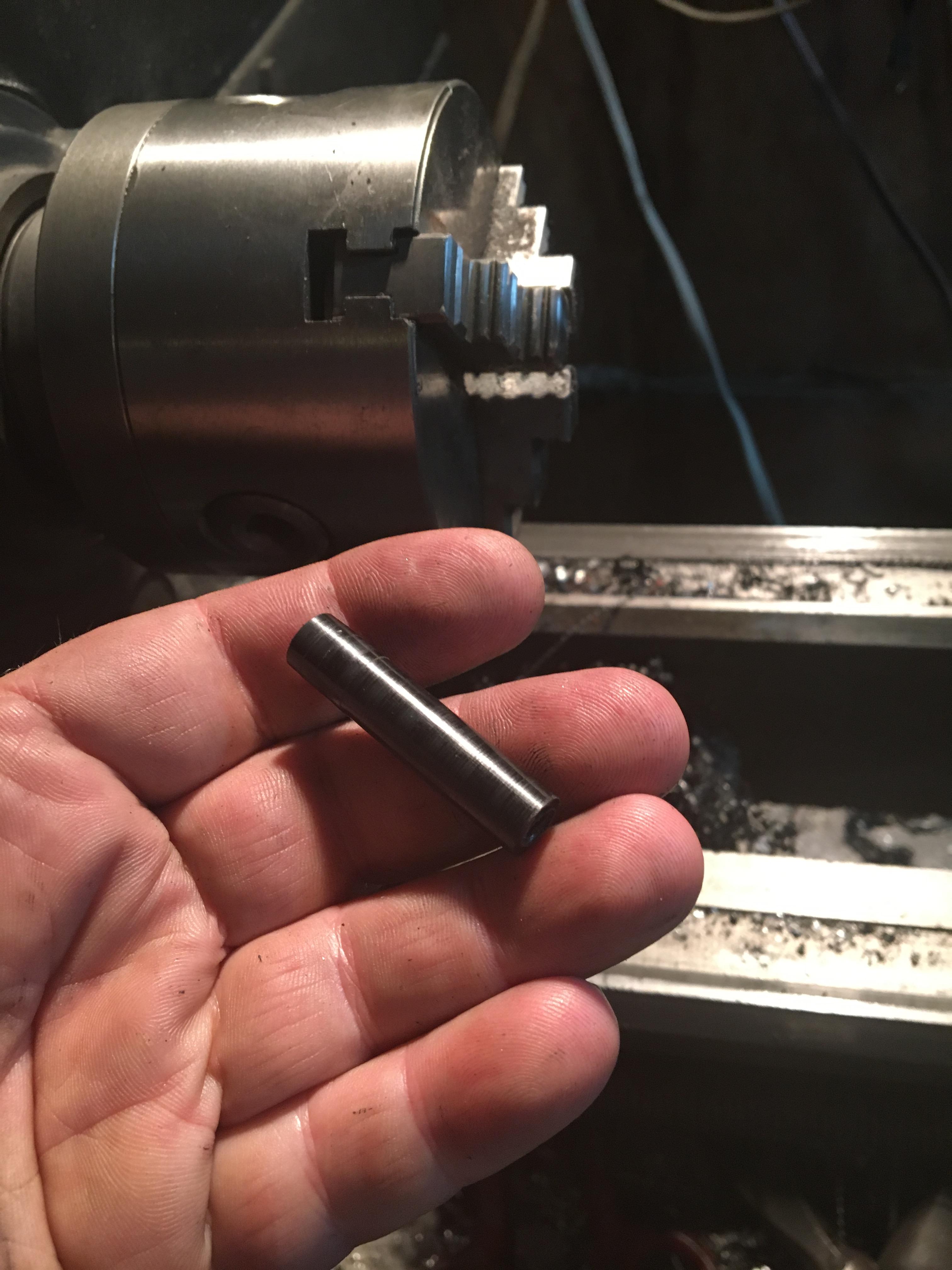

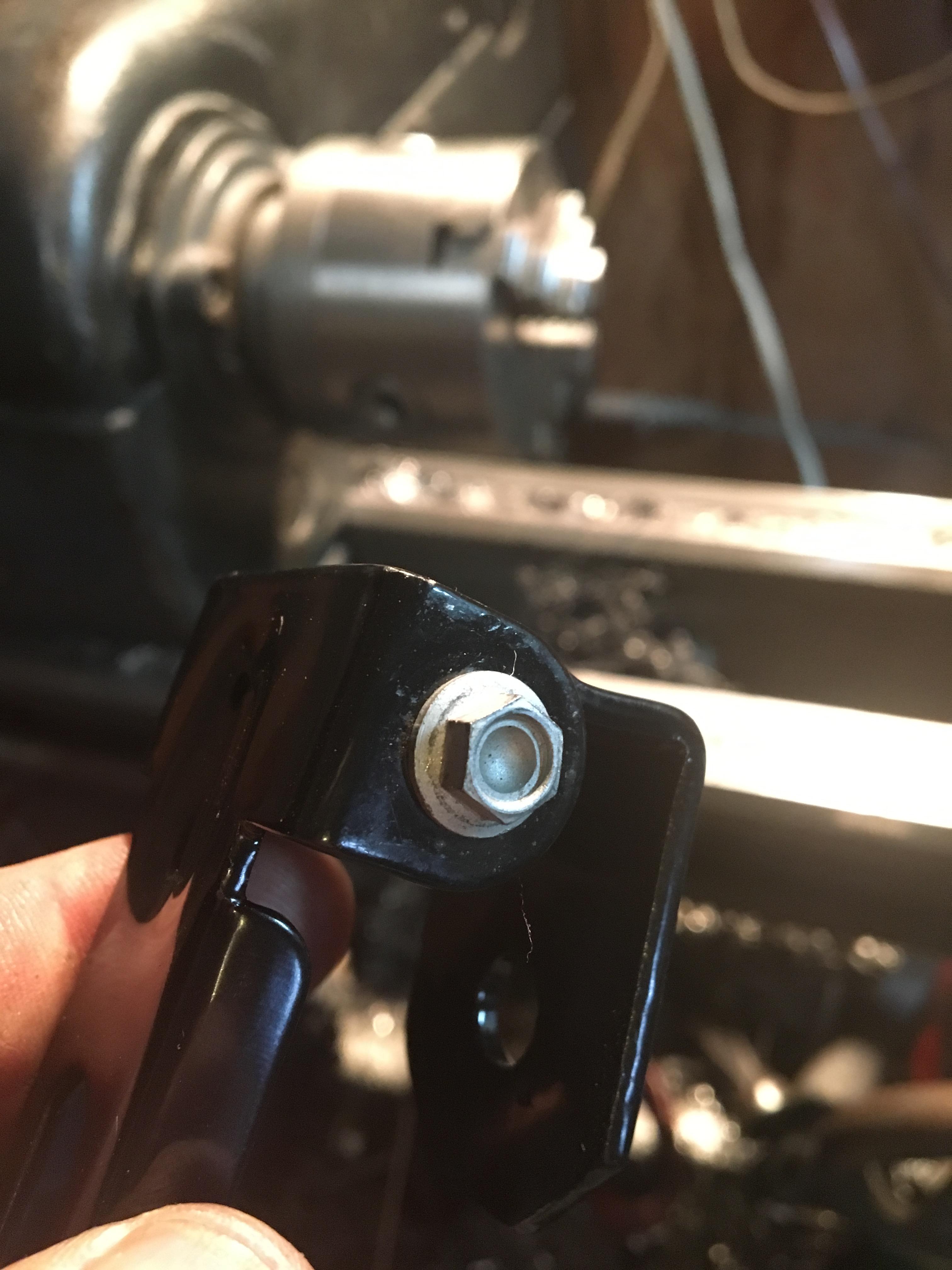

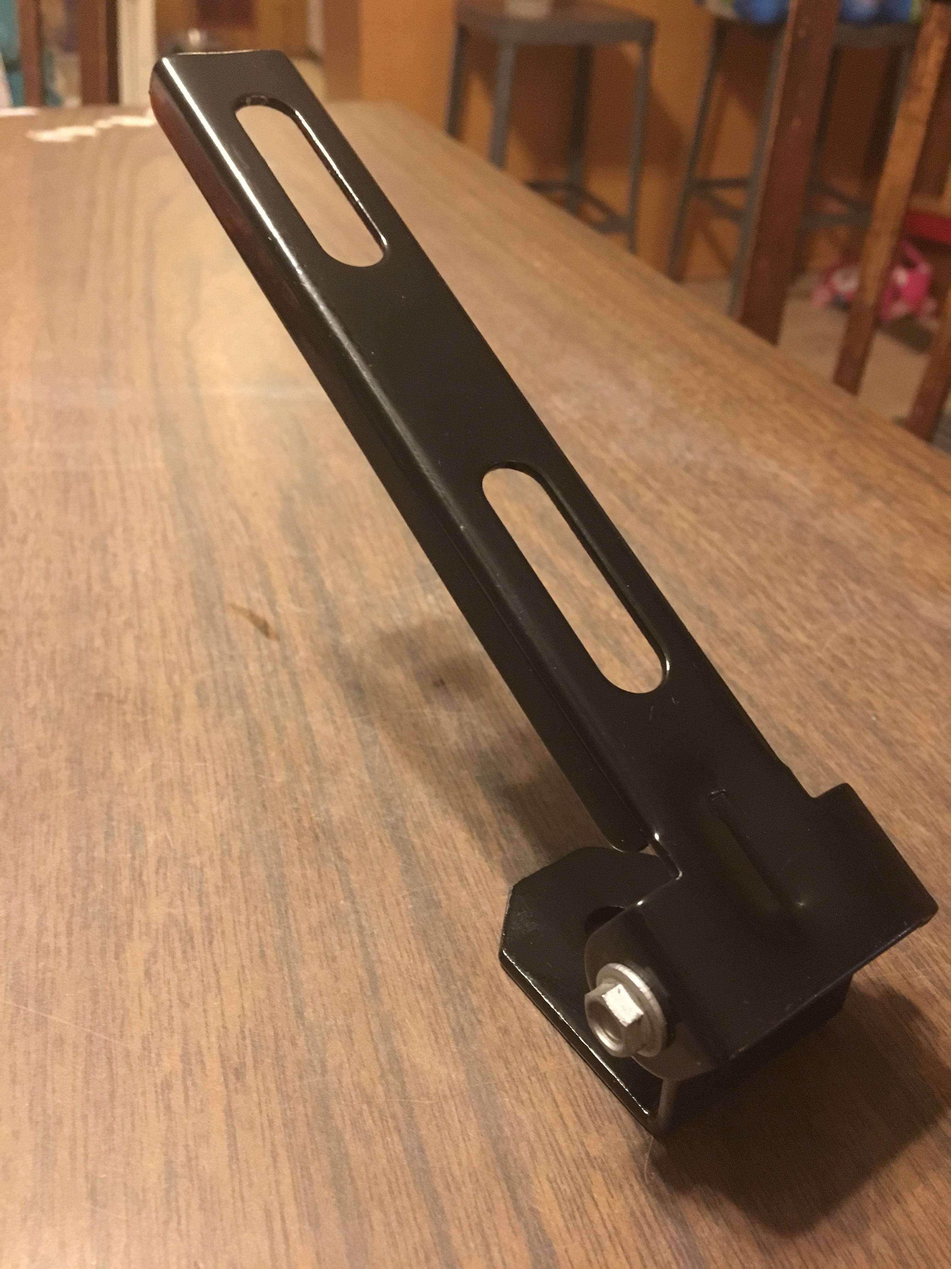

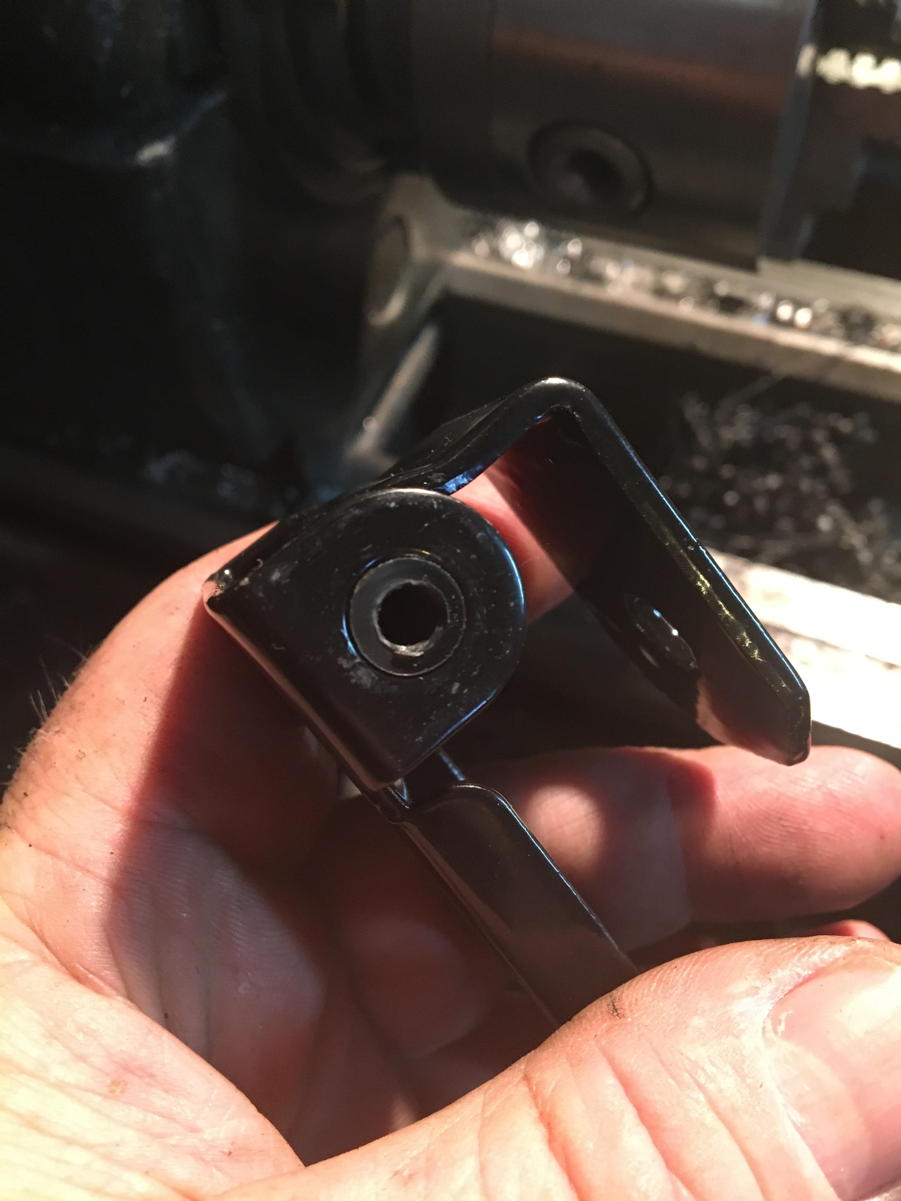

« Reply #214 on: Jun 14, 2018, 21:41:58 »
I decided to get a better seat hinge.  It's still not the top dollar hinge, but it should suit my needs.  One thing, though, I didn't like about it is the hinge pin was a basic nut and bolt.  Nothing fancy, and certainly nothing nice looking.  So instead, I upgraded it a bit by machining a delrin hinge pin.
Sometimes it's a bunch of effort for the simplest things.
The pin stays stationary, while the hinge rotates around it and it will hold in an upright position, which will make working under the seat easy.
