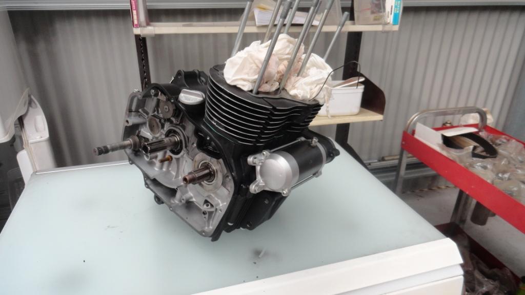

Made some alloy front and rear engine plates and roughly bolted the bottom half of the engine in to sort out the chain alignment.
https://i.imgur.com/IEN2iFg.jpg[/img]]
https://i.imgur.com/Klp6ytj.jpg[/img]]
I had an old sprocket and chain laying around so I fitted them up. With the chain lined up and the left hand spacer in place the wheel is offset around 8mm to the right hand side so I just adjusted the spokes and pulled it over into the centre, so all good now. I don't think it will be an issue but I will pull the tyre off and make sure that there are no spoke ends poking out through the nipples.
