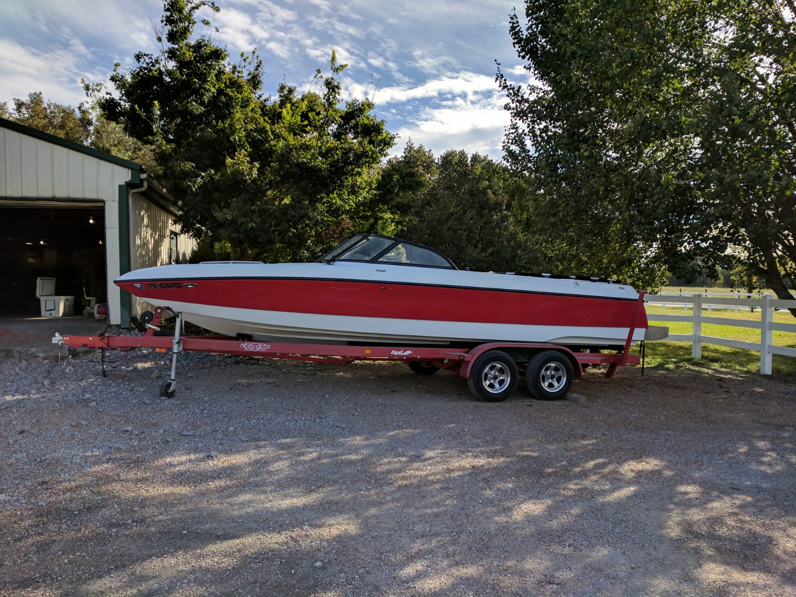

It's a 2001 Tige 23V Wakeboard boat.
I want to turn it into a modern Wakesurfing machine.
It looked in much better shape than it was.
