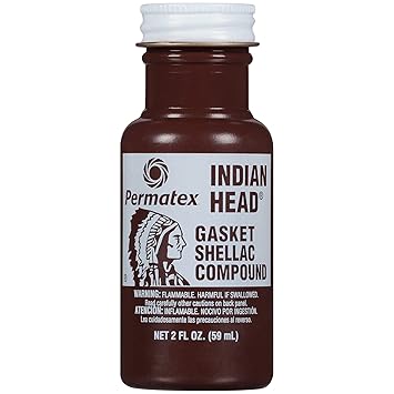

I use Indian Head shellac to basically glue the gasket to the cover just like what you have there so you can reuse it over again. I then paint some on the motor side when I put it back together for a nice tight seal. you can get away with pulling the cover on and off a bunch of times that way. Always worked great on the valve covers of our VW Bug drag cars where we may need to make quick, last second adjustments
