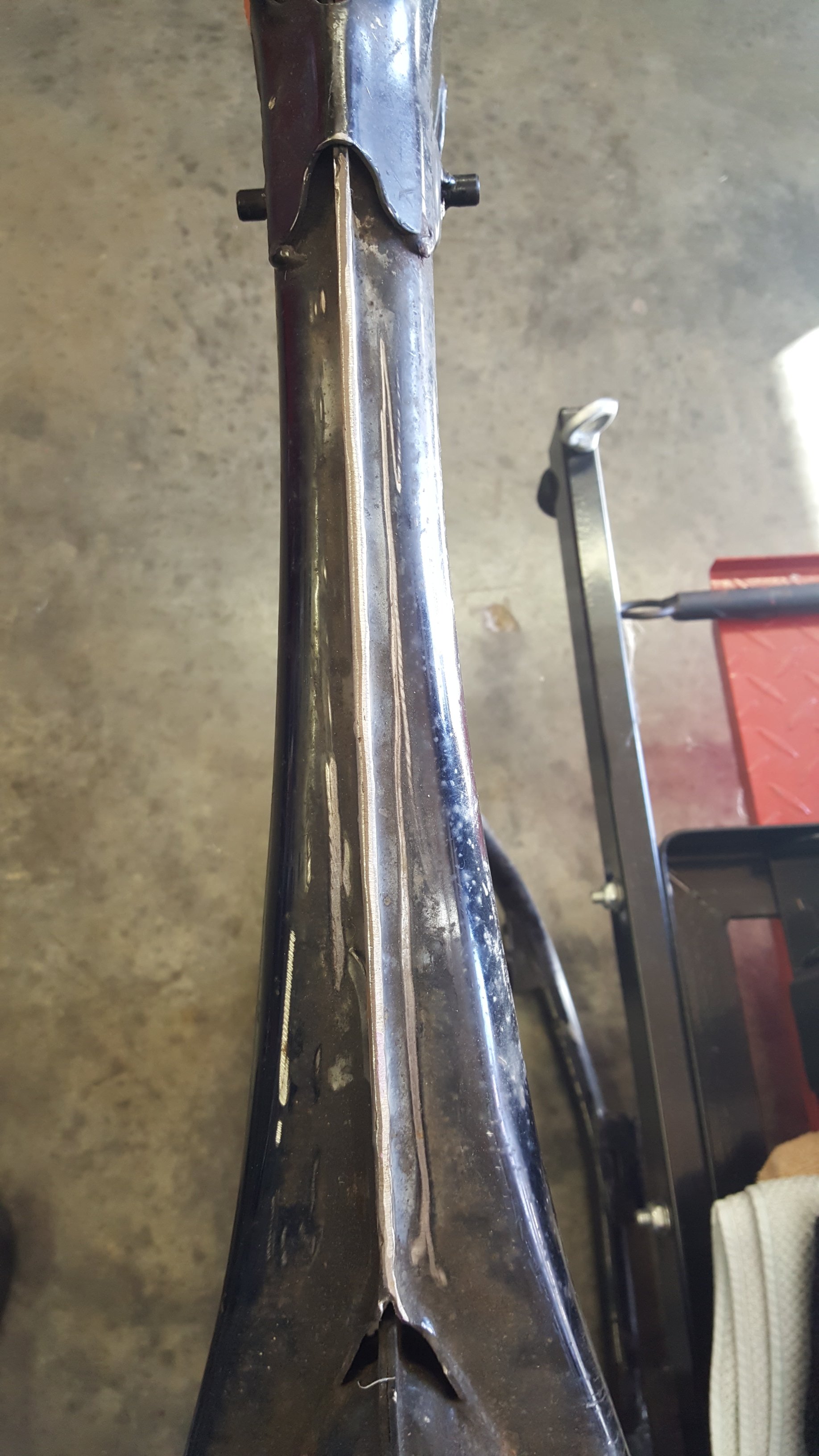

« Reply #8 on: Nov 10, 2018, 17:45:44 »
Realized I had never posted up the work I had done on the frame.  A buddy down in NC did it up for me.  He's an old salt, Navy welder/instructor.  He's also an old biker.  This is what he did up...
Next step is to have it stripped and powder coated.
