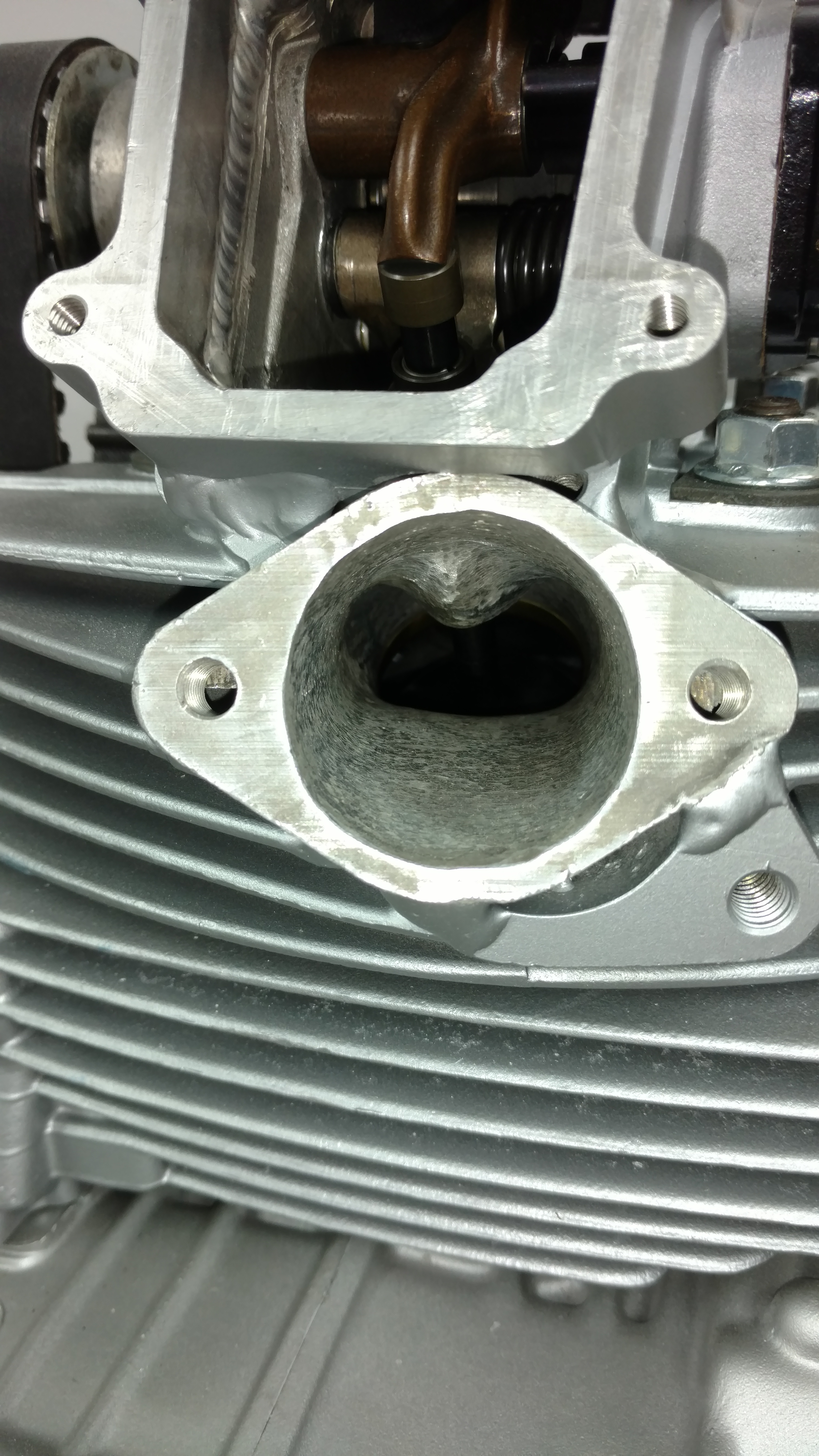

to modify the ports, I milled out parts of the head and welded in inserts, then welded and blended the ports to the original head, I aimed for a wider intake port at the mouth, with a good taper to the valve seat, this should increase port velocity and take advantage of the greater overlap in the st-2 cam, these motors really fall on their ass above 7000 rpm.
after all the welding and stuff, I had to re-heat treat the heads because they lost all their temper in some sections, namely around the seats, which wouldn't be good, so I found a kiln on craigslist for cheap, fixed it up, and ran a t-6 solution, then aged, seemed to work fine.  the heads were also pretty warped after that process, so I remachined the head sealing surface and re-reamed the rocker pin holes, it assembled fine, the cam bearing caps were quite tight but they still went in, so I say send it, let's see what it does.

Is that intake port still work in progress or have you deliberately decided against a port-side bias, if so... why?
(That is unless this is a professional secret, which I totally accept...)

both ports are finished, the angle of the intake port is based on changing the vertical angle first, then basically figuring out where the new port runs into the old port casting to minimize the amount of fill welding needed, from what I know from people who build these engines to race, any side bias in the ducati ports has more to do with packaging than generating swirl, they'd work just as well with the ports directly in line with the center plane of the cylinder

The port shape looks good. Did you open the intake seats to .9 of the valve OD? I am glad you mentioned the heads losing their temper after welding. Try milling a head after it has gone soft.....you will pull your hair out.  ;D

I'll check my notes, I think they might be wider than that, but they're definitely wider than the stock seats by a long shot
