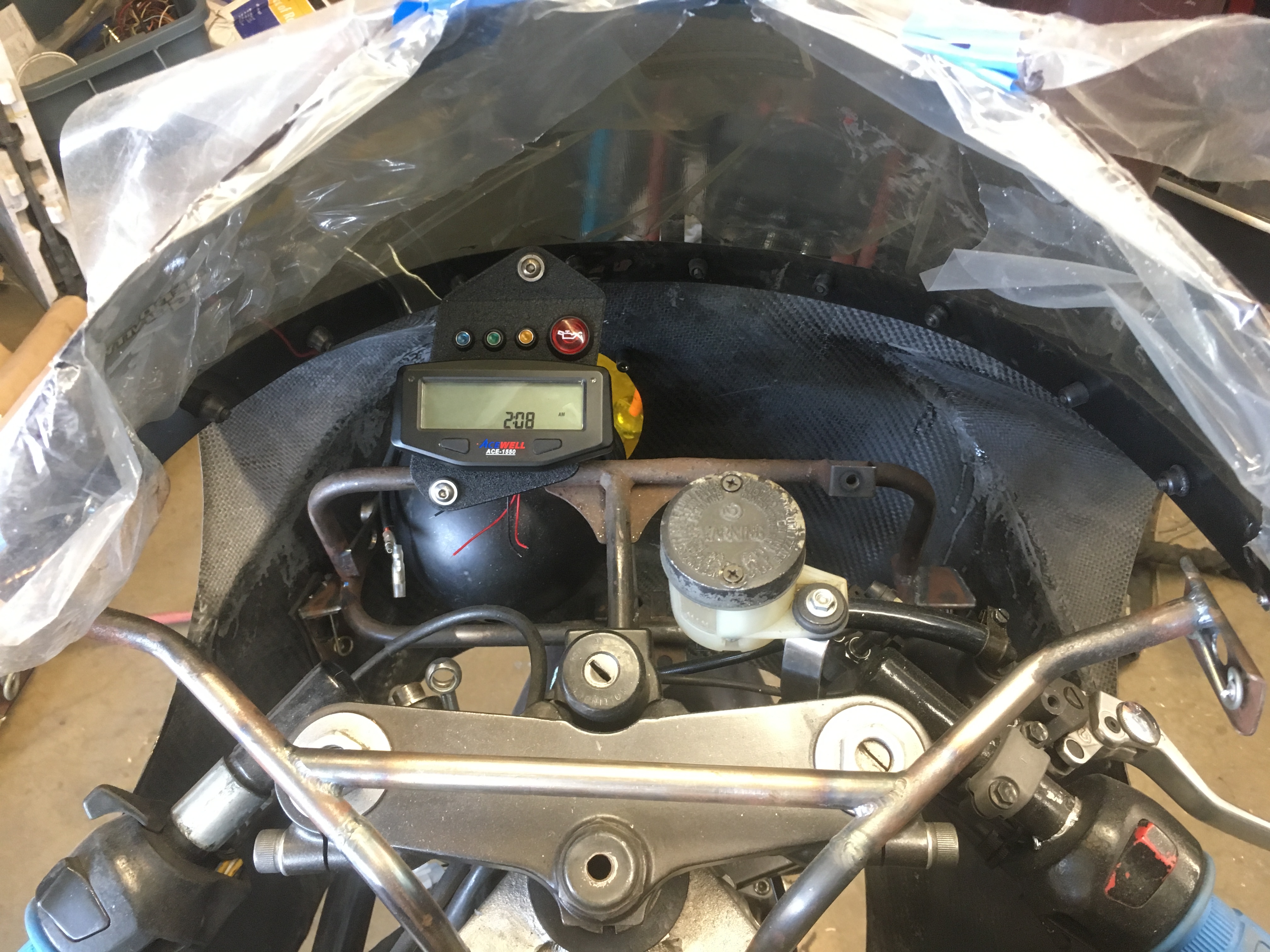

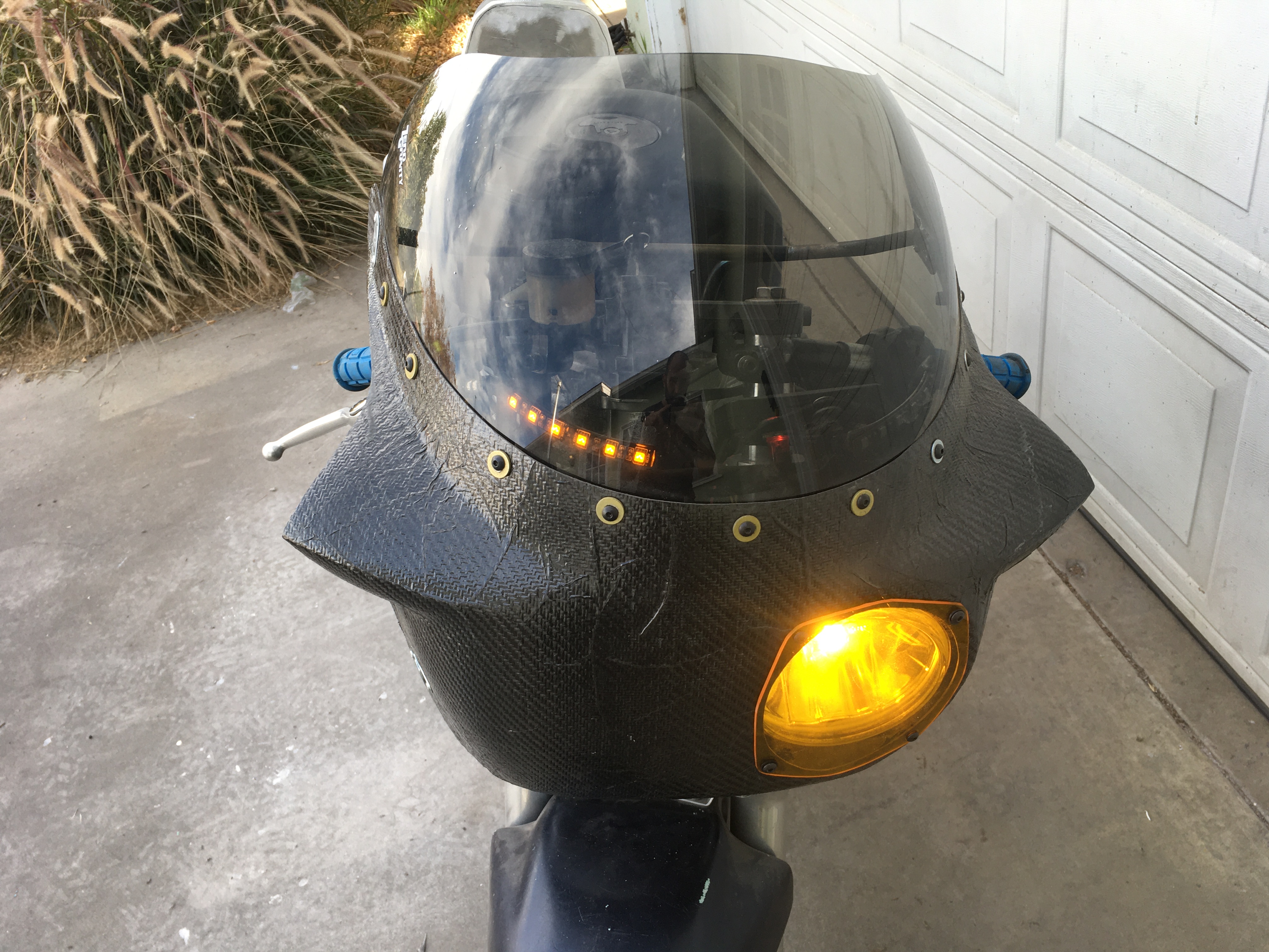

Started sanding the fairing down to bare plastic, there had to be 1/4" of paint on this thing. once I had it stripped bare I realized this fairing has been repaired many times and was cracked everywhere. Coincidentally my dad recently finished building a wooden kayak and had a bunch of resin and fiberglass leftover that he  offered to me, so I got creative. I made a crude jig and mounted the original fairing on it then filled in voids with clay. I also did a thin final layer over the whole thing inside and out to seal in the original fairing because I just kept finding new cracks.
 I'm going to use a 4.5" Harley headlight with a custom bucket i made years ago and never used. Offset, endurance style; i rounded over the opposite side of the fairing as well to compliment the look.

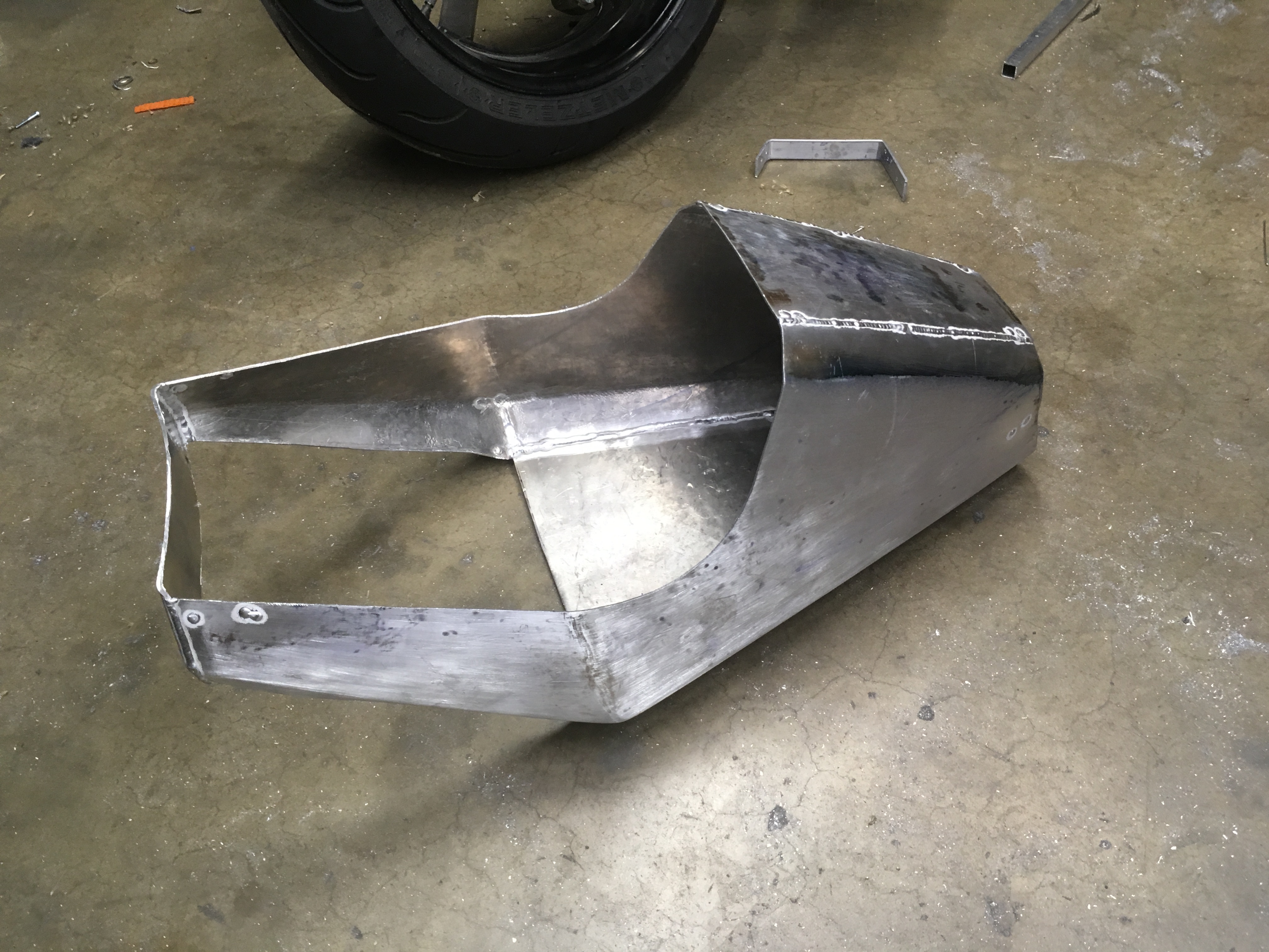

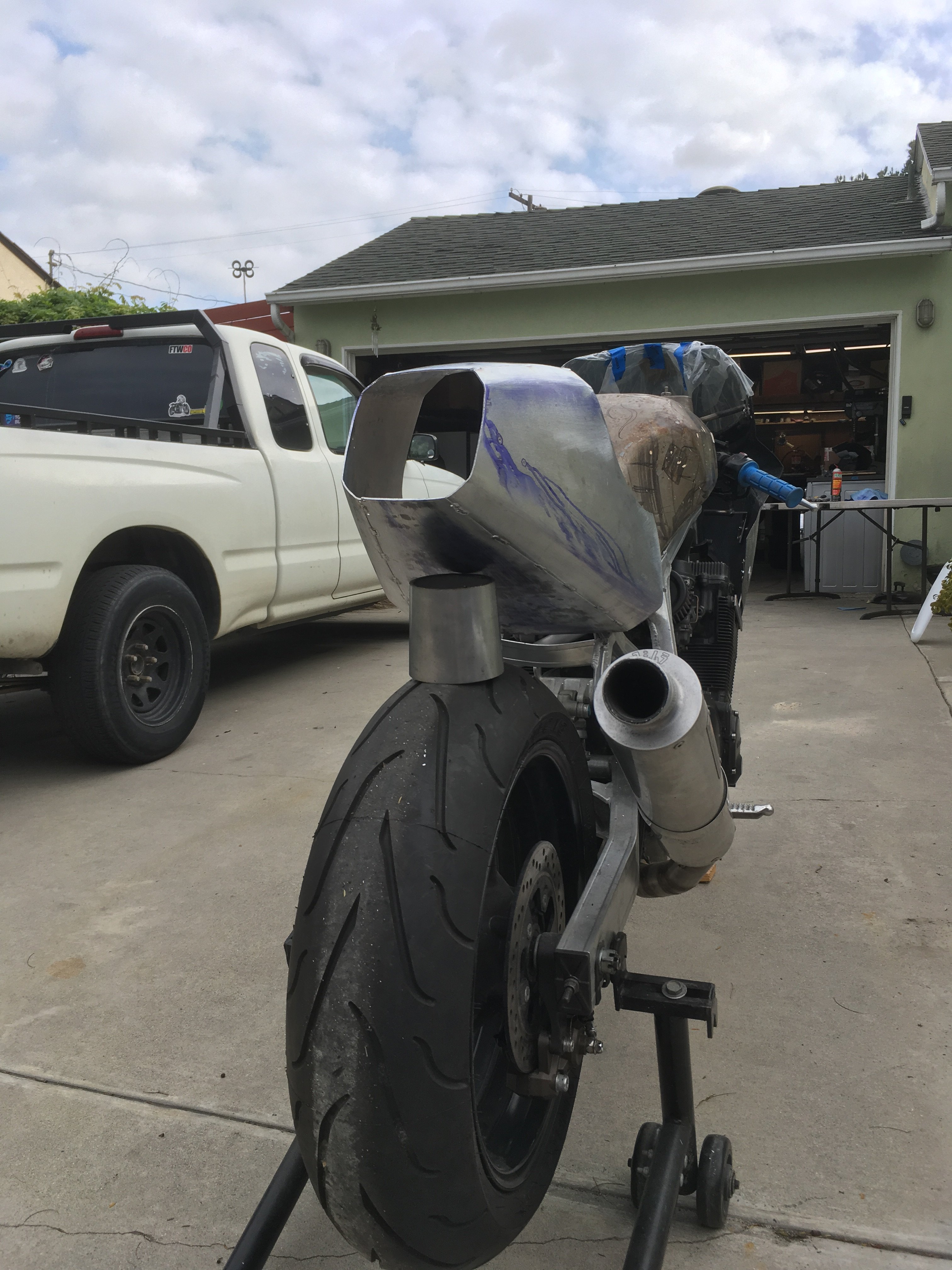

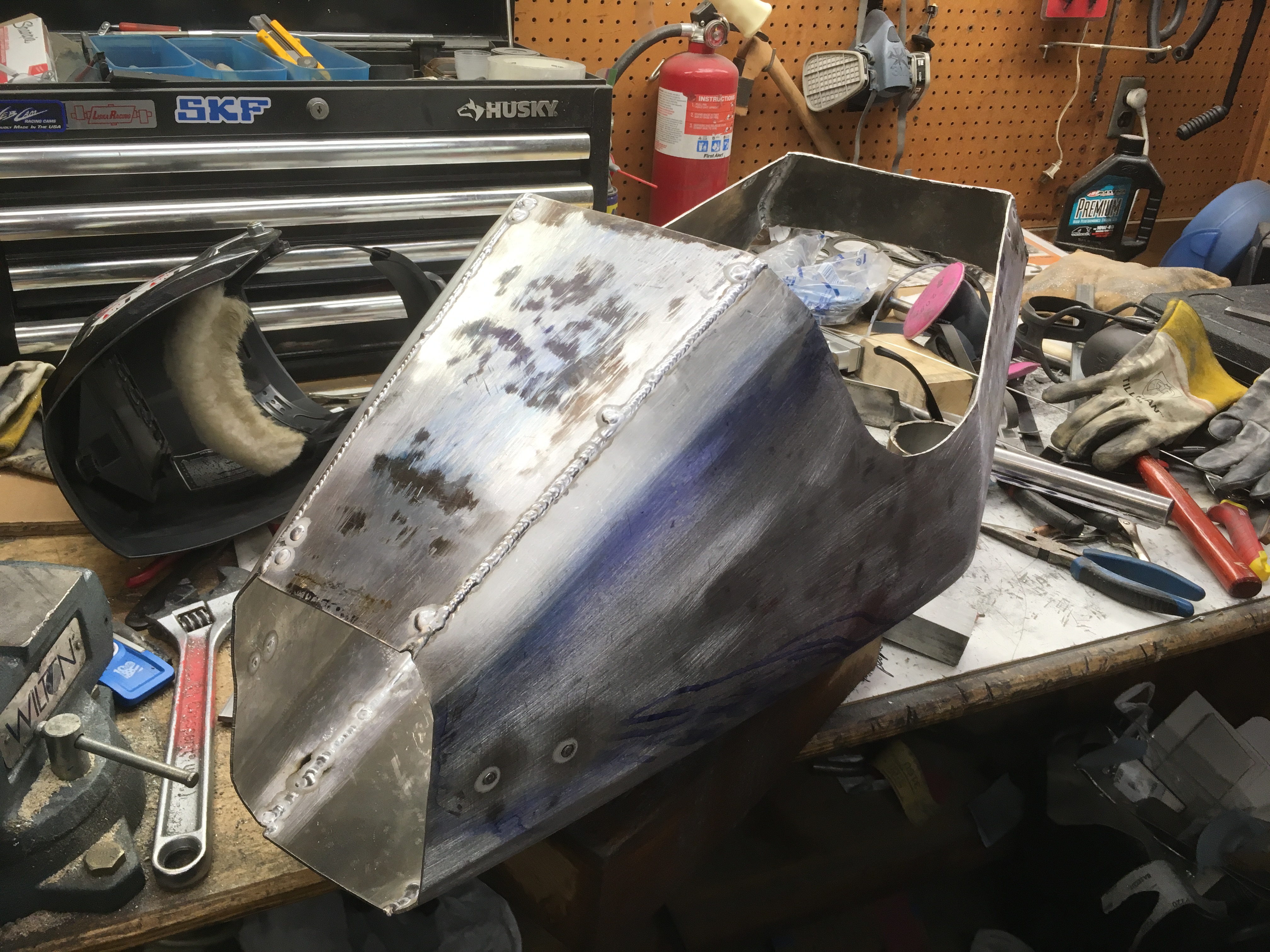

Im going to try something I have never done and fabricate and aluminum rear cowl.  Needs some bashing and trimming but its getting there. Total cost of the cowl with stick on seat will be about $40 depending on how much I spend on fasteners.

Great job on the rear cowl. Is it all one piece, except for the seat base of course?

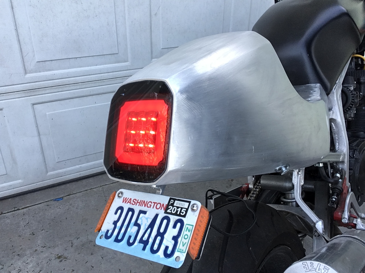

Im just getting started on the rear cowl, I only bent up one side so far. The camera makes it look more complete than it is. ultimately I think it will be 5 pieces total.
