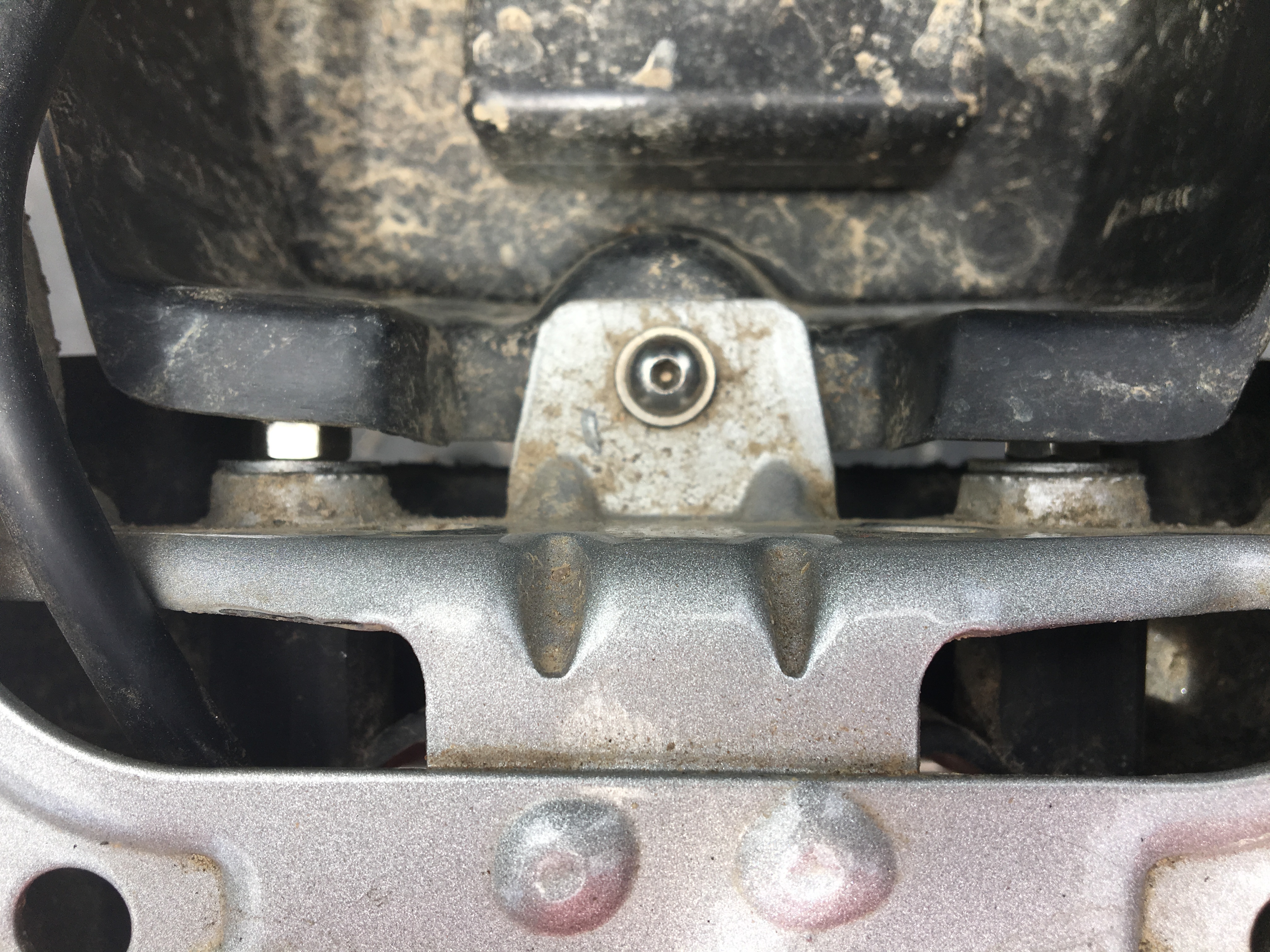

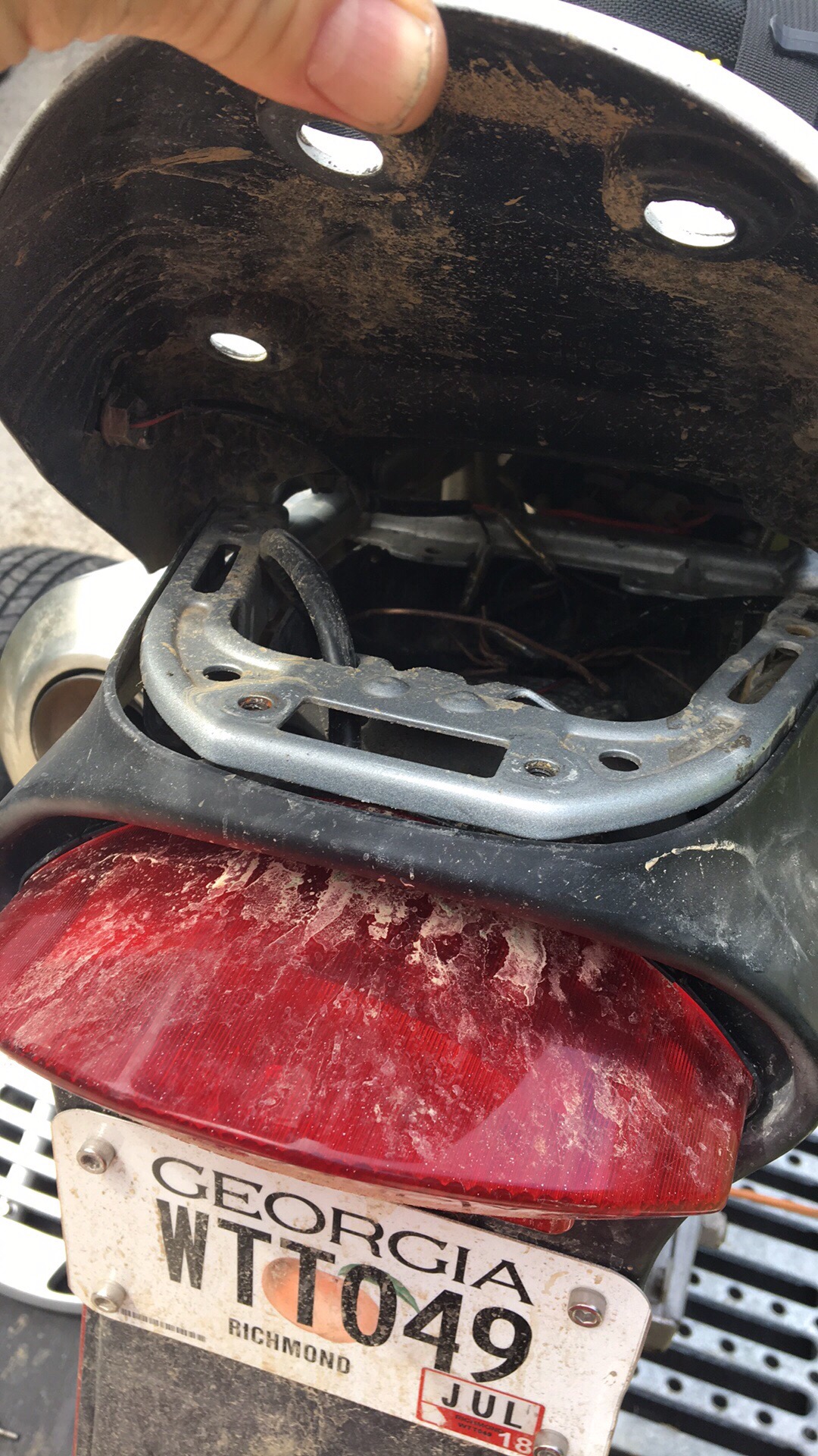

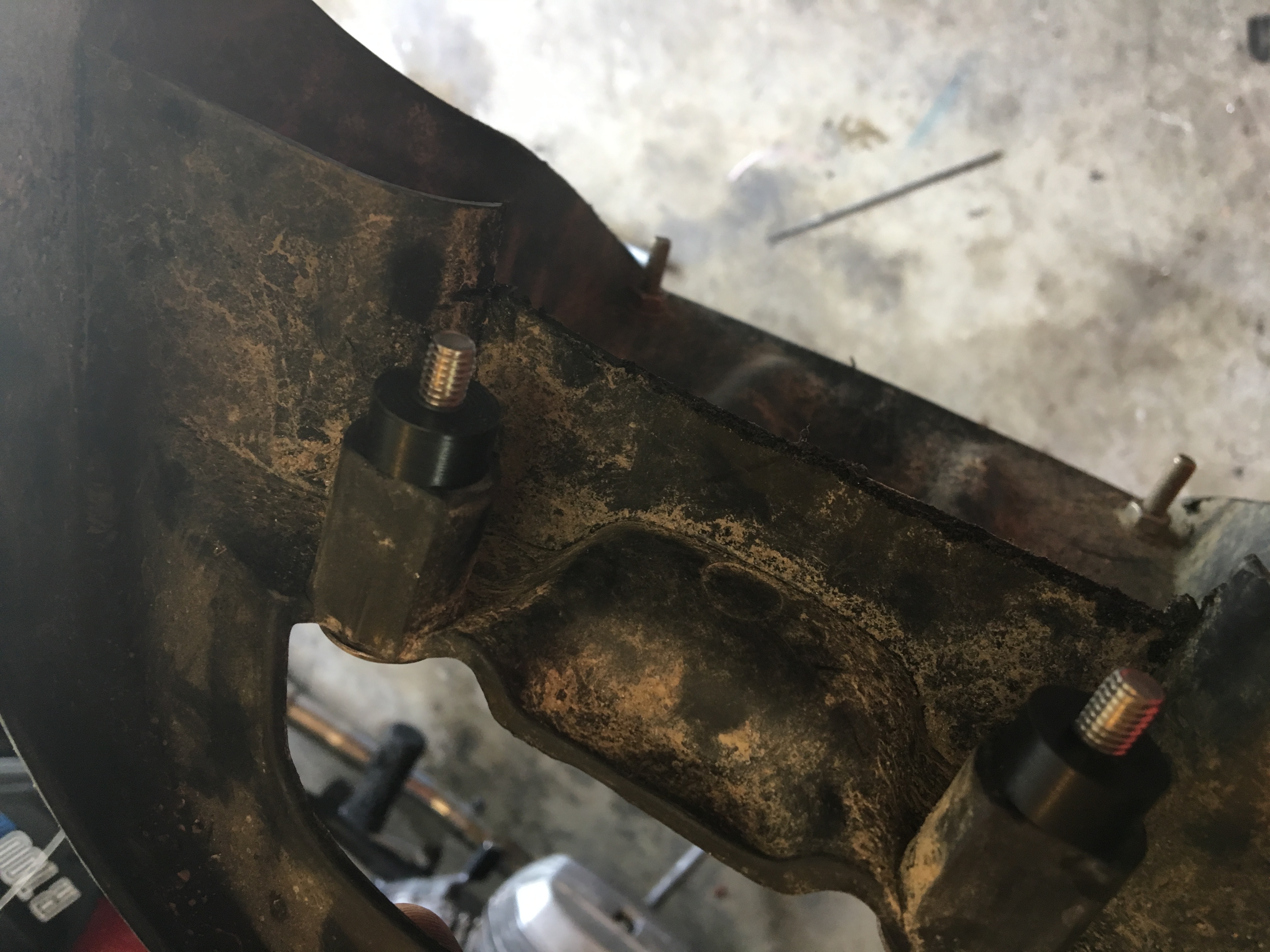

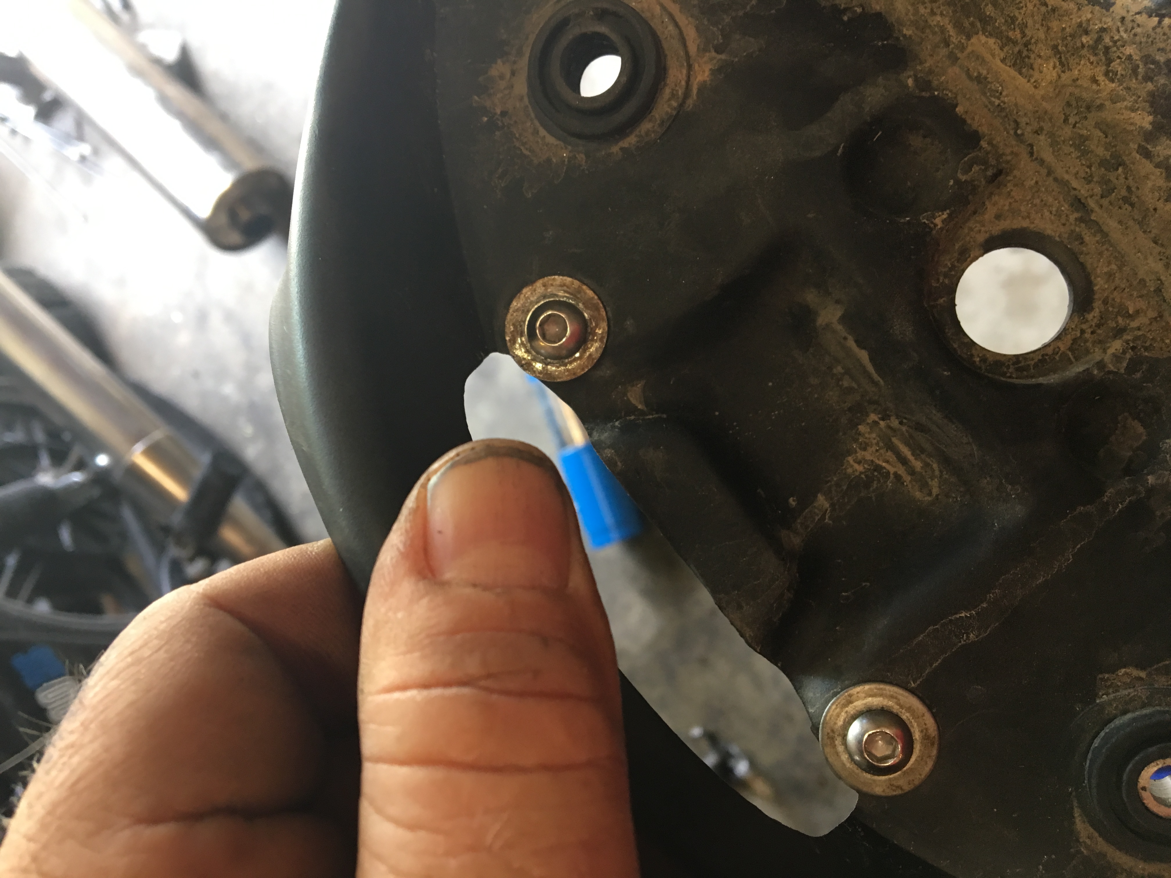

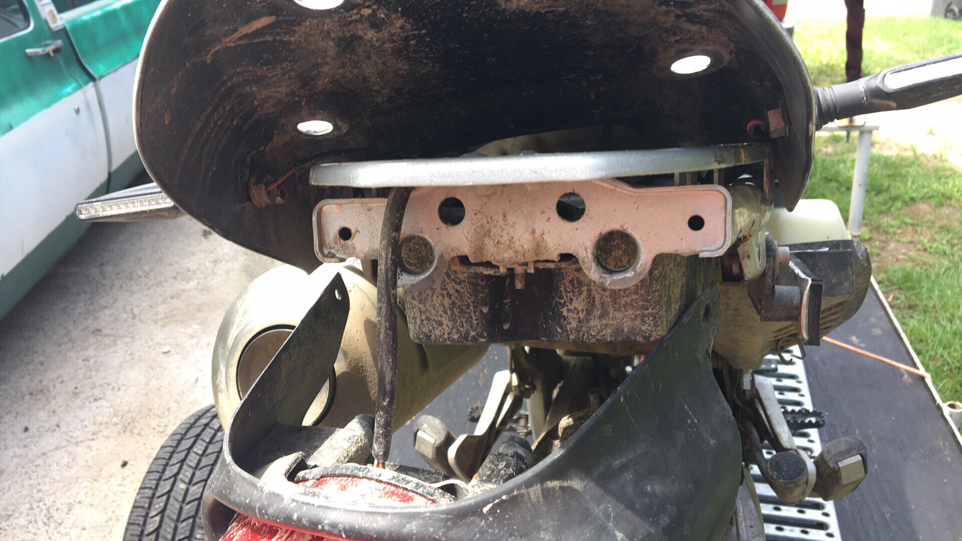

After 120 offroad miles this weekend, and 20 or so a month ago, my tail piece (the part that holds the tail light and license plate) loosened mid trip.  Both times, I had to zip tie it back on to get through to home base.  As it turns out, these things, as bulky as they are, are only mounted with two screws.  Behind the tail like are to rubber isolated pins that fit into holes in the back of the frame.  Vibration from the terrain and constant jarring, plus the weight of the part lead to loosening that nothing wants to fix.  Plus, these screws threaded into clip on nuts, which may not be the best for these circumstances.  To solve my problem, I machined and thread two delrin sleeves that replace the rubber parts, then nuts and washers to make for a more secure fit.  I also threaded screws through the frame on the sides and used nuts and washers as all four points. Finally, I trimmed the bottom of the tail piece off to cut the weight in half.
