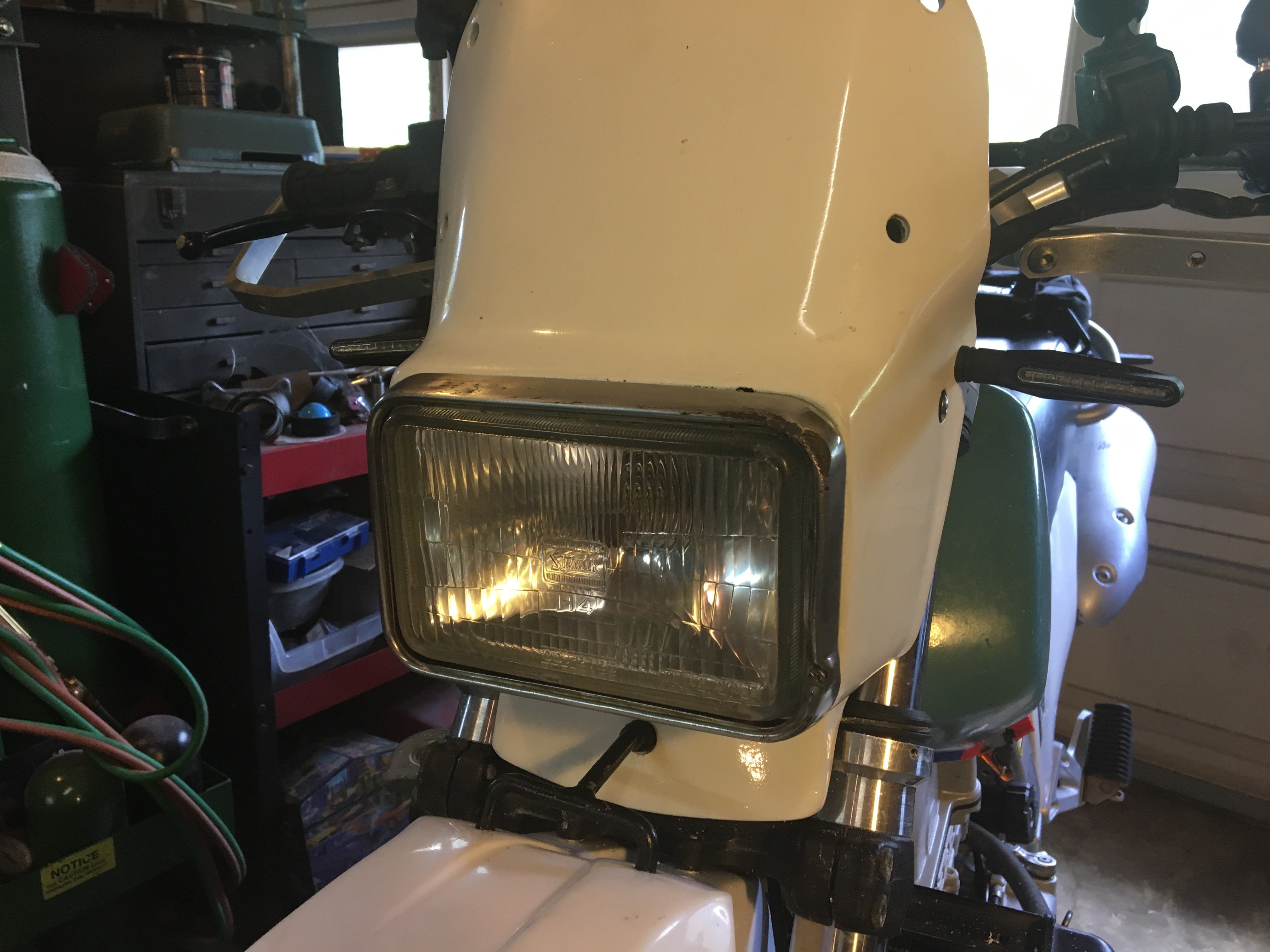

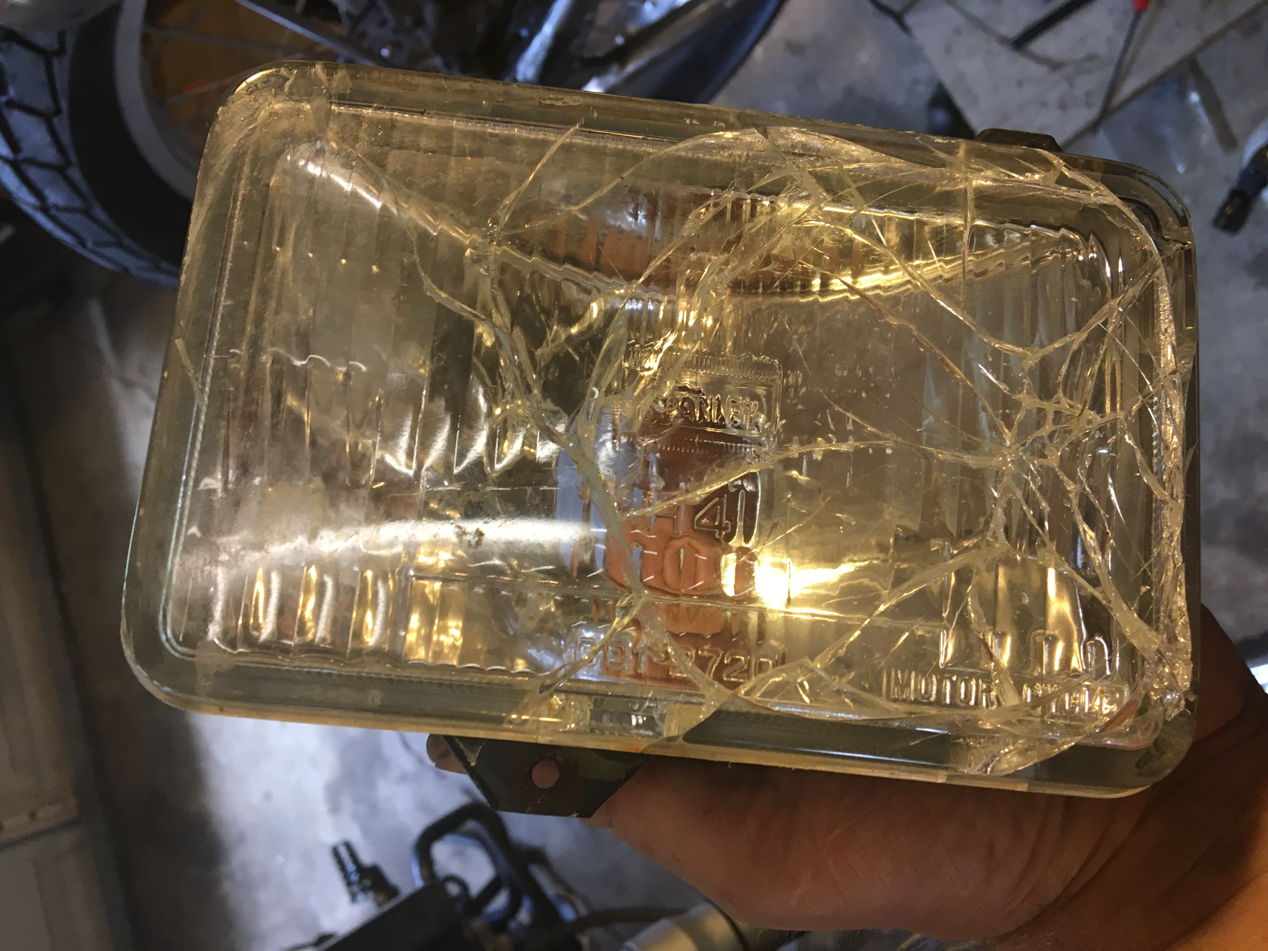

While riding at Thaw, I got some rocks thrown at my light and it shattered.  Unfortunately, there aren't a lot of options for replacement without spending a bunch of money.   An eBay listing had a couple of Ascot lights for $30, so I'd figured I'd give them a try to see if they'll adapt.  Not the best of shape, but maybe a blast and powder or a lack of caring will make it look better.
The Ascot light and ring work together and the light mount doesn't match to fit the DR frame.  It was a right size, however to fit the Ascot light into the DR fairing like it does in the stock Ascot bucket.  So with a little adaptation (mainly removing material for the Ascot brackets), I was able to get it all to work.

« Reply #191 on: Jun 15, 2018, 18:09:22 »
Well there you go.  Looks good
