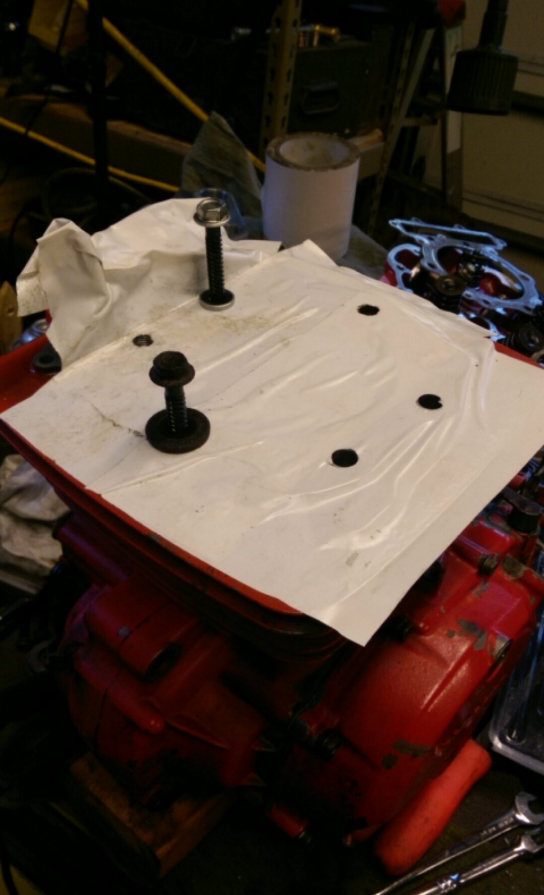

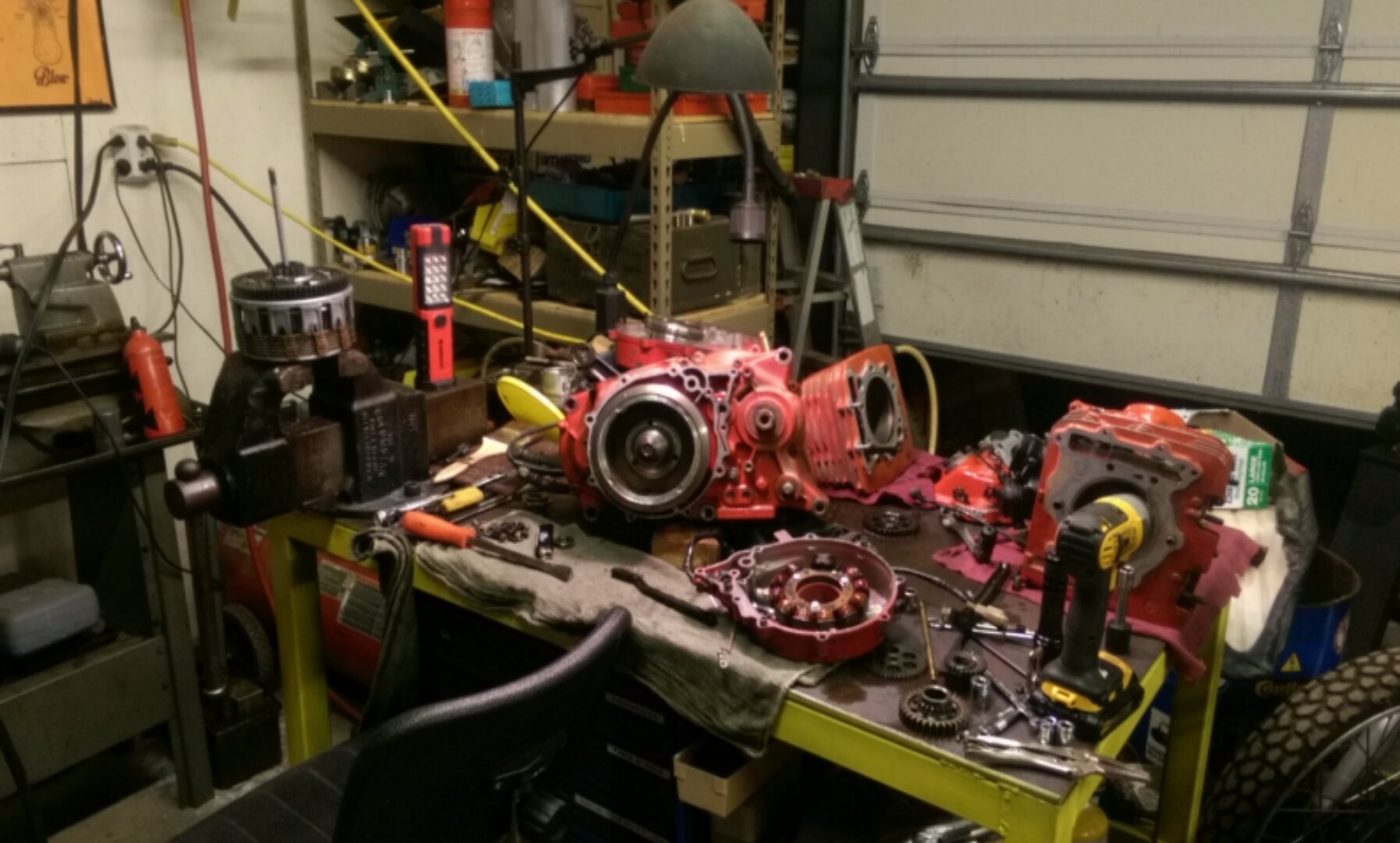

next up, I forgot to mention before that probably the reason the bike was cheap enough for me to afford was probably due to the fact that it had a rather scary sounding death rattle coming from the motor.  Top end, bottom end, not sure.  I instantly thought it was the cam chain since they are obsolete and the tensioners are unobtanium.  After I got home and used the raw horsepower delivery of the rear wheel to plow a garden, reroute a river, and clean out all the ditches, I took the motor out and went to exploring.
I wasnt sure what I was looking for except that the cam tensioner and chain were probably worn out.  So I bought '88 XR600 tensioners, chain, and drive gears.  Since the '88+ XR600 part numbers were different, but really really close, I made sure to swap out the entire set of parts to ensure no odd parts remained.  Put the motor back together after inspecting what I knew to inspect, and it still made the noise.  Back out we go.

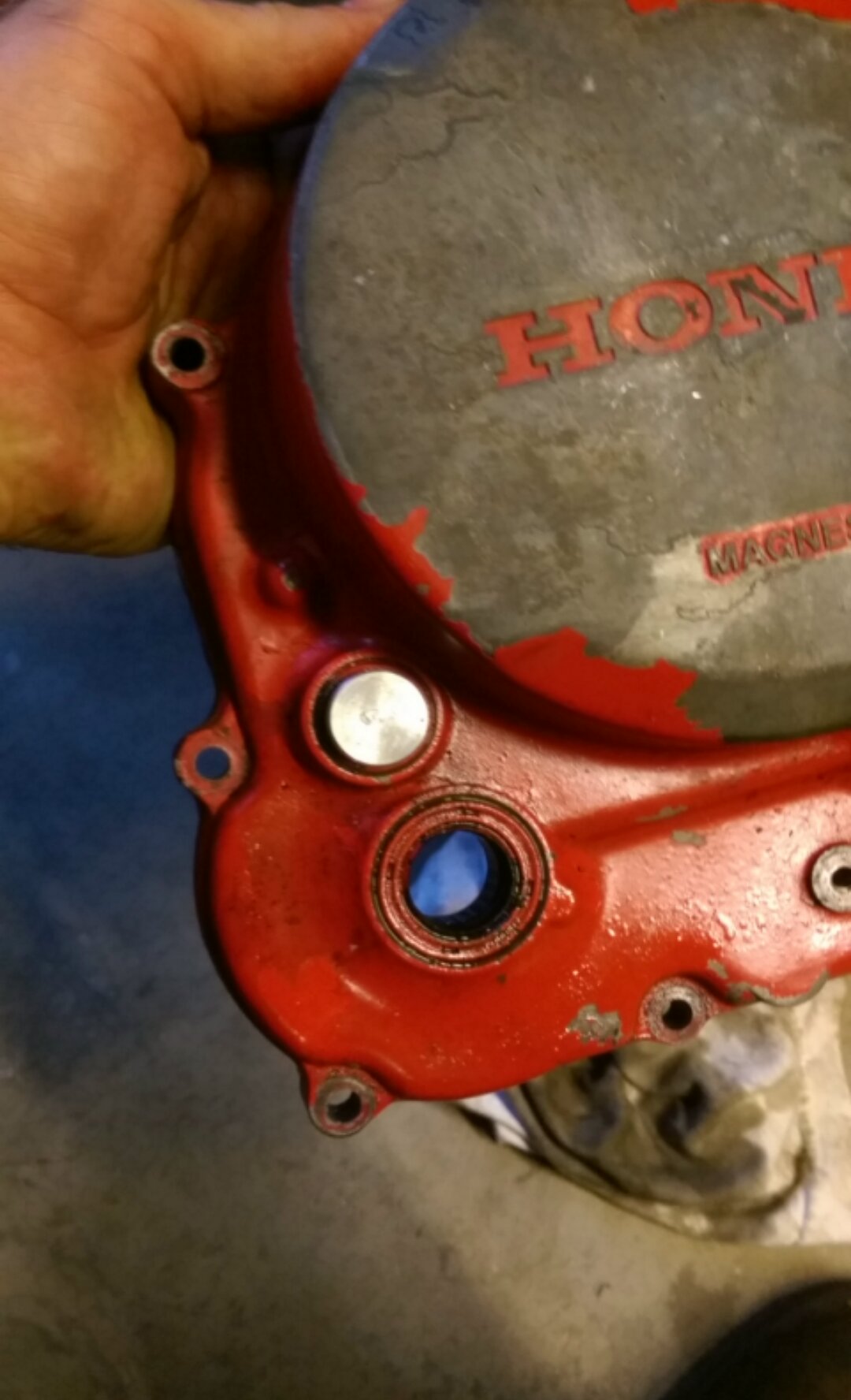

On the second round, I was looking for anything that could be out of whack.  I noticed the lower part of the auto-decomp mechanism was broken off and the pawl rattling around freely.  Success.  I turned a plug on the lathe, removed the sissy cable, pressed the plug in, and started to reassemble.
When I put the cylinder back on, the old magnesium threads gave out.  So... a pile of heli-coils later, Im back in business.
At this time I had a ride coming up that was going to take 3 days, so I was getting eager to wrap this up.  Back in the frame, bolted it all up, left the clutch out, back out, clutch in, back in the frame, etc.  Fire it up.
Still making the damned noise.

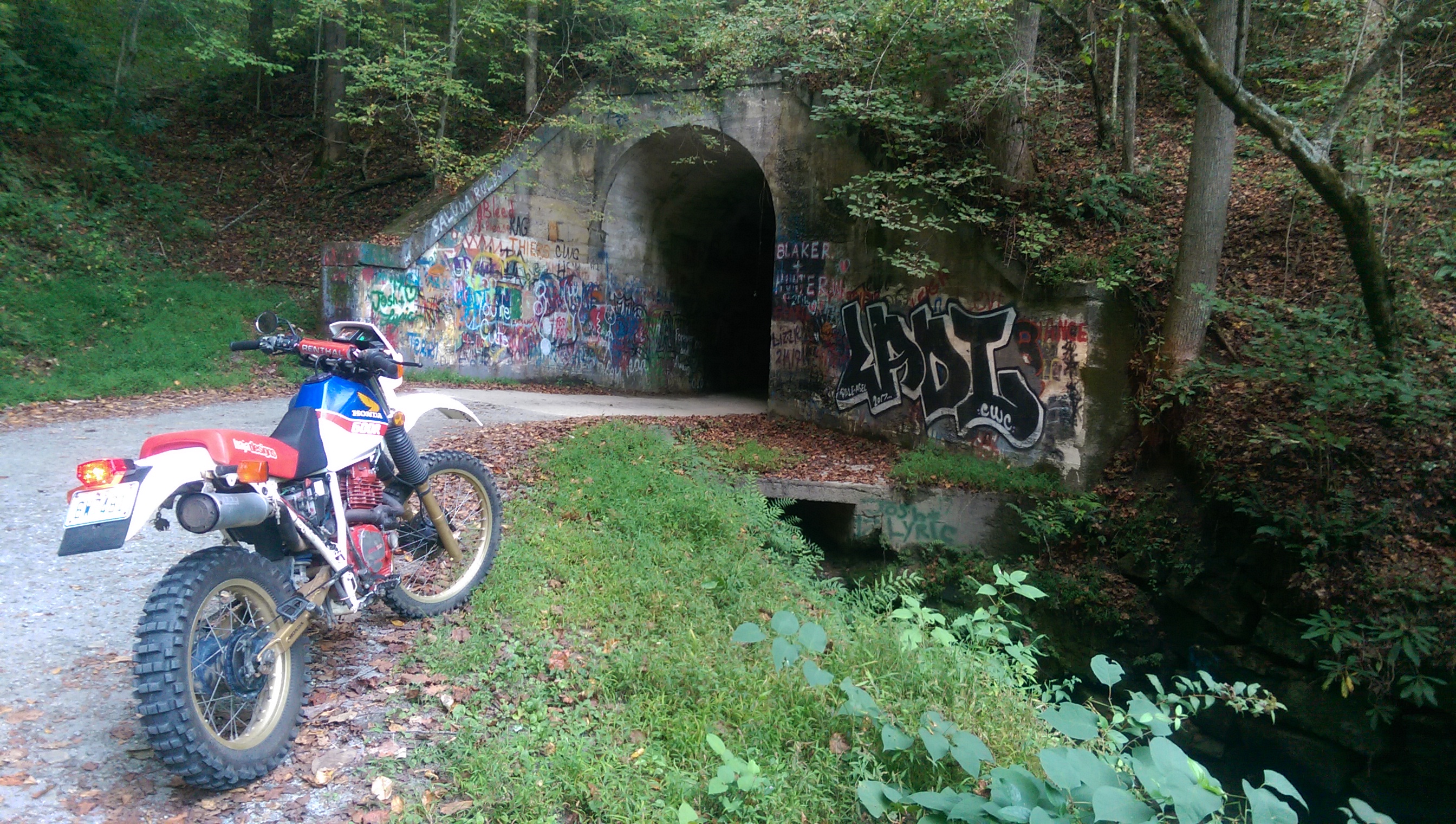

Typical social media type photo to follow...

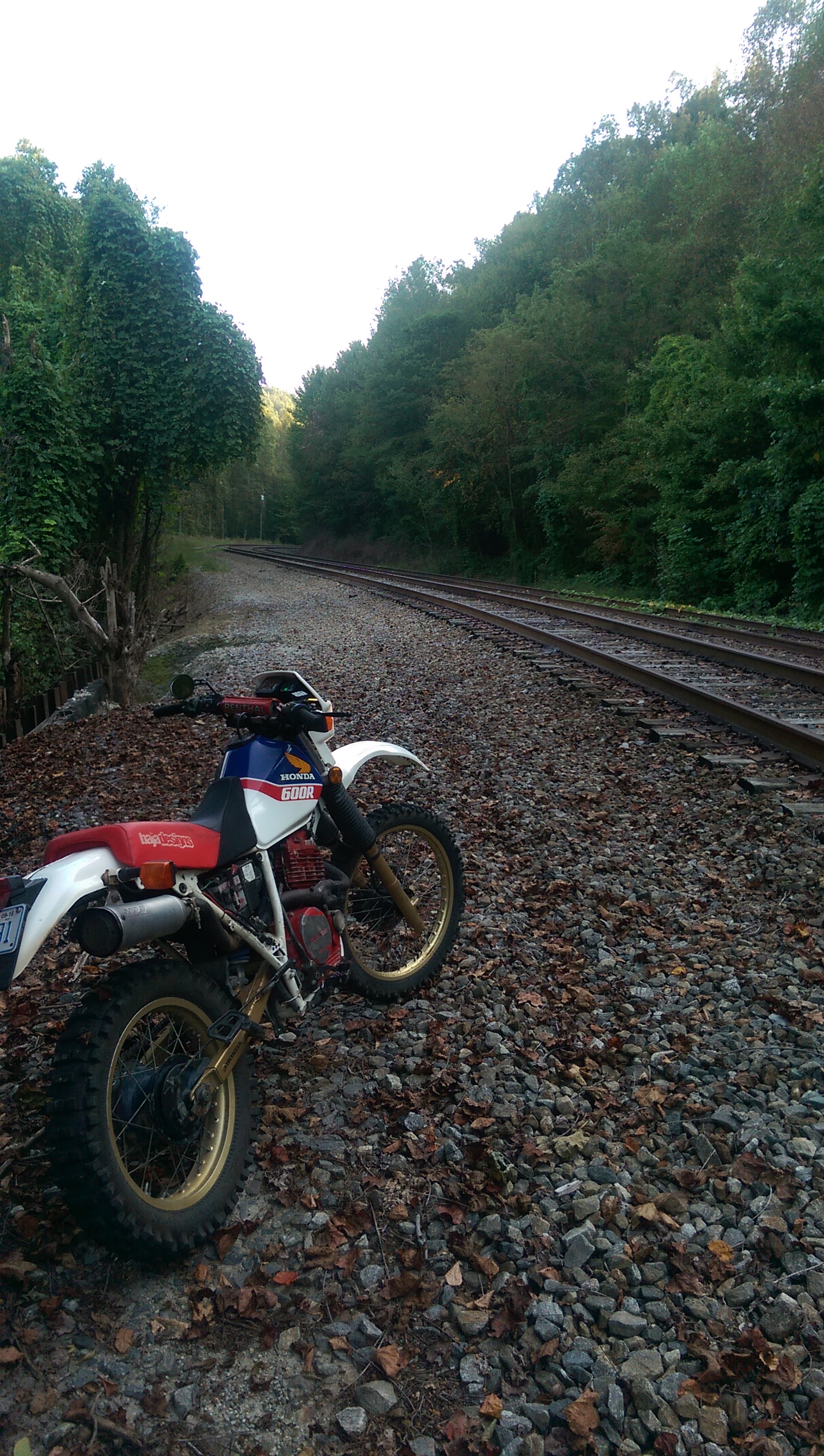

Once in Saluda, there's a little spot just out of town to slip off the dirt road onto the railroad tracks, and enjoy a blast back down the mountain to where the dirt road crosses under the tracks.
Photo suggesting illegal and most badass motorcycle journey to follow...

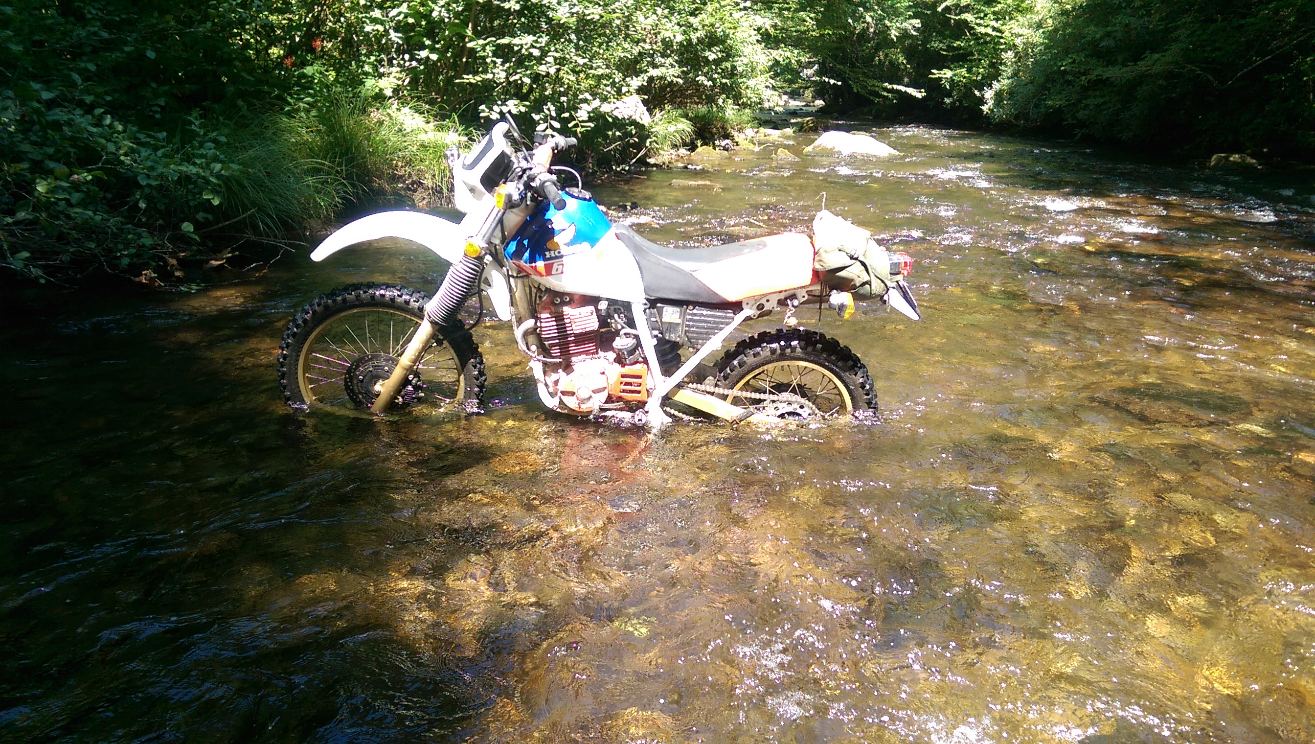

In one spot near cataloochie, I found a creek crossing that looked fun and long, but not technical at all.  So we went for it. I was about 3/4 of the way across and had to fight to get that far.  Turns out the creek bottom was very rocky and the rocks were large and algae covered.  I lost it upon striking a very large rock, and fell over.  I probably could have saved it except when i put my foot down the creek bottom was about 10" deeper than where the wheels were.  Of well, I hadnt showered anyways.  I pushed it on out of the creek and turned back to see Chris suffer close to the same fate.  We worked for a bit to get our bikes started and then decided to head back across for more lunacy.  We both got stuck again, and mine managed to get lodged perfectly upright.
