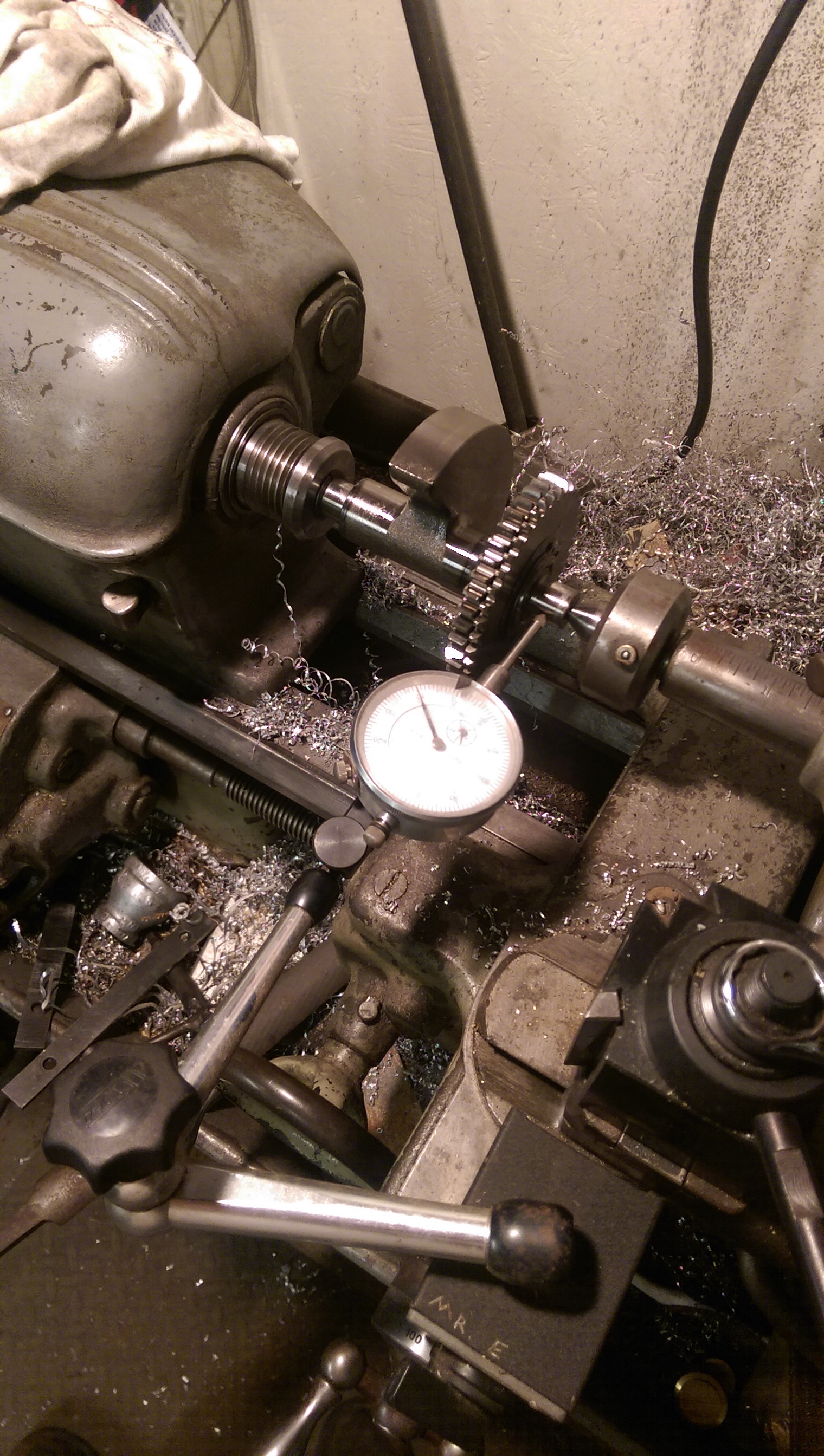

So, bearing out, dropped it in the other case, good to go. Wait. "Dropped" it in the other case, as in, I should have mic'ed the old case to know it was egg shaped and useless now. Oh well, swapping left case now. Installed the bearing back in the case I pulled it from, and checking the counter balancer for wear.
The shaft checks within .0005". Guess that will do. Oh, wait, I've got a spare shaft too. It checks the same. But just because the first one has some scuffing on the bearing end, I'll use the spare also.

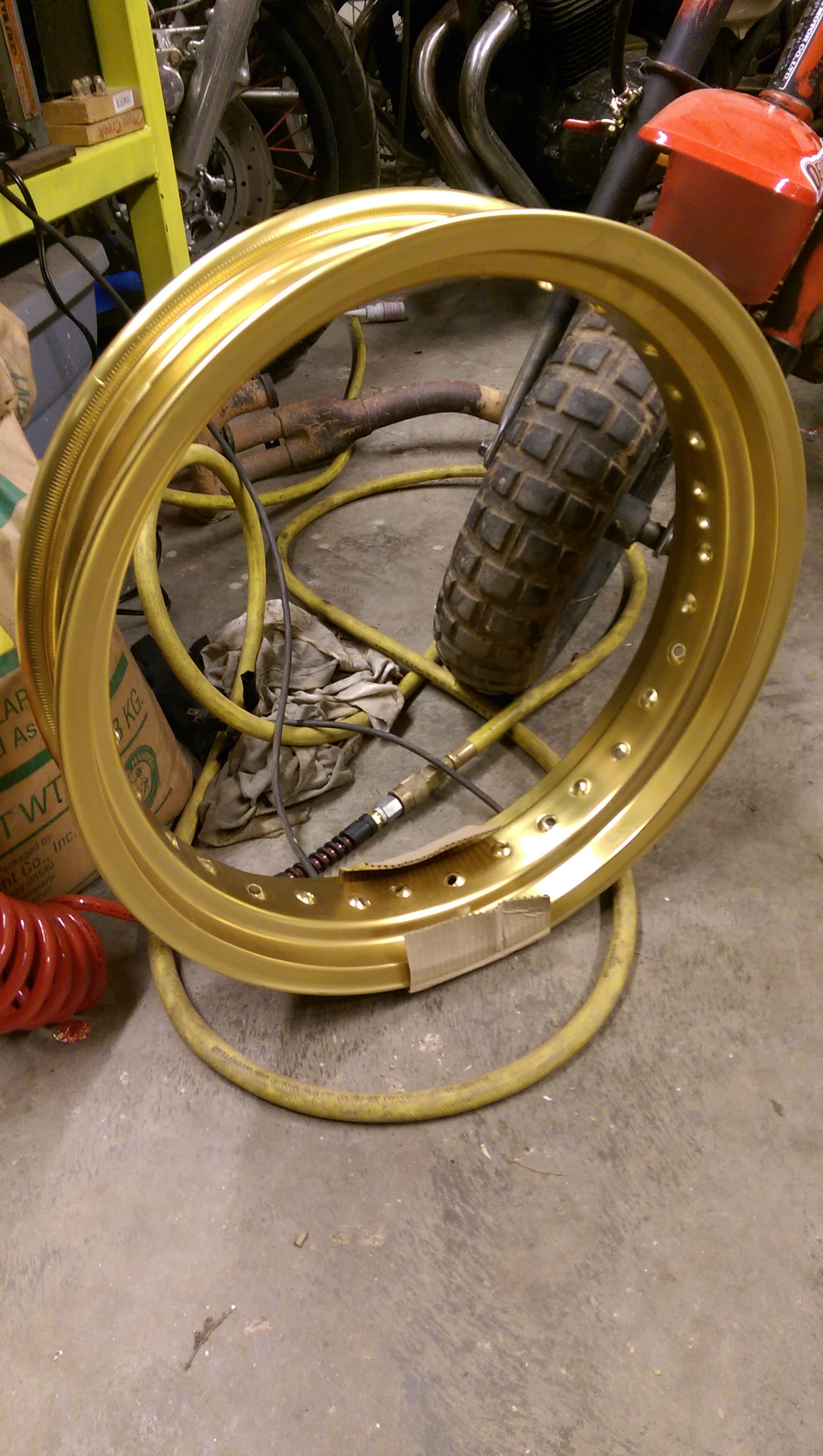

Next up, this nos Transalp hoop will sure look good with that hub from a few posts back.
Need some spokes next. And then some more ingredients will trickle in.

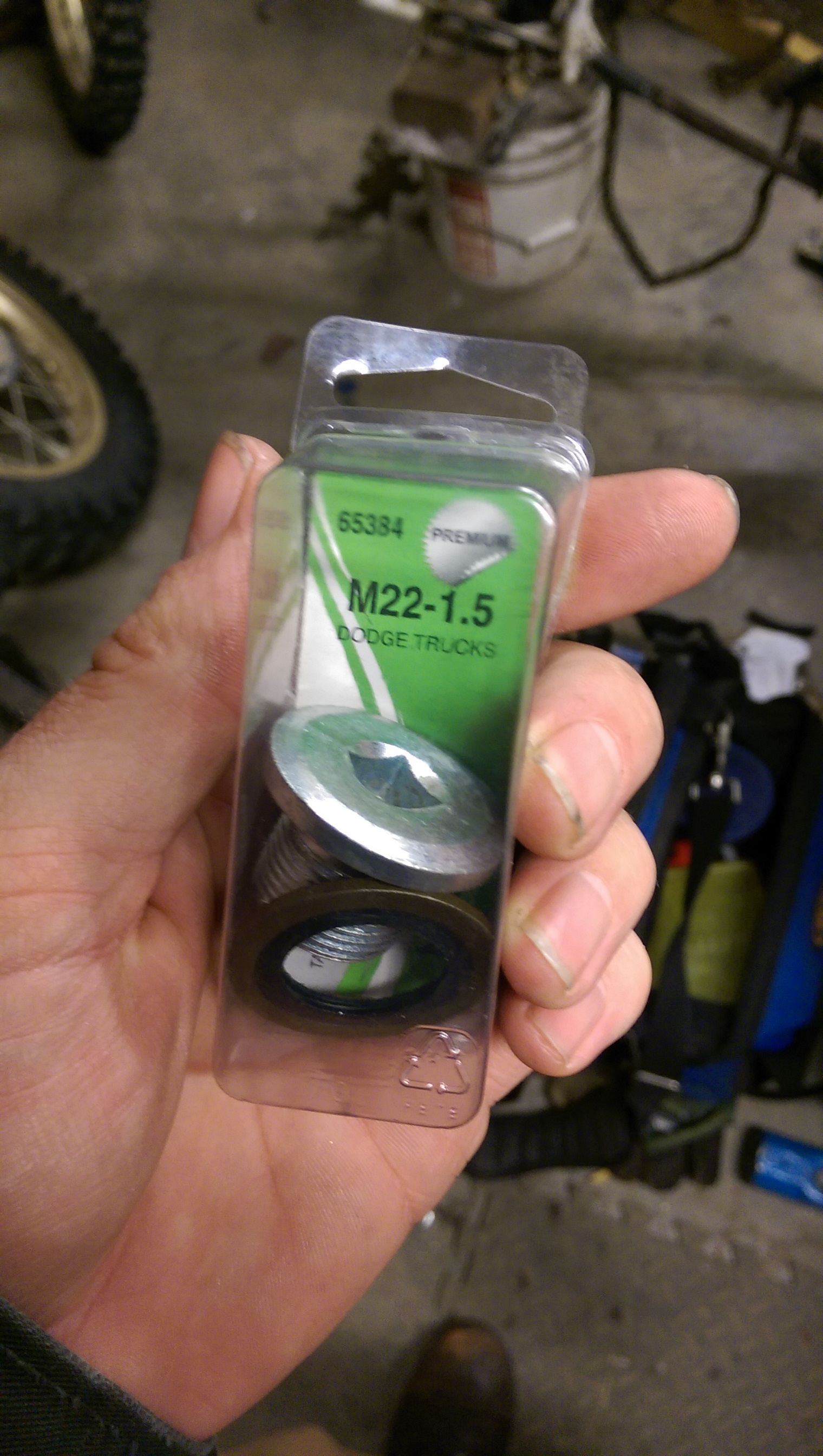

Lastly, I needed a flywheel puller. But it was Sunday evening and the weather was bad. 22x1.5mm.  What's a guy to do? Oil pan bolt from a dodge truck oughta work.
It even fits a bare 3/8" drive ratchet end too.  Turned out to be perfectly sized to lift the flywheel and not make a mess.

Ha nice.  That hoop NOS too it's pretty shiny.
