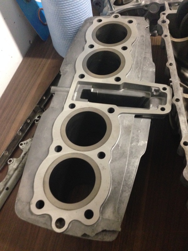

Engine looks good. Only minor machining need to be done.
- Cylinders will be honed (I don't know if that is the correct word?)
- New piston rings and piston cleaning.
- Cylinder head grinding, valves and channels cleaning
- All gaskets and bearings will be bought new
I don't look for more power, but engine should be working perfectly.
Parts are arriving every day, so I will post pictures of those later...

I took the engineparts to the local machineryshop and everything was done in a week.
I don't know right words for the work they did, but all cylinders are hooned (?), surfaces are straigtened (?), pistons cleaned, all valves done and every enginepart is machinewashed to remove remaining soda dust.
Engine is under rebuild and should be in great condition after this  8)
