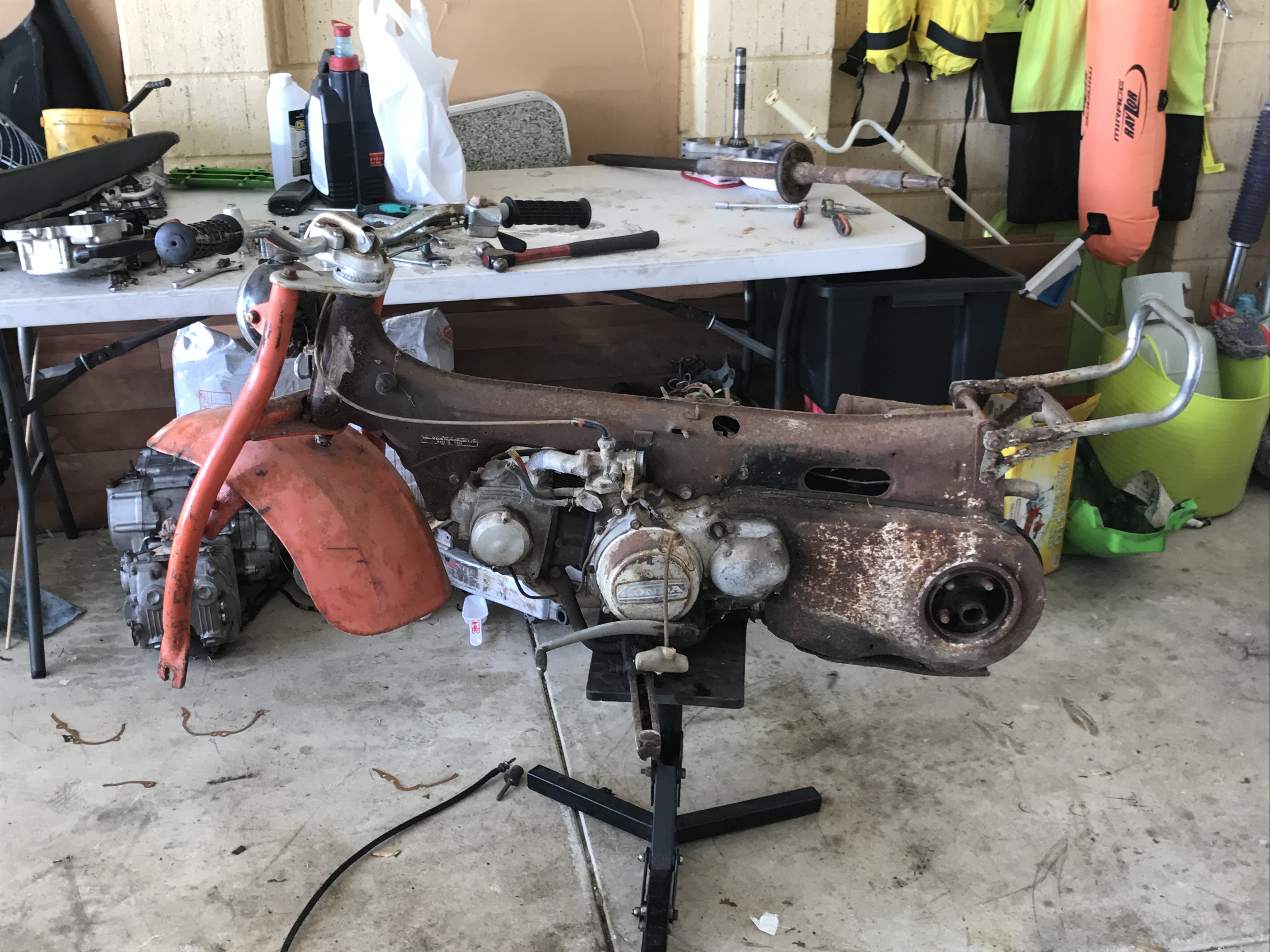

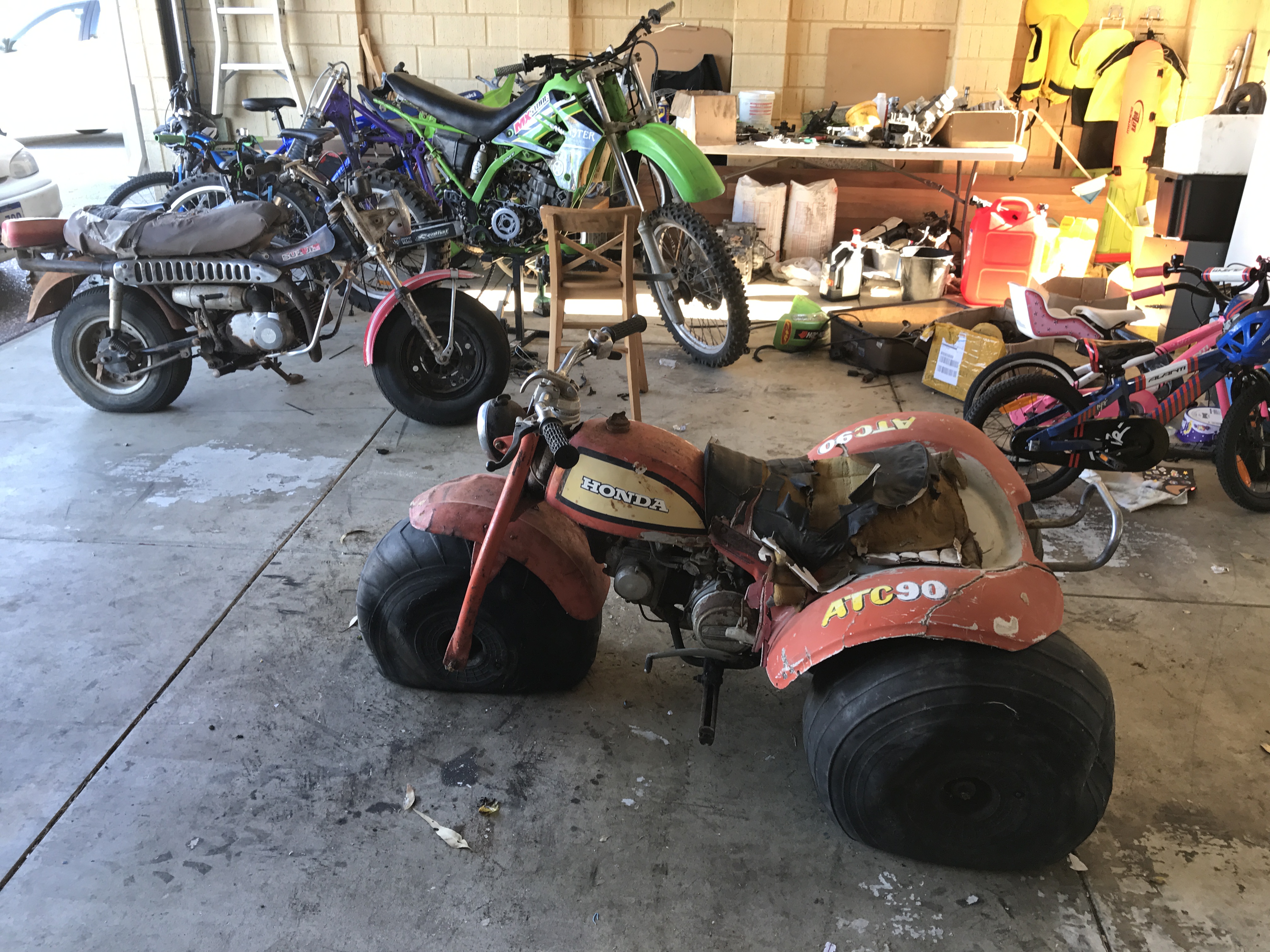

Tear down began shes looking rougher by the bolt.

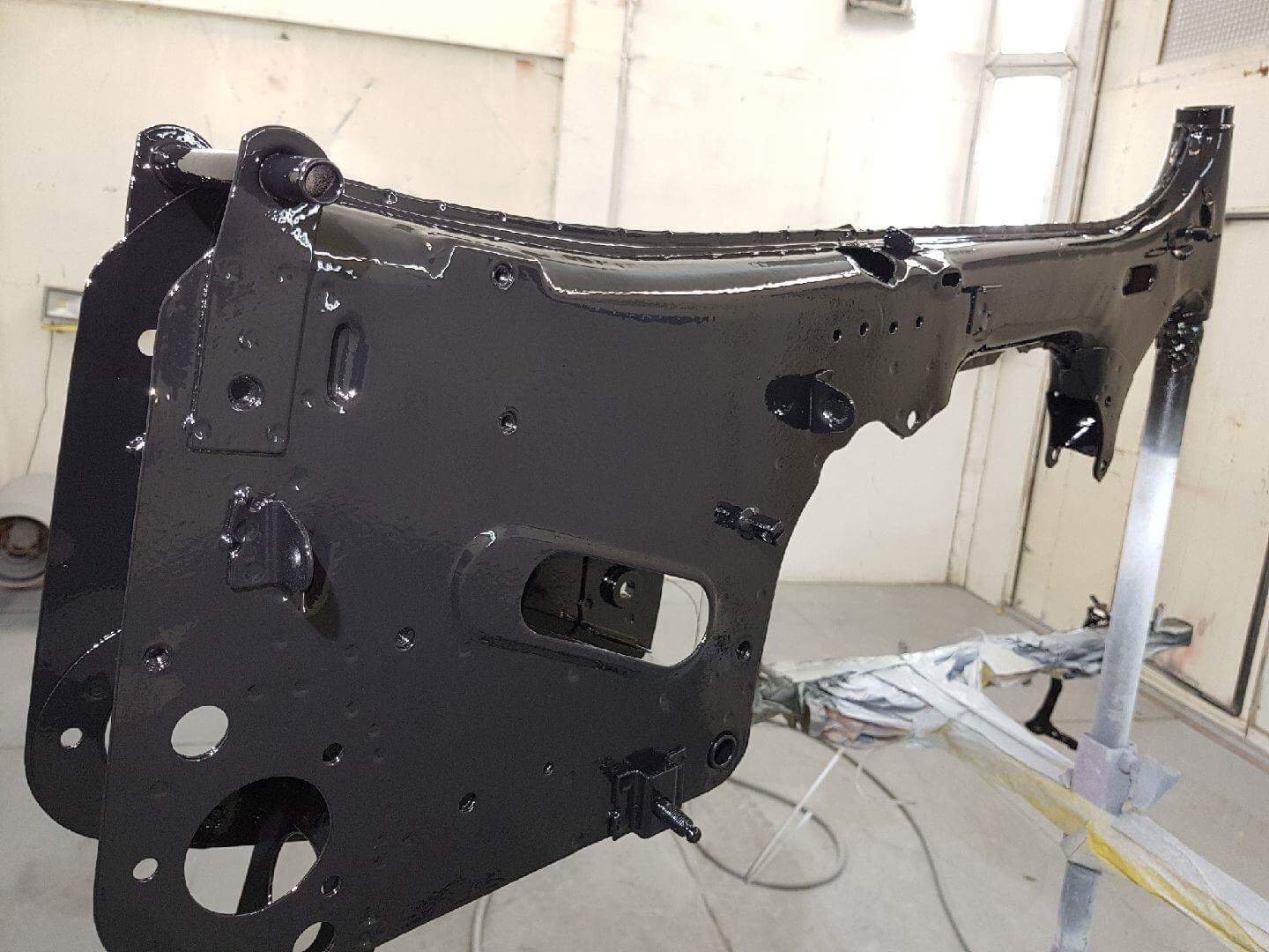

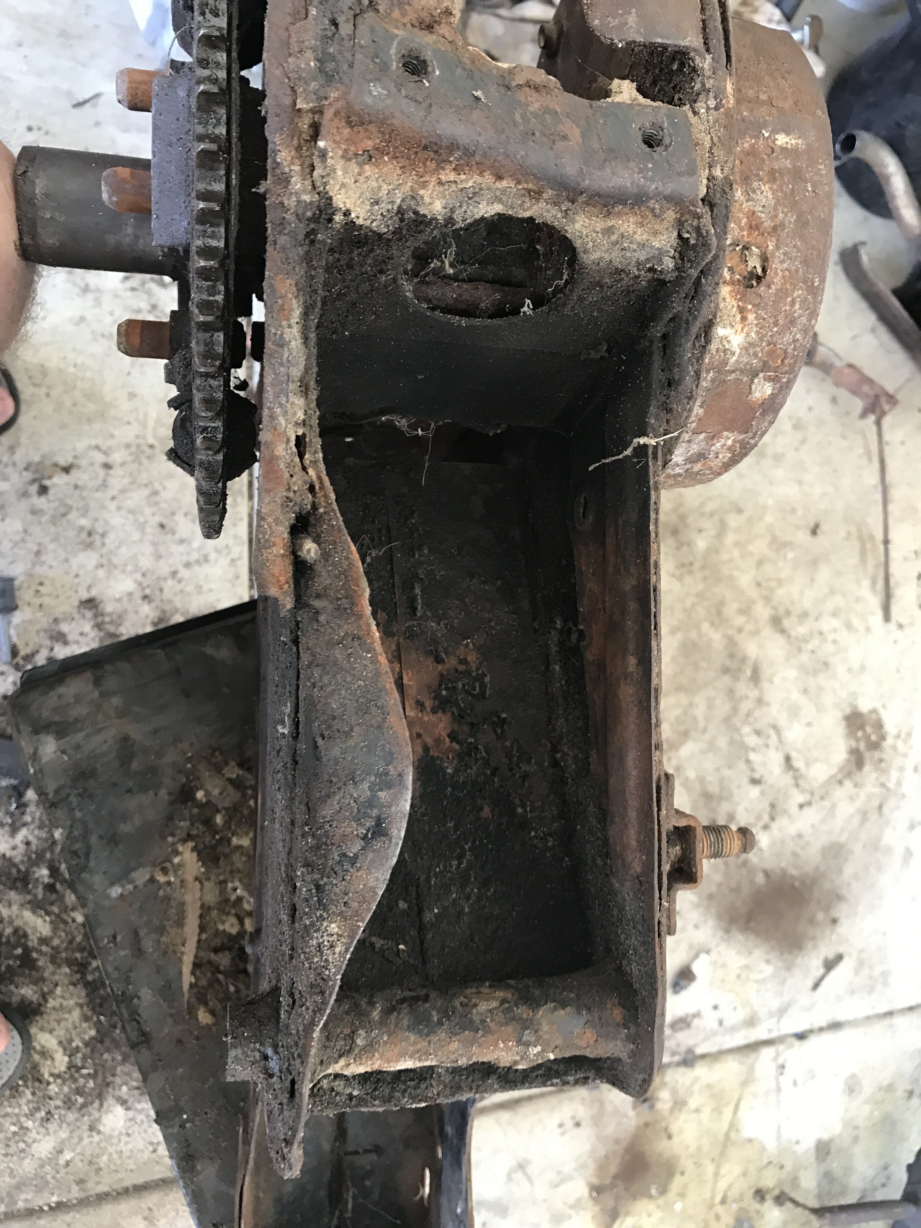

down to a bare frame

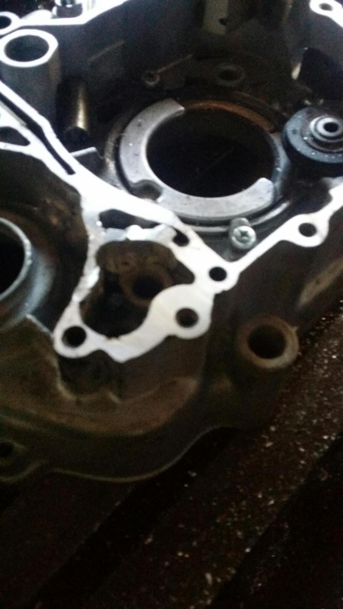

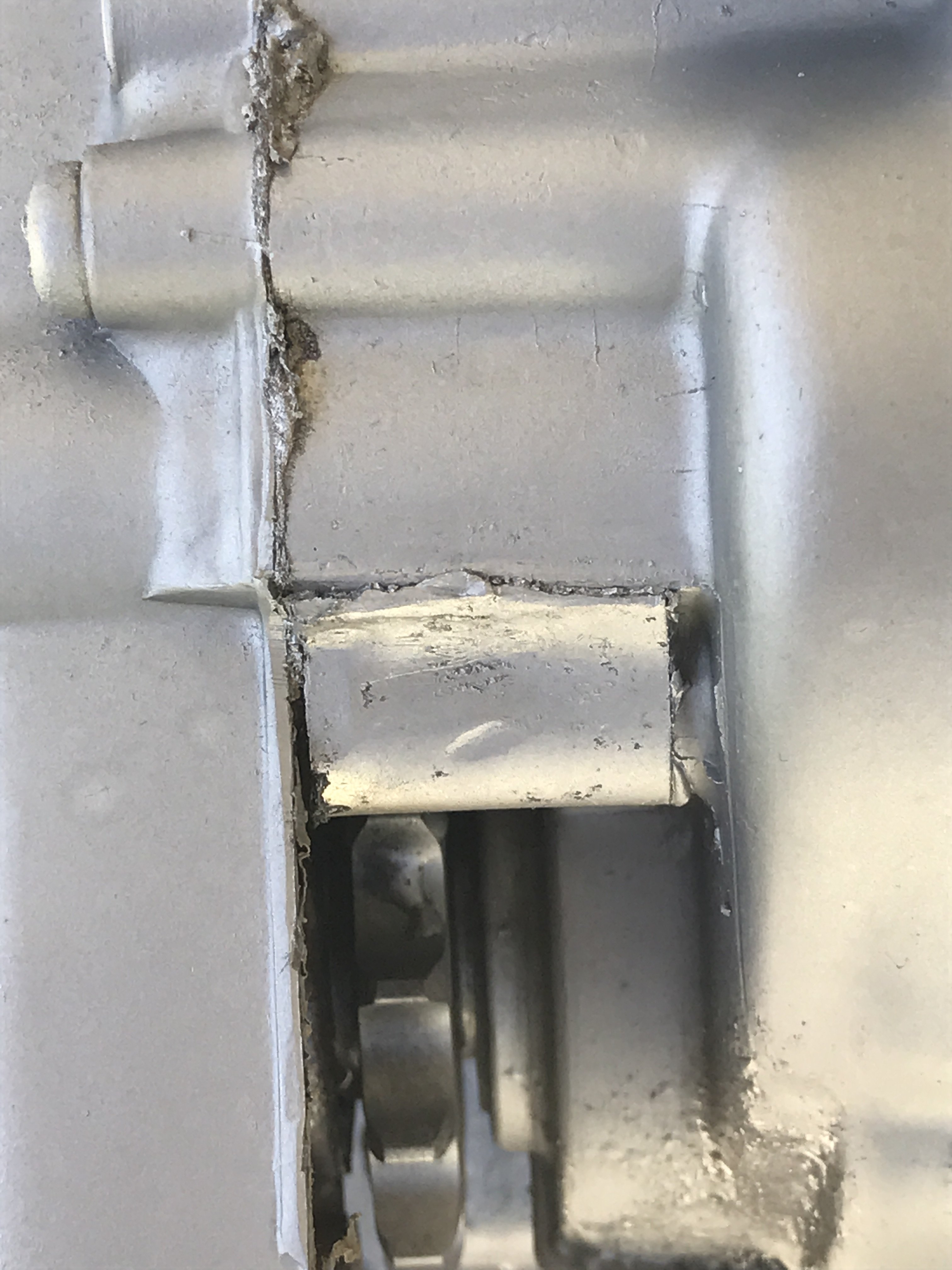

looks like he PO spat a chain, a nice little hole in the case. I found degreasing and a light coat of UHT shows a few hard to see potential issues

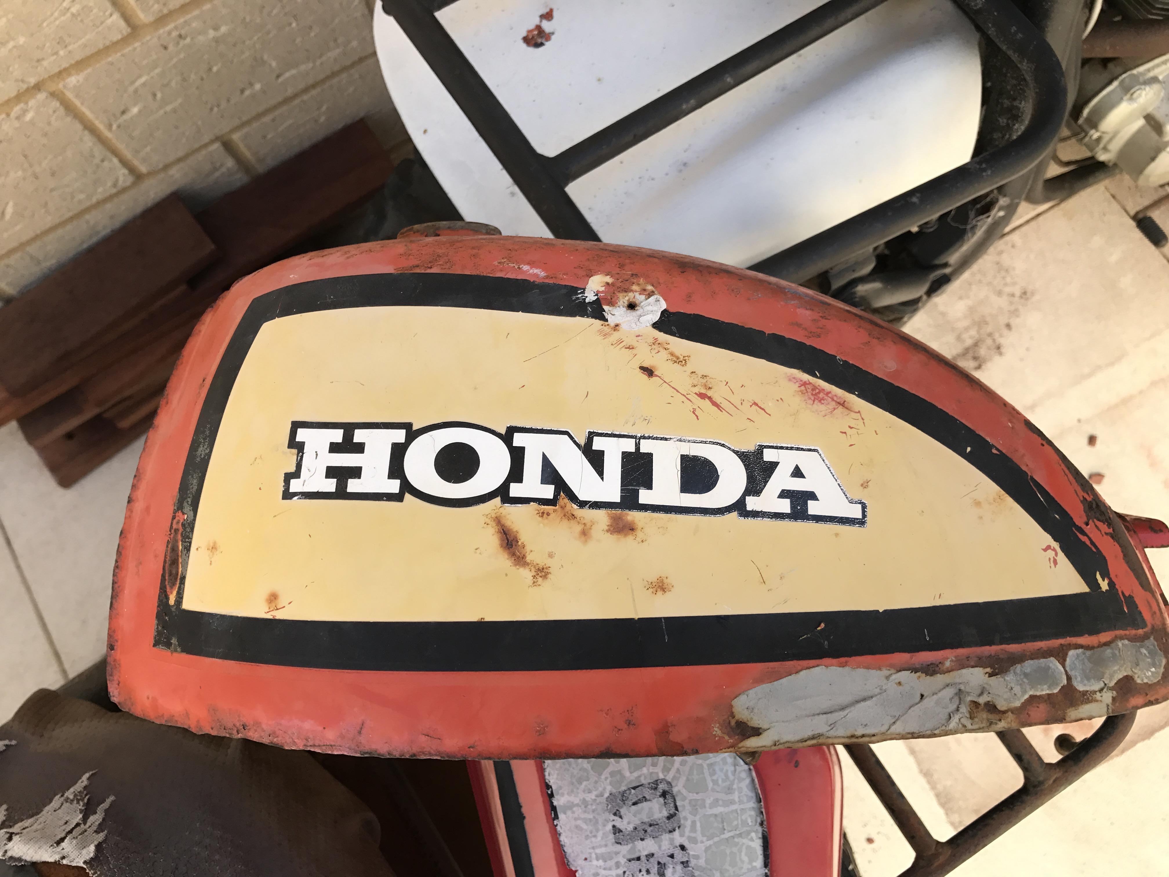

Top of tank was rusted through and a write off, the bottom seam also had a rough repair

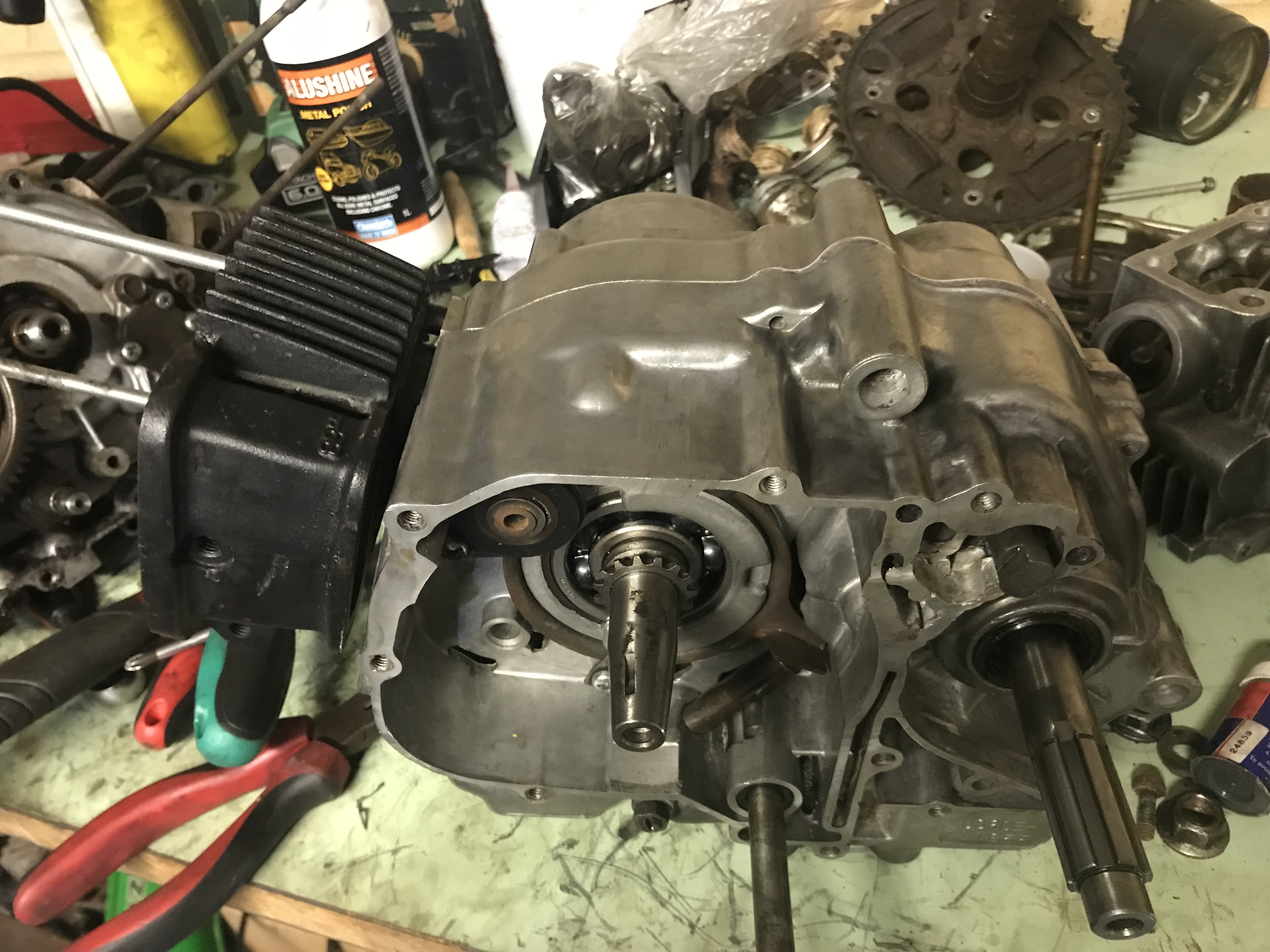

its like Christmas, a new bottom end (nothing wrong with old one but owner wanted full new rebuild)
Note the case in the background, is a new left side case i purchased and was cleaning to replace the cracked one.

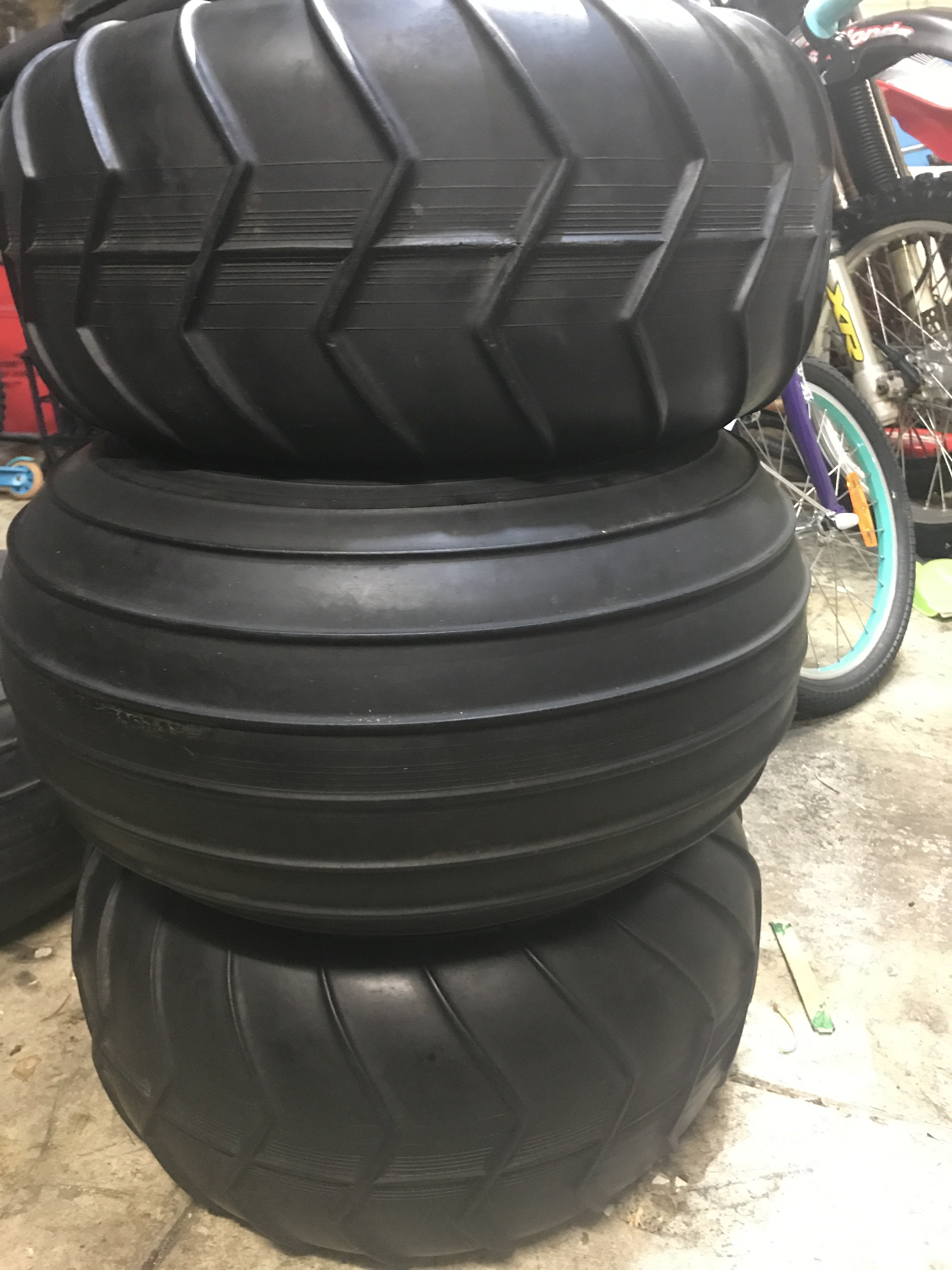

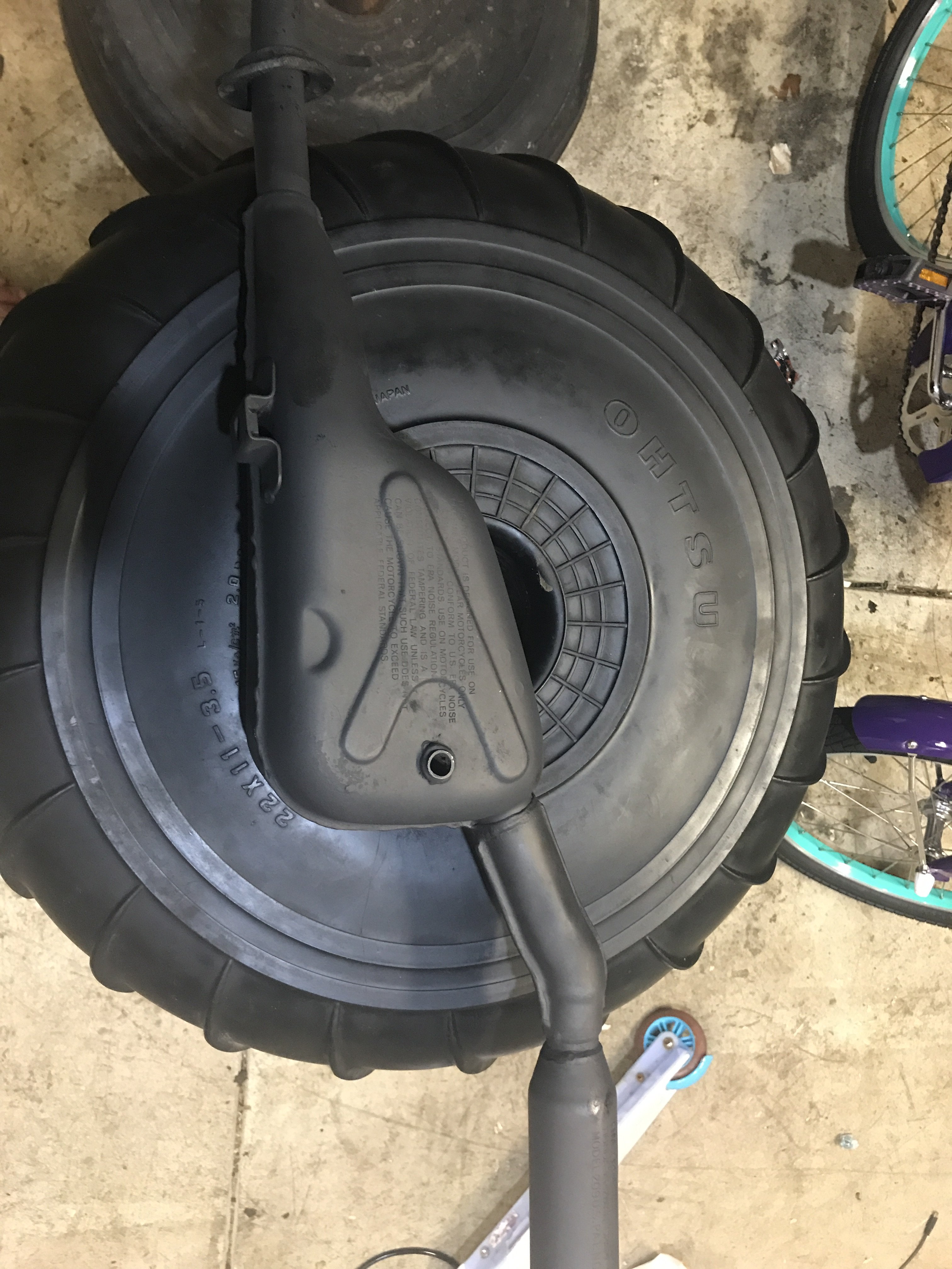

oooo look i found some 40 year old tires in good condition, well all bar one had a small rip in a seam. only $1000 a tyre what a bargain
oh and the exhaust was shot on the original so happened to find a near untouched one as well.

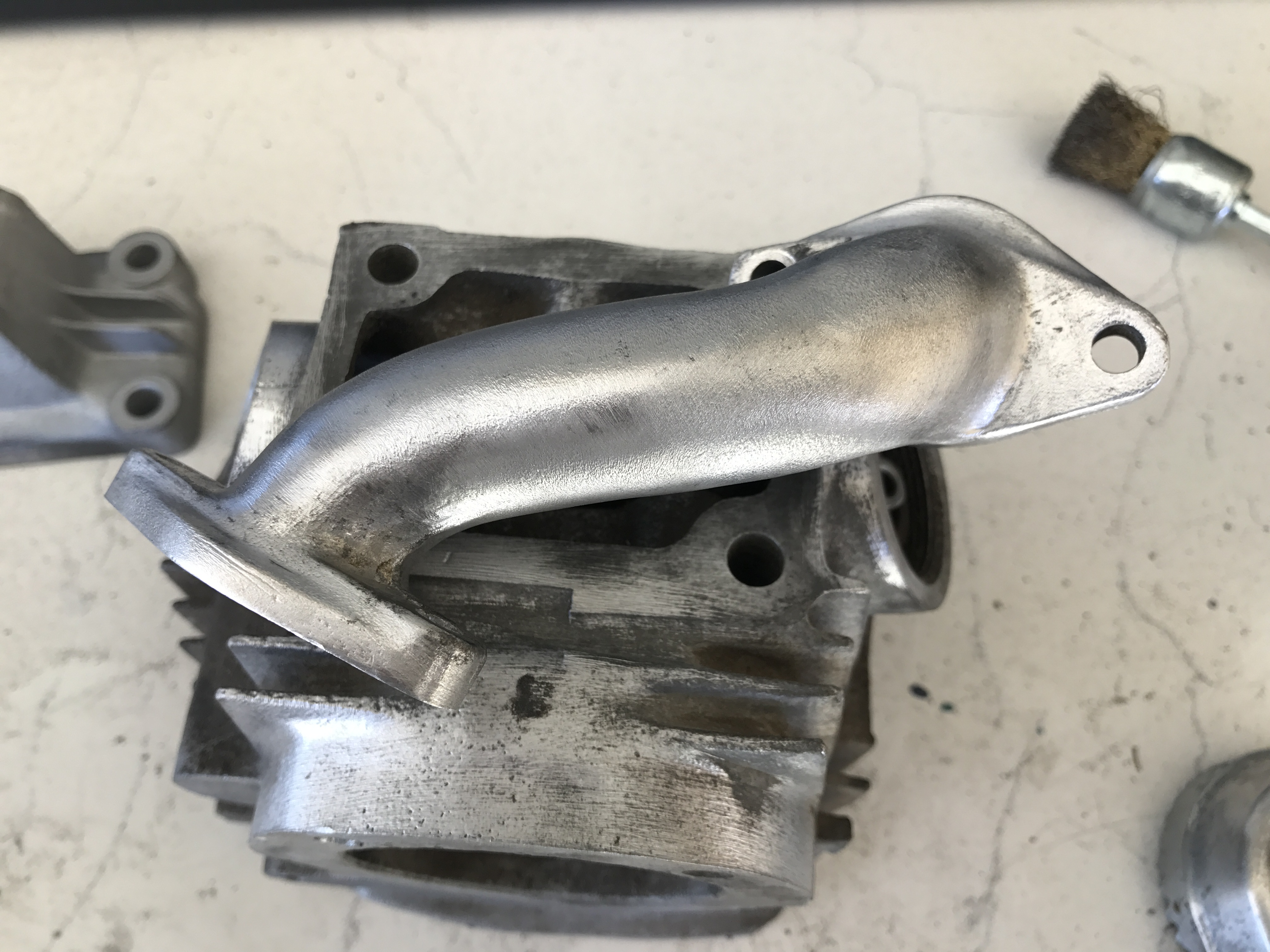

cleaned the cases and started polishing, having trouble getting the finish i want on them am thinking of trying soda on them then a polish, the intake came up pretty good, now the head, Im going to need to bead blast it to get the old scratch marks out im thinking

Looks like this one sat on the beach for a bit too long  :o
Nice find on the tires!
Also fair warning that aluminum will oxidise pretty quickly even with a good polish, which is why I choose to paint.
