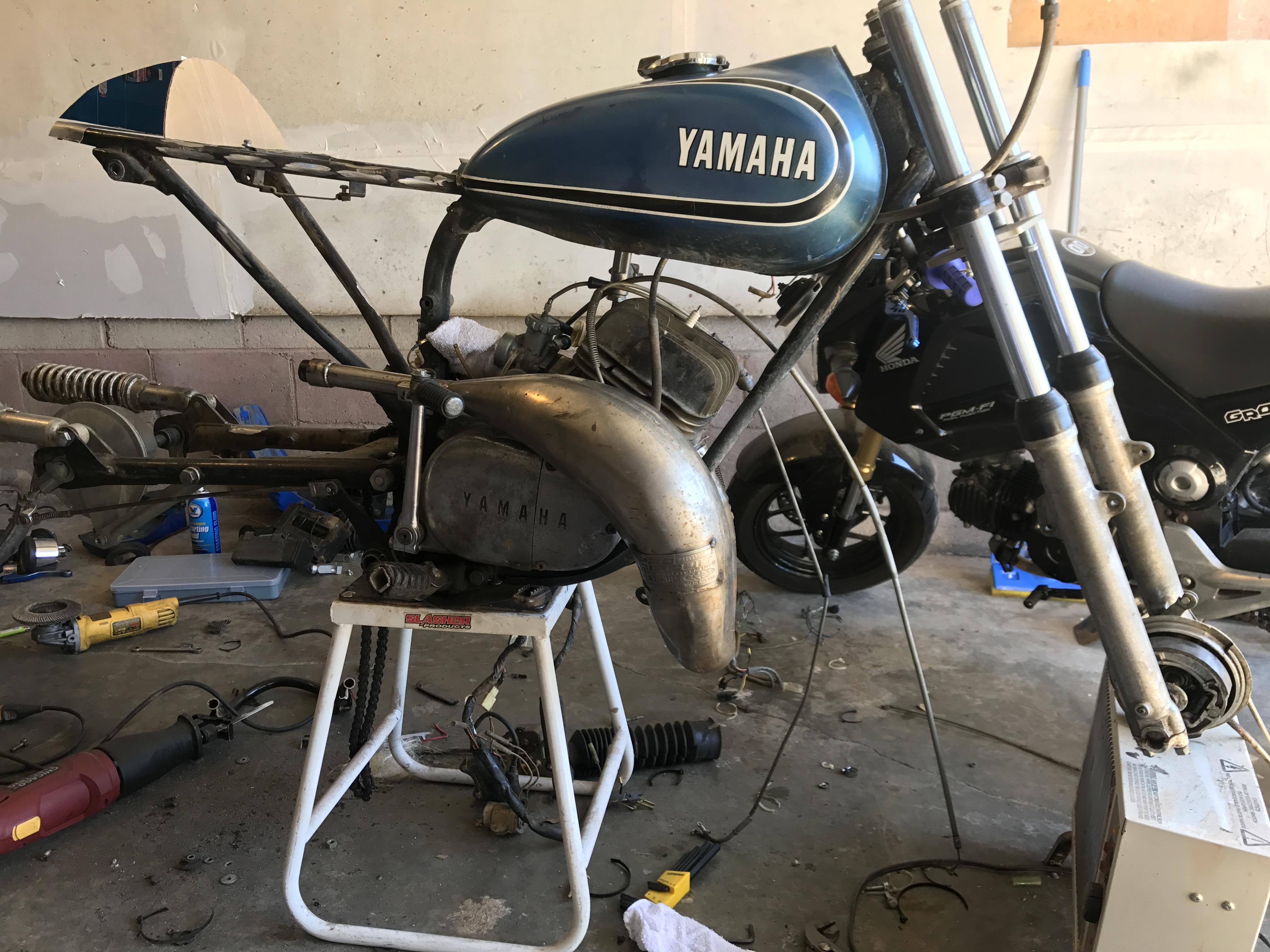

This is where I started to tear down, I was trying to figure out what I wanted to do with the rear cowl and that wasn't it lol.

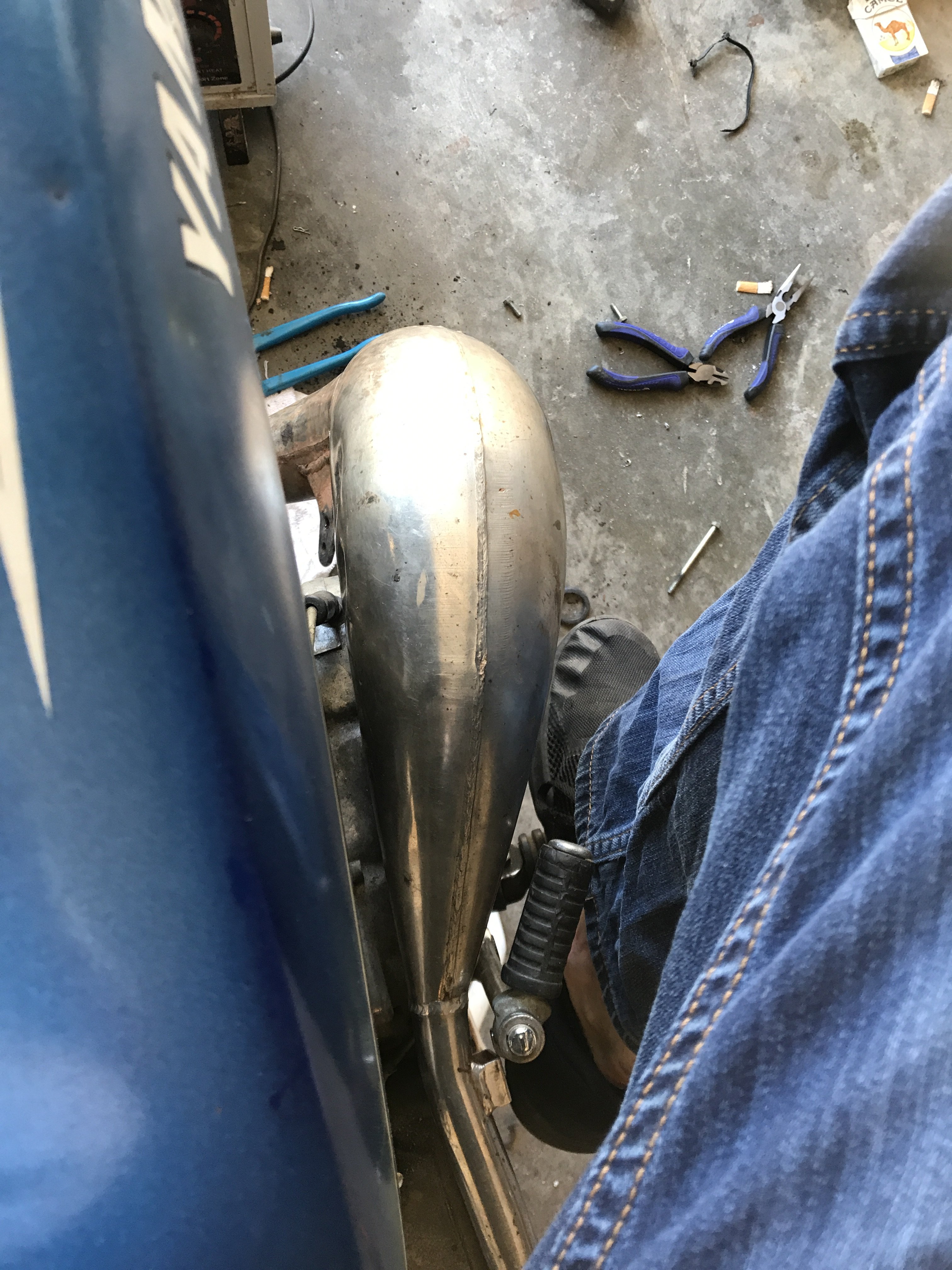

And where I got the yz125 expansion chamber to fit, It fits pretty well.

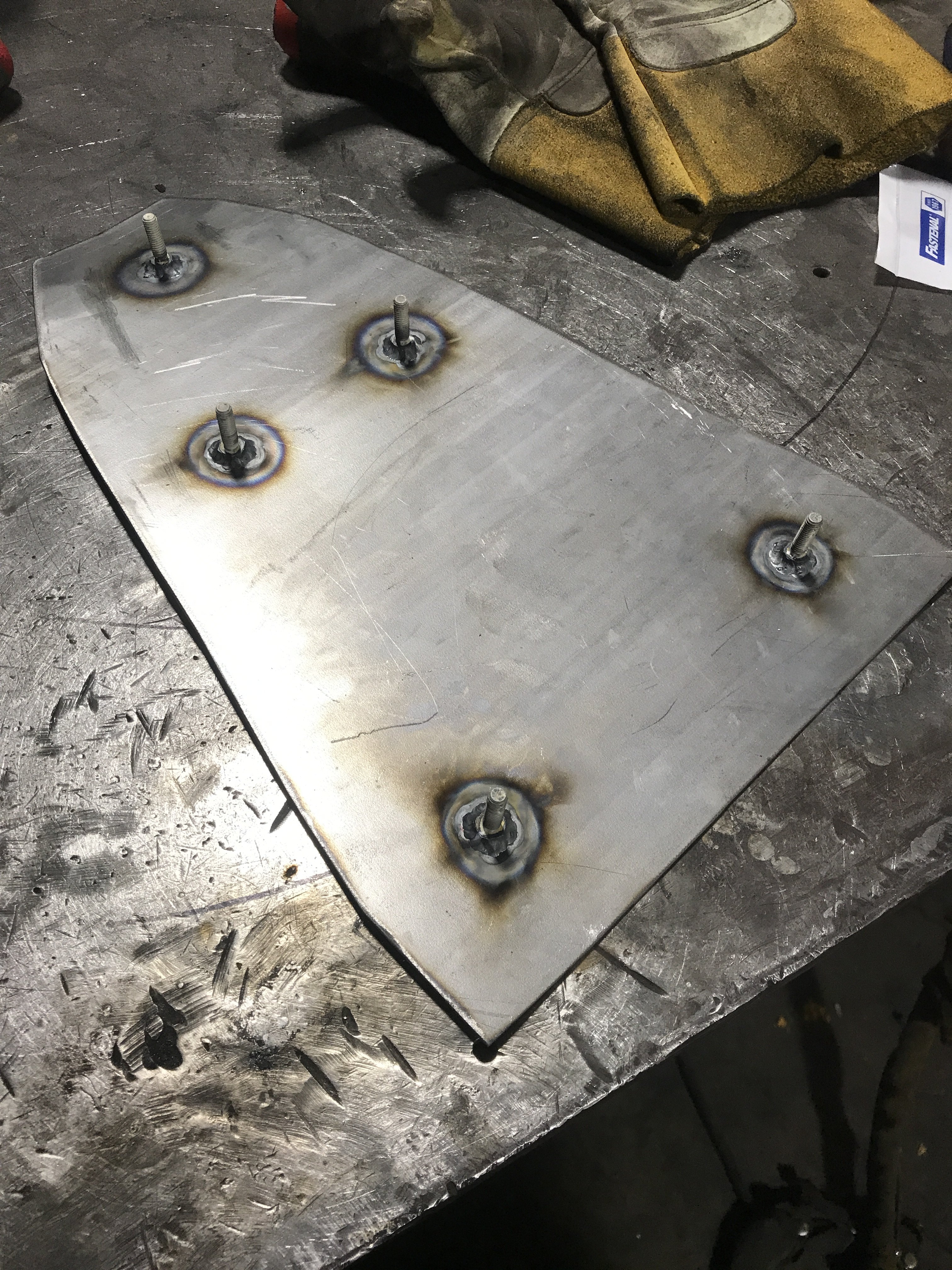

Seat pan

« Reply #6 on: Mar 06, 2018, 18:32:26 »
Seat pan part 2. I don't know why it keeps rotating my pictures.

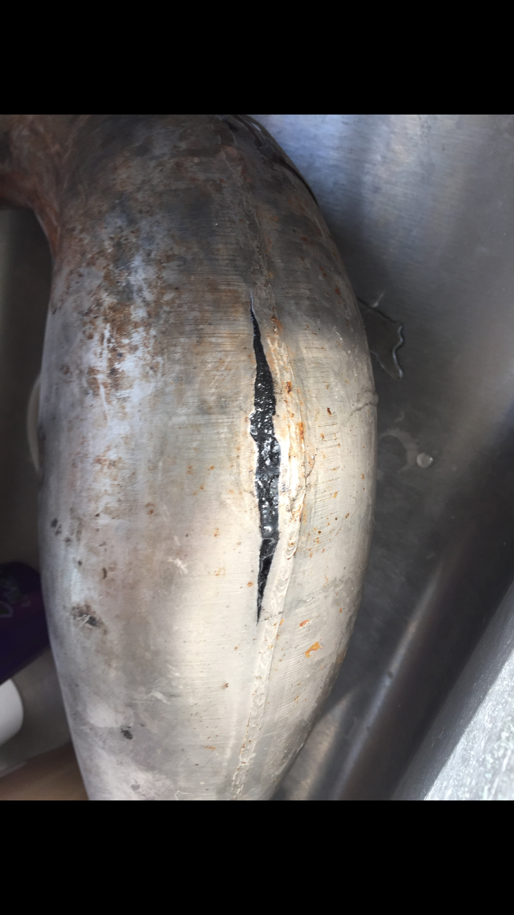

The expansion chamber had quite a few dents in it. I tried to freeze them out which worked on the bigger ones, but the small ones are still there. It also split my pipe which sucks but I'll weld it up and when I know the engine runs well with it I'll buy a brand new one.

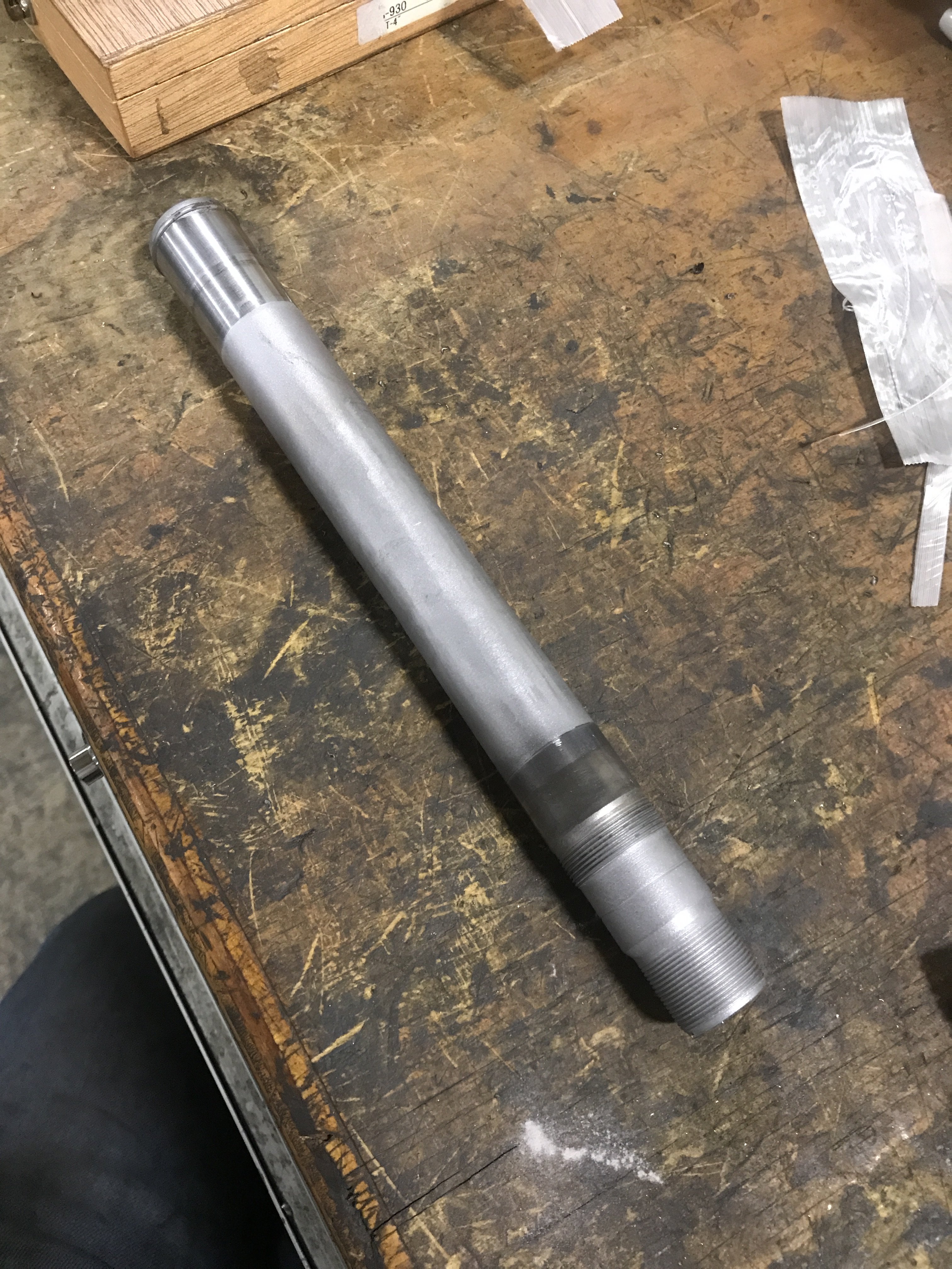

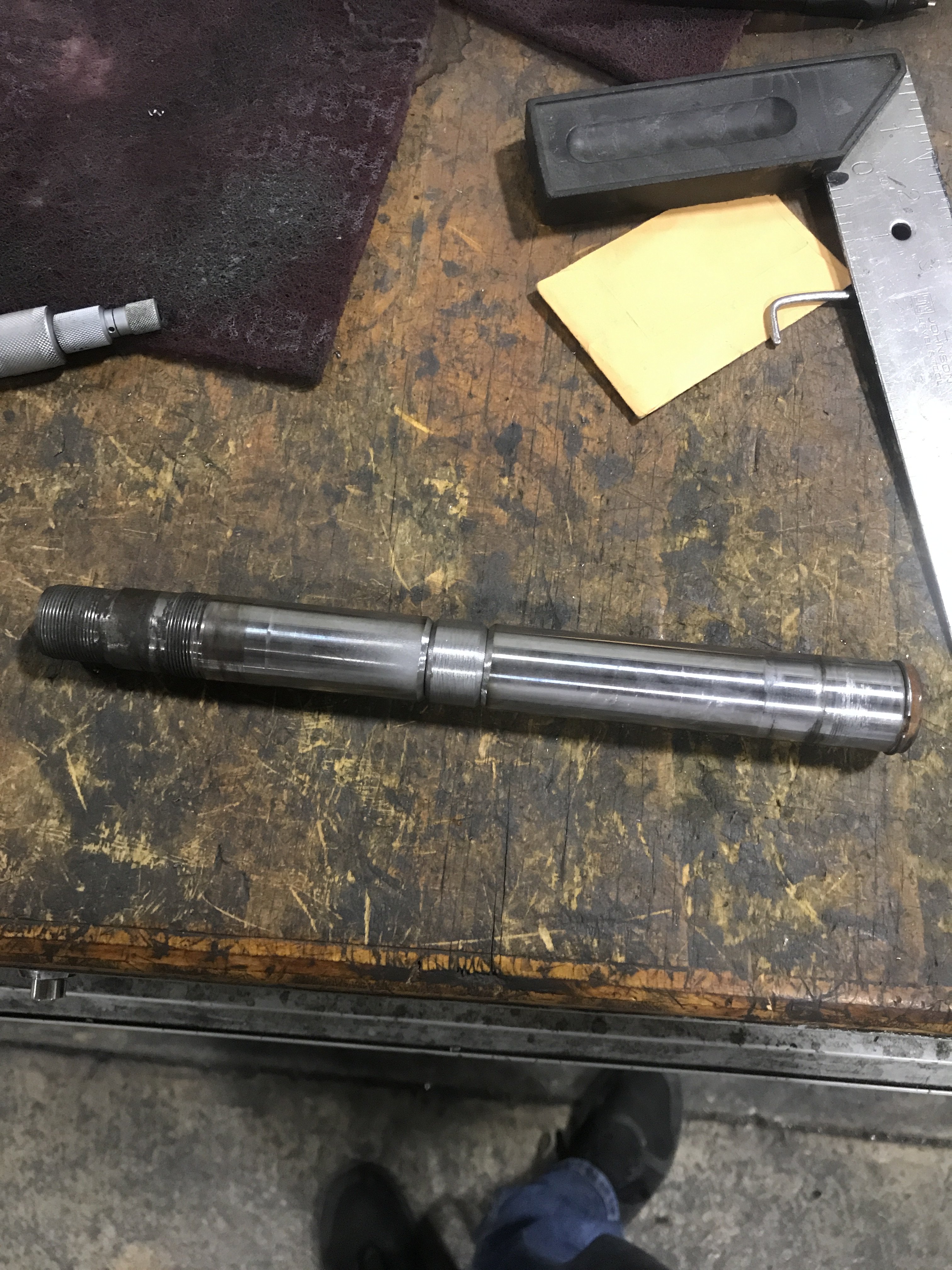

The yz85 steering stem was 1/2" to short as you can see here.
