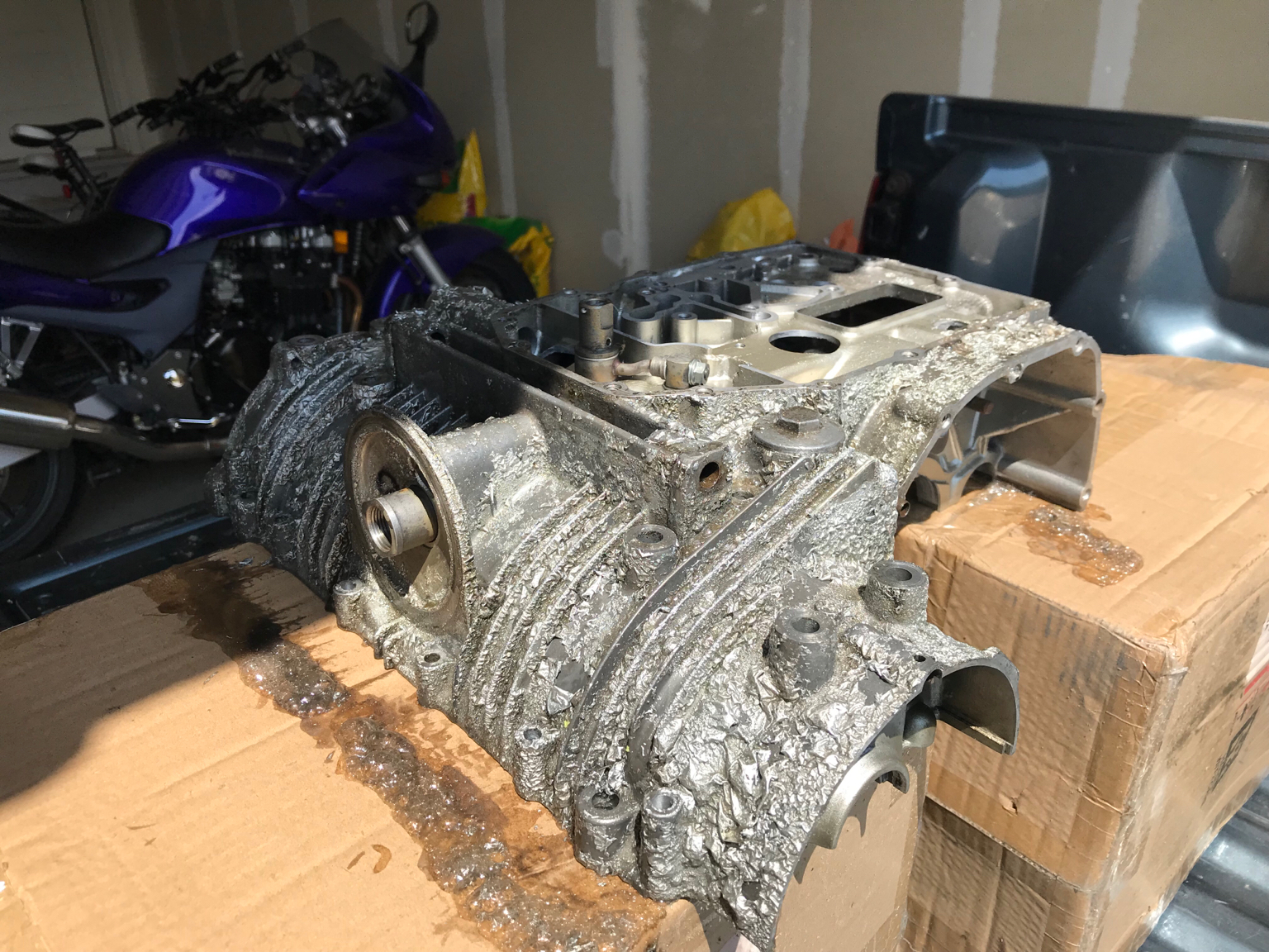

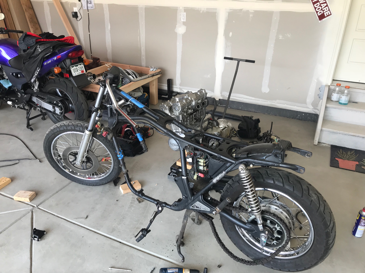

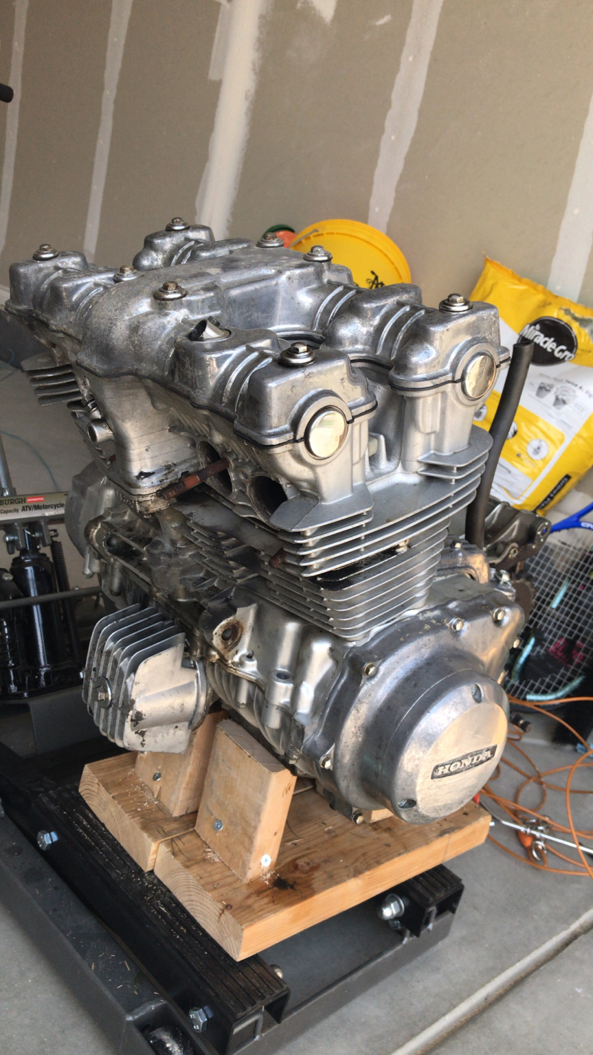

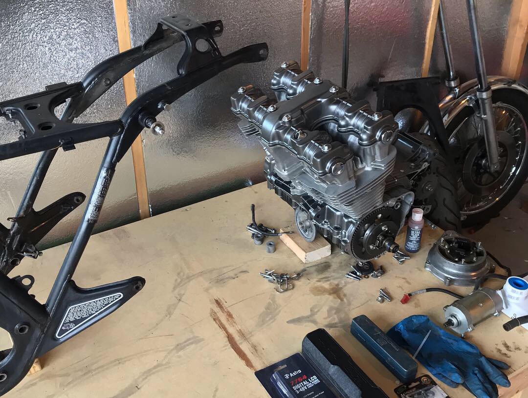

So I finally got around to pulling the motor and building a work table.
1979 Honda CB750L

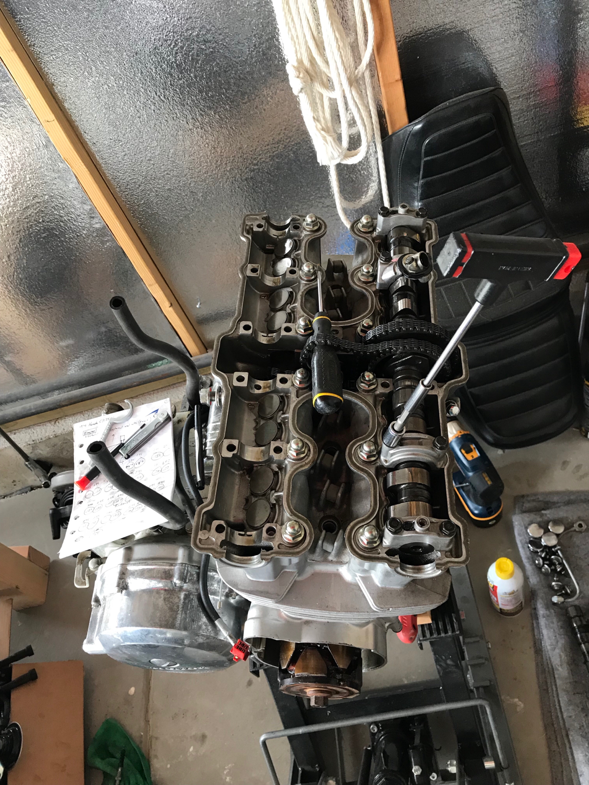

« Reply #5 on: Jun 24, 2018, 18:53:31 »

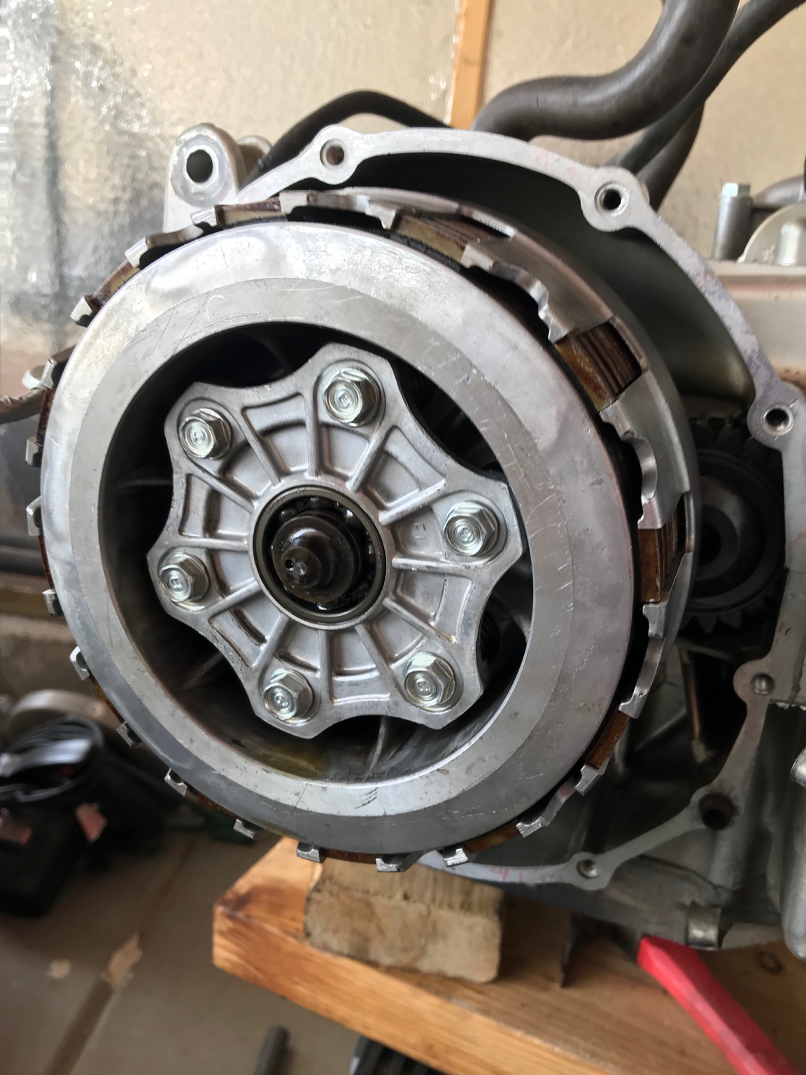

Starting to pull it apart.
1979 Honda CB750L

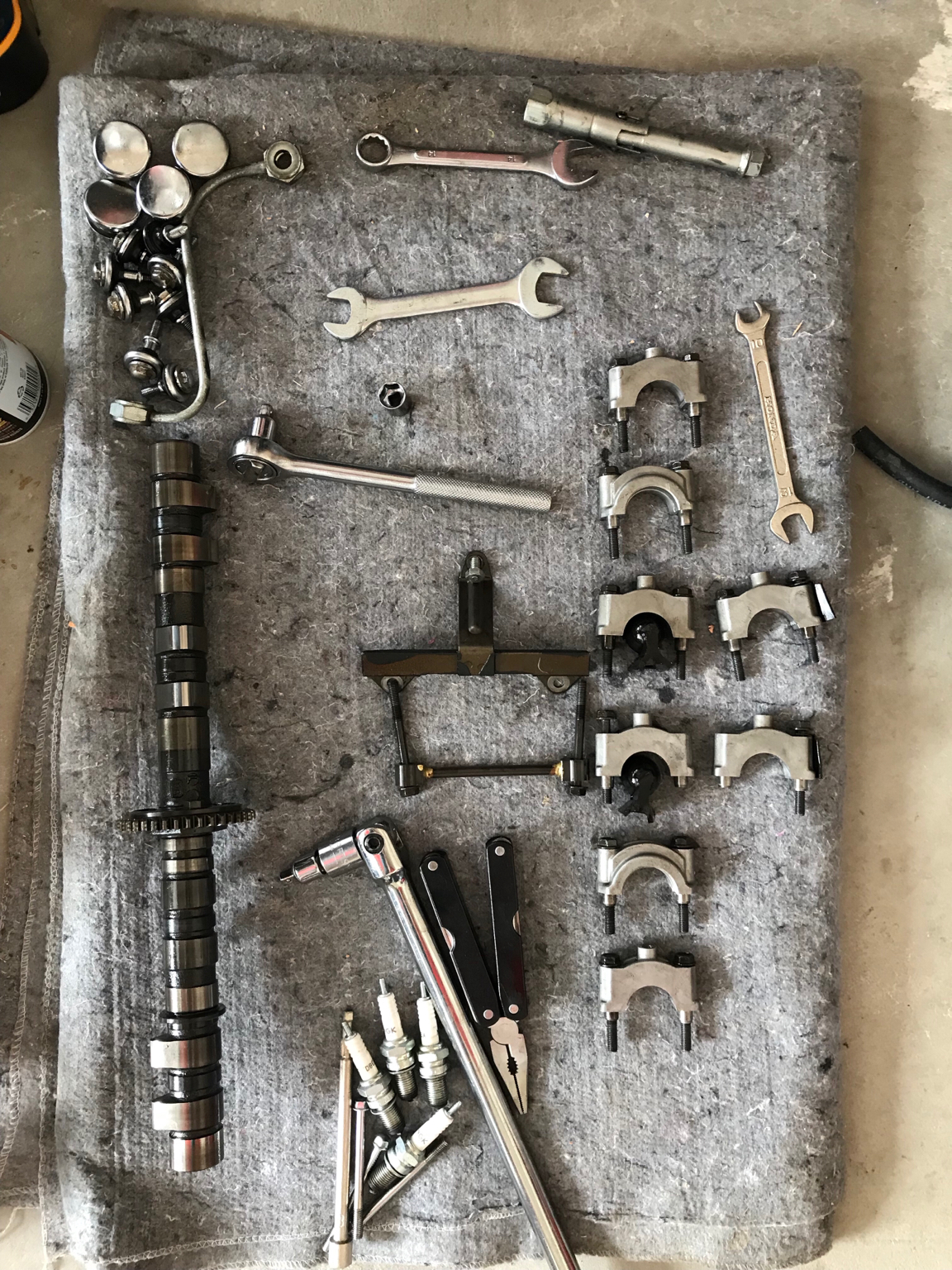

Offline V10Pilot
  • Posts: 62
    • My YouTube Channel
Re: 1979 CB750L. My first cafe/brat project. Denver Area

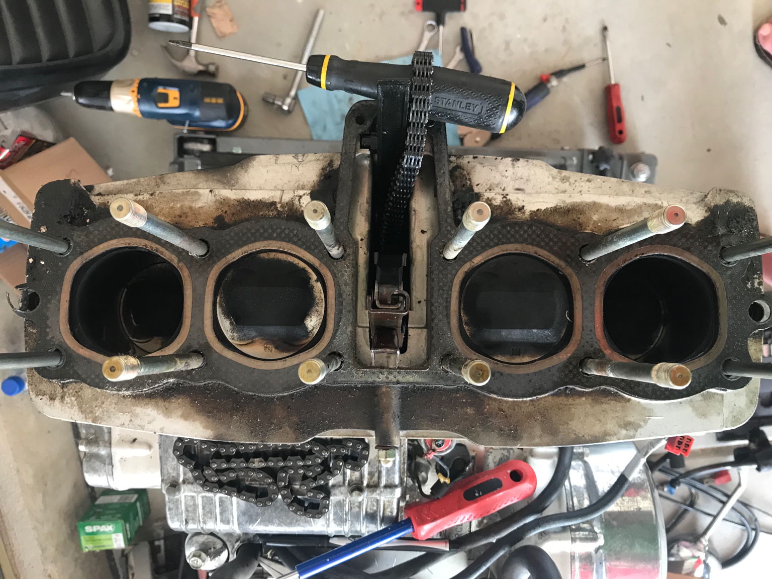

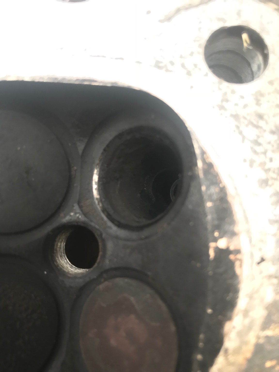

« Reply #8 on: Jun 28, 2018, 10:53:50 »

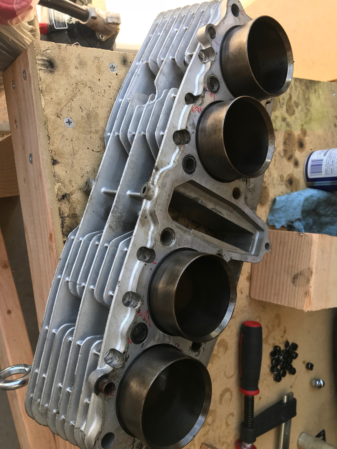

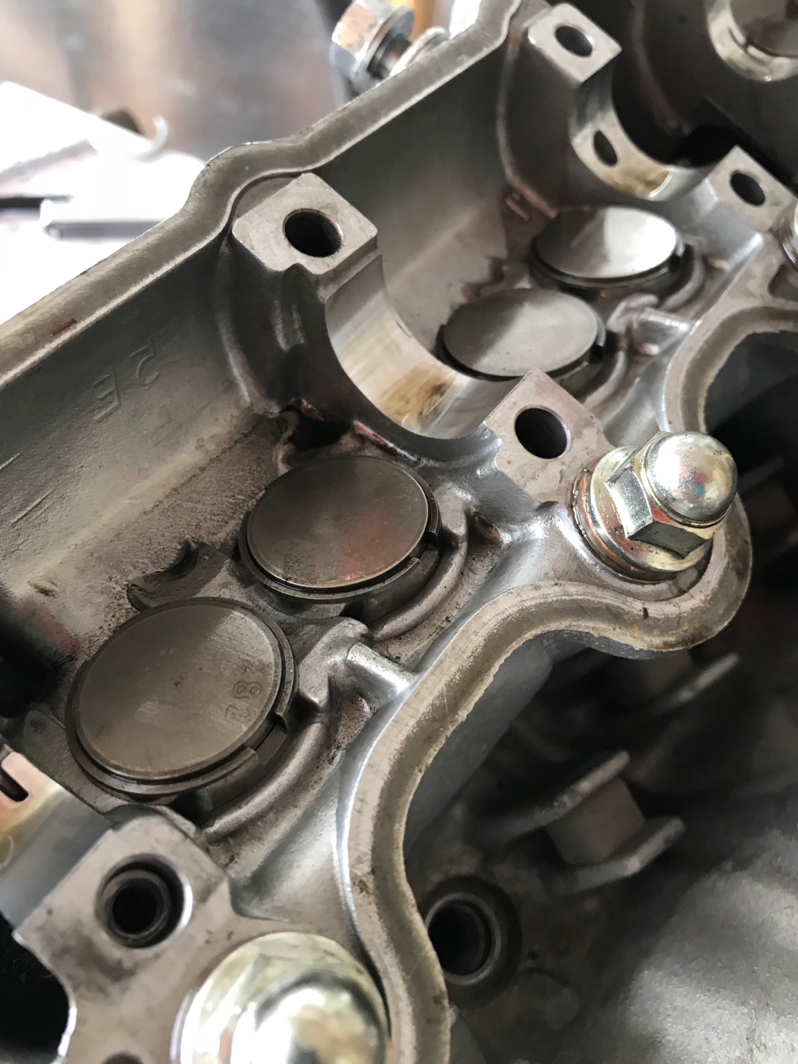

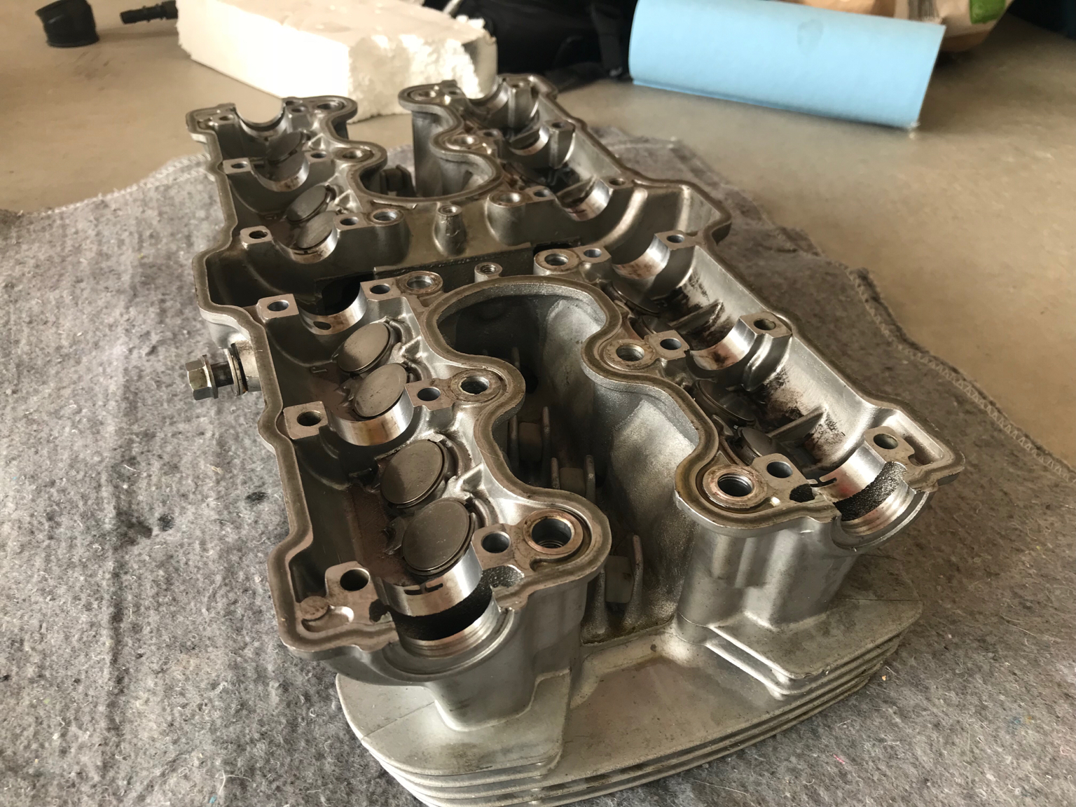

Head is off and time to clean and lap the valves. There is so much crap in the seats itís no wonder the best I was getting was 125psi. The tensioners still have a little flex but may as well replace the 40 year old plastic while Iím in there. Are you Honda guys using factory gaskets or going with a modern brand during reassembly?
1979 Honda CB750L
2001 Kawasaki ZR-7S
Offline Maritime
  • Posts: 9539
« Reply #9 on: Jun 28, 2018, 11:54:43 »
OEM for head and base, aftermarket for all the rest is usually fine.  That's the rule on liquid cooled anyway like my GL1000. I paid the price for Honda Head gaskets and bought a full gasket kit to get all the o-rings and valve cover gaskets and seals needed.
