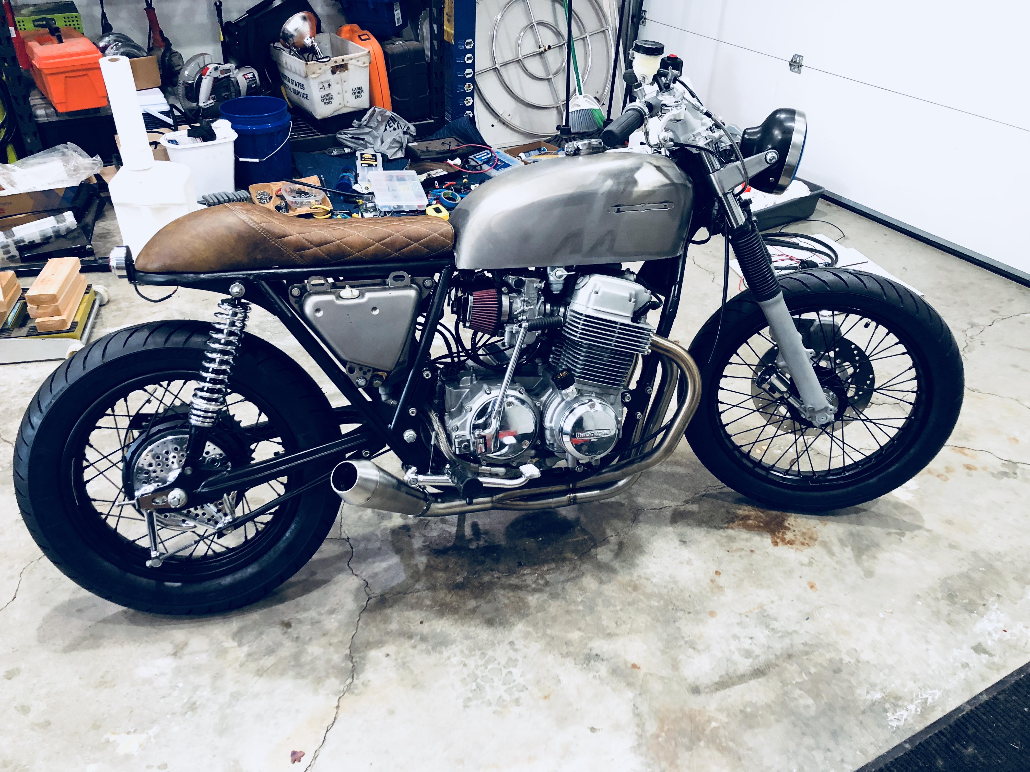

I just received my motor back from Cyclex (great guys to deal with) managed to unload and install it in the frame with a friends help. But now my back is screwed and I will have to let it sit a few days so I can recover.
Motor is now a 915cc

Looks great!
I'm looking to do my rims the same style as yours, all blacked out. What finish did you use on the spokes? paint or powder?

I had the wheel sandblasted then used VHT roll bar paint in matte, same on the frame.

how durable have you found the paint to be? I'm about to do the same to mine and am a bit concerned over the durability vs powdercoat

I had the same concern but so far no problem. I am having the tires installed this weekend and I let you know how they hold up.

That 915's gonna be a rocket ship.  I'm on board.  Also curious what your take is on cost vs. end result on Cycle X.  Specs on the work completed?

Here is the parts list and machine work, I know in advance it would be expensive.
Parts List
•   Connecting Rods: Cycle X Super Rods (ENL-001): $525.00
•   Connecting Rod Bolts and Nuts: ARP Upgrade: $99.00
•   Primary Chains: Cryo Primary Chains (ENV-004A): $119.95
•   Cam Chain: Cryo Cam Chain (ENV-012A): $139.00
•   Primary Tensioner: (ENV-005): $125.95
•   Clutch: Clutch Plates (ENL-014): $49.00
•   Ignition: Power arc Ignition (EL-012): $349.00
•   Piston Set: 915cc Pistons (Armor Glide Coated) (ENP-915): $559.95
•   Camshaft: CX3: $227.00
•   Camshaft Sprocket: OEM Adjustable Camshaft Sprocket Combo (CS-017B): $49.95
•   Valve Springs: ENV-026 - Bee-Hive Valve Spring Kit - $239.00
•   Cylinder Studs: Super Stud and Heavy-Duty Stud Nut Combo (ENV-CXC): $165.95
•   Magnetic Oil Drain Pug (OL-017): $23.95
•   Valve Set: Super Flow Valves (ENV-015): $149.00
•   Valve Guides: Cast Iron Valve Guides (ENV-CIG): $99.00
•   Gasket Set: Gasket Set with MLS Head Gasket (ENG-001): $199.95
•   Carburetors: Mikuni RS34mm (CA-000): $725.00
•   Cam Chain Tensioner: (ENV-006A): $139.00
•   Main Bearings (ENL-016): $139.00
•   Rod Bearings (ENL-013): $99.99
•   Misc. Hardware/Shop Supply: $100.00 (
•   Carburetor Rubbers: $89.00
•   Oil Pressure Gauge (OL-014): $59.95
•   Clutch Shims: (ENL-024): $12.95
•   Mikuni Filters: $89.99
•   Balanced Rotor: $59.00
•   Oil Filter: $3.99
•   Titanium Rocker Arm Jam Nut Set (ENV-321): $49.95
•   Rapid Fire Exhaust: $549.00
Parts List Total $5237.47
Machine Work
•   Bore and Hone: Big Bore Cylinder Work (900cc and above)
Includes: Glass bead cylinder, remove sleeves, surface bottom of block, bore and hone block and install sleeves, surface top, bore and final hone: $375.00
•   Head Option: #4 Head Option (Ported): $775.00
•   Crank: (Stock Weight) Balancing (Deluxe Version): $199.00
•   Transmission: Pro Cut Race Transmission (ENL-011-PRO): $385.00
•   Chain Wheel: Chain Wheel Rebuilt and Balanced: $250.00
•   Rebuilt Oil Pump: (OL-086): $86.95
Machine Work Total $2070.95
