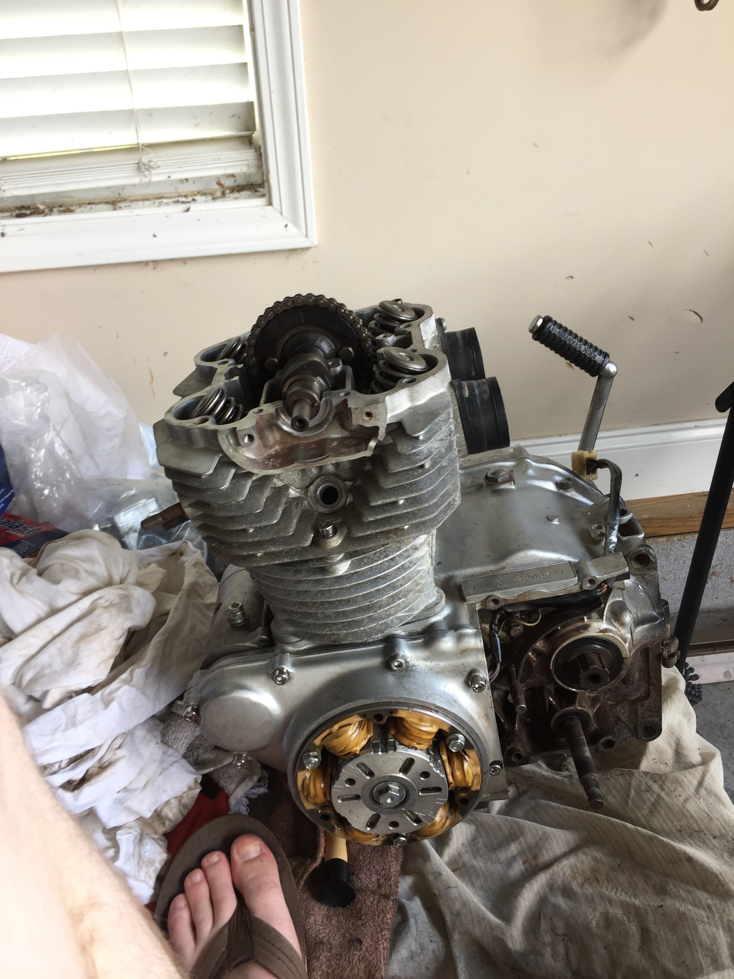

Here is some pictures of the bike in its current state in case y’all wanted to throw some opinions at that too Haha

In the first pic, it appears that your cam chain is all the way at the edge of the tensioner. This is likely due to the missing thrust washer. The thrust washer takes up the slack from a small gap at the end of the cam. You should've had to remove it along with your cam. But, as PJ would know better, this may have been a service bulletin and not originally installed at the factory. I can't remember. Pretty sure he's suggesting that it's possible that the bolts or some part of the cam mount for the cam sprocket is hitting the head.
