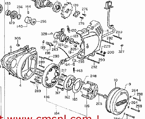

Alright very late post. The headers that came with the bike do not seem to be the correct headers. Or maybe the flanges that came with it are not correct, as they donít hold the headers on (havenít noticed this as I havenít even looked at them since I got the bike itself). But here is a bunch of pictures of the bike now.
Offline MiniatureNinja
  • Posts: 378
Re: Cb360 Reassembly Help
« Reply #34 on: Jun 25, 2018, 01:24:30 »
there is a two piece collar that the flange butts against to hold the header in place
part 2 on the diagram
