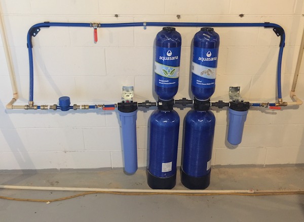

Rach made me install a whole house filter system, which entailed re-plumbing half the basement.
As, its on the opposite end of the basement the softener was.  And now that the softener is gone.  Had to patch up all that stuff.    :P

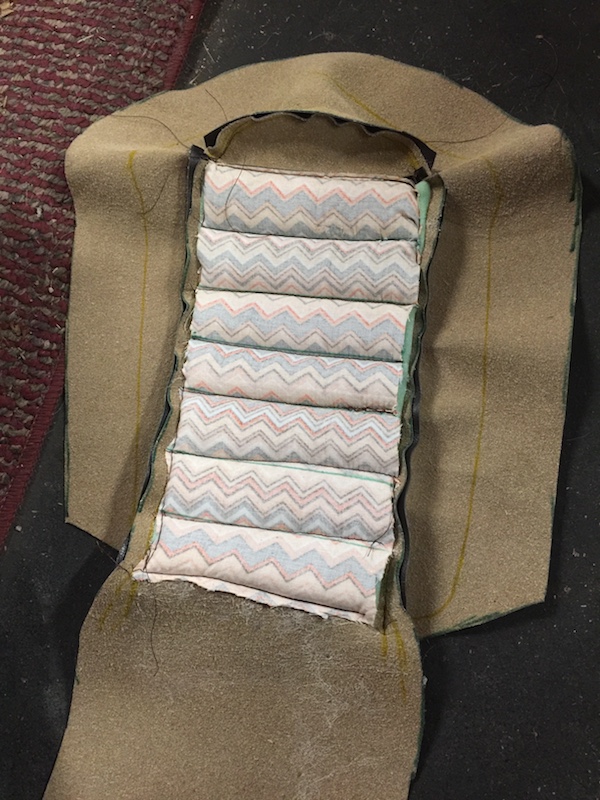

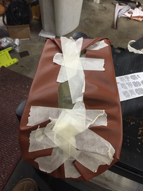

Than advCo "CONNED" me into making a custom seat cover for him.   ;)  ( my 3rd time ever in front of a sewing machine )
But you just cant say no to the dude, he's just too dang good lookin'.  ;D
BTW, this cover burnt me on sewing custom seats....WHAT A FRUSTRATING BITCH and NEVER EVER AGAIN!!!   >:(
I just loosely half assed the fit w tape.  Leaving the stretching and CREATIVE STAPLING for Nick.

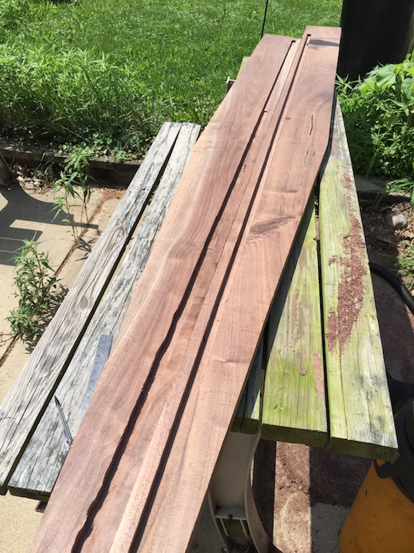

The first 9 footer went pretty damned great.  The second one started out shaky and only got worse.

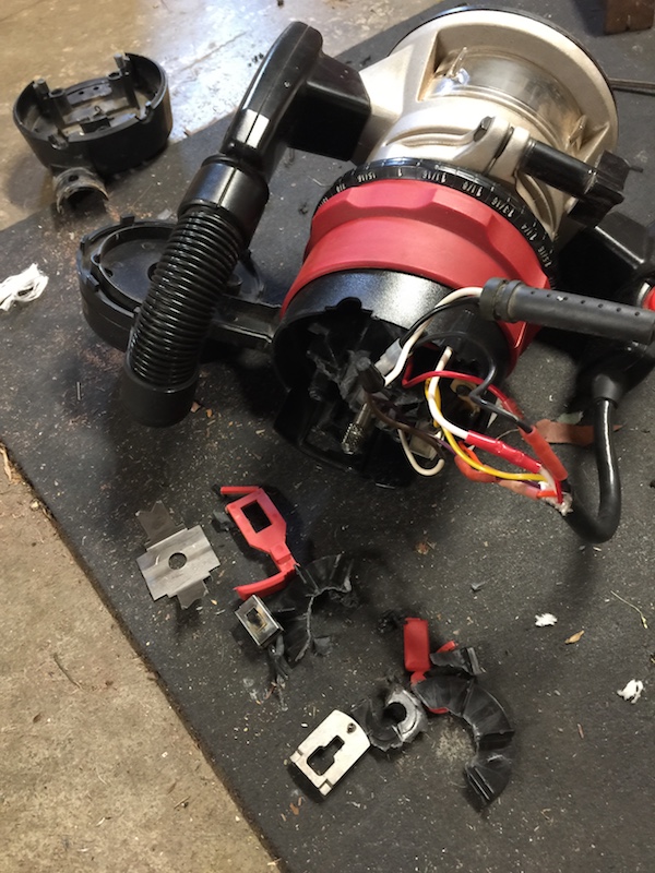

The blade had slipped in the chuck.  So I tried to tighten...wouldnt budge...loosen...still wont budge....EXPLODED THE FUCKIN MOTOR LOCK!!!
Tore it apart.  Removed chunks of plastic and steel bits.  Cut the locks safe switch out and re-wired.  Got the bit out.
Re-installed and cutting went well after that.  But now its too hot to work.  So hope to finish ALL mortices this evening.
You can see the shaky spots in second board but w some work it will be OK.
May cut mortice a bit over size and glue a shim in then re-cut mortice nice.

Luckly the wiggly parts went below my line.  So I reset my guide board and c-clamps.  The "top" cut is pretty straight and on my line.
So few if any of those wiggles will show.  They are on the underneath of work deck.  Ill just make a second pass to clean that up smooth.
Then cut a 3/8x1/2" strip to glue in.  And I will be back on track.

Seat came out great my man, much appreciated. You're a lifesaver. I started removing the POR-15 from the 360 tank last night only a couple more loose ends to tie up now.
Bench is looking great. The hand router can have a bit of a learning curve but its one of my favorite woodworking tools..just make sure that the collet is TIGHT! I hate those motor lock routers, even though using wrenches a pain you know you can get them tight (my old craftsman router mounted to a table would never get tight enough to stop the blade from slipping with motor lock, i think there was some 'give' in the plastic).

Thanks bud,  Iím glad the seat will work out for you.  Post a pic once itís stretched and installed.

Also, Out of frustration the other day, completely brain farted I had to make a second pass on the mortice as my bit is 3/4 and boards are 15/16.
So that in itself took care of most of the wiggle spots.
Anyways I made a short 1/4 run and will add shim and finish it flush and that takes care of the bad routing.
now all boards fit together nicely w just a touch of wiggle room for glue.
