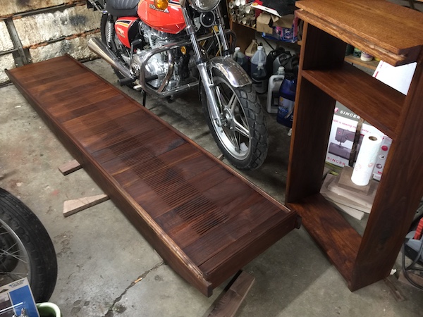

top scored.
Almost forgot the dowels. I think 18 per side w 5 on the end cap.
That Gorilla glue is great for this. The dowels were a TIGHT fit and even still just a smidge still cam bubbling up to the top.
Re: Walnut service bench
Started at 4 a.m with an hour break for lunch and a cat nap. :p
80 -150-220 Sanding done, fit the hardware, dis-assembled for tung oil.
I haven't decided if its getting poly or carnauba wax finish.
The pic looks a bit splotchy right now, as the oil is soaking in and drying.

Re: Walnut service bench, all done but the finishing.
All done but the finishing...castors, tire chock...should be here Wednesday. Thanks Irc for your great ideas. 8)
Along w a small safety prop under the ramp end.
After some reading, Ill do another few coats of oil.
In a couple weeks Tung oil will cure hard. I can then buff it and apply Shellac or just leave it as is.
