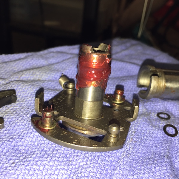

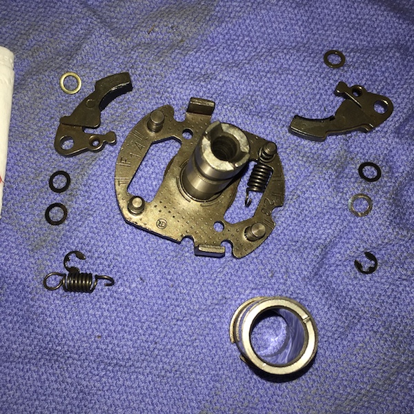

Found my springs, also got a new bearing but not gonna mess w it.
Fresh stuff going in...
Used "Ye ole penny trick" to torque everything w purple locktite on the primary shaft bolt!!!!

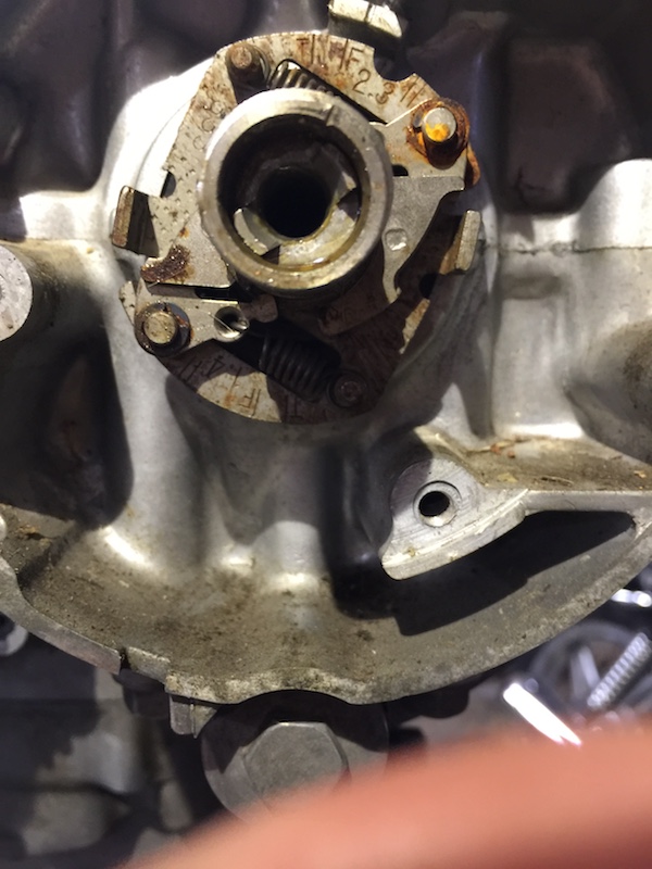

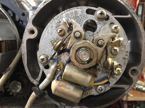

FUGLY
Again...FUGLY and STICKY
New points & condensers, oiled felt, Pre-Treated connections w Deoxit protector.
Purple locktite 222 on new Stainless hardware and a pair of 5.5mm wrenches are a must own.
Cleaned, inspected and lubed
Fresh grease in the groove.
Task complete.   8)
