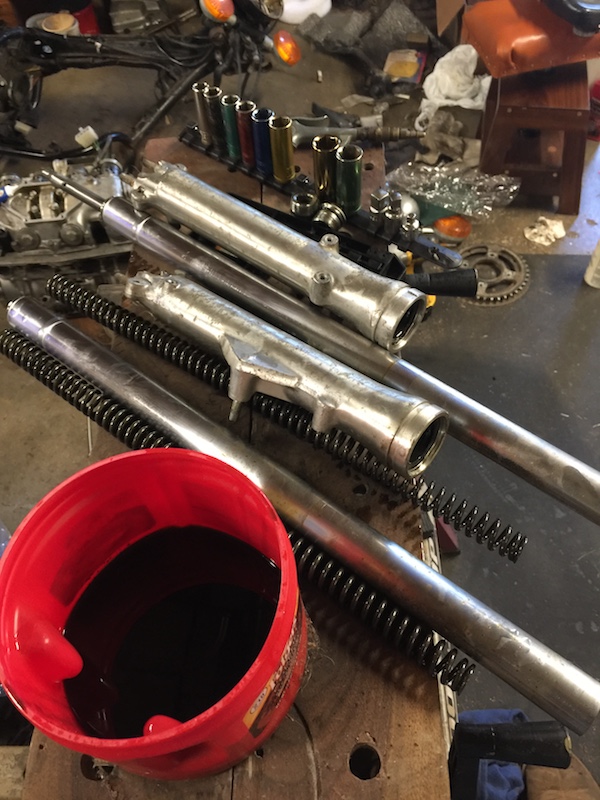

I decided not to wait for new tubes to arrive from Hong Kong.
Moving forward w fork rebuild...Rusty RAT ROD style.
Draining stinky old fluid I almost lost my lunch a couple times.  haha.  ;D

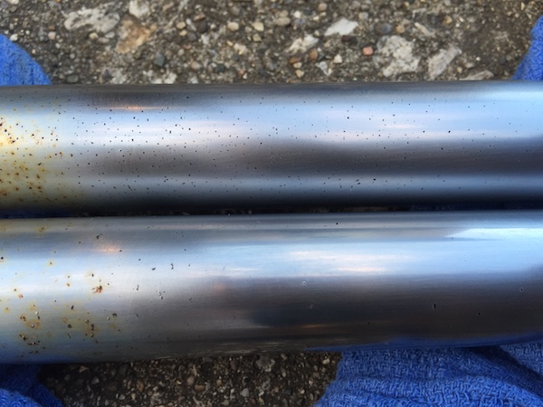

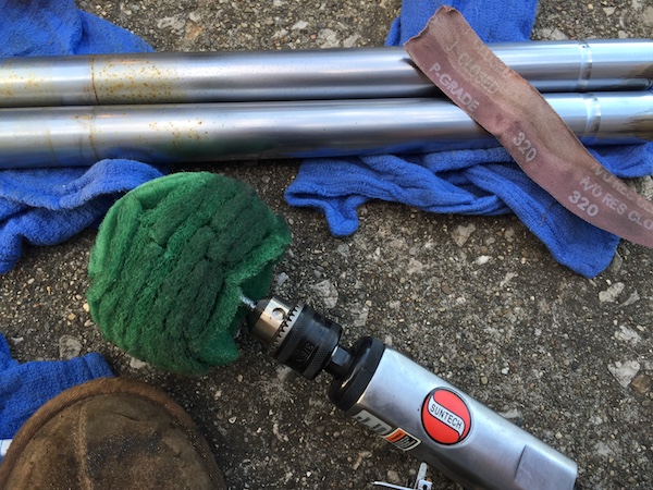

Sanded the slide zones w 320 emory then hit em w the scotchbrite.
They came out remarkably smooth.  But I will have to keep a smear of grease on em.
They will get me by for a season or two,
Until the proper restoration rolls around.
yes heating the old seals for removal...So STINKY!!!
All buttoned up,
fresh o-rings for caps once installed and filled w new oil.

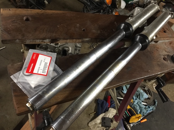

New steering bearings...NOT!!!
Sent me the wrong ones.  UGH.   >:(
On the upside.  New fork tubes arrived just in the nick of time. A lot sooner than I expected.
So I went ahead and got them installed.   :)
