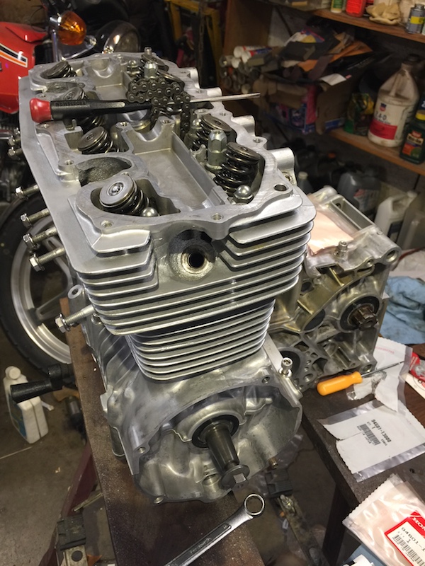

« Reply #400 on: Nov 03, 2018, 11:45:09 »
Eight valves = zero leaks.  :)
Sat for about 15 minutes per side filled w alcohol.
Now, pulling them all out again to finish cleaning carbon deposits, clear out alcohol, lube stems and install guide seals.   :P

« Reply #402 on: Nov 07, 2018, 10:32:19 »
I've found isopropyl to be good at loosening/softening deposits, too.

« Reply #403 on: Nov 07, 2018, 14:27:26 »
I believe you’re right.  No longer than mine sat.  Some seemed a bit softer.

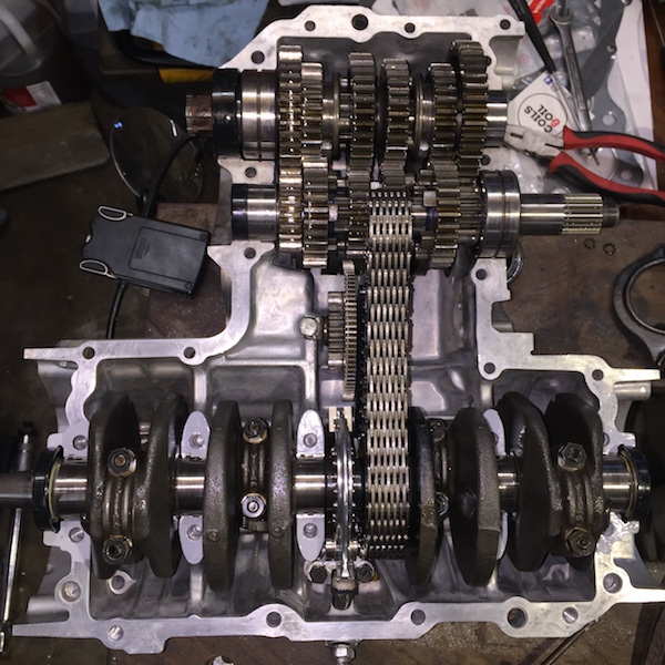

Offline trek97
  • DTT BOTM WINNER
  • Posts: 6122
Re: Black Knight, Migration
« Reply #405 on: Nov 10, 2018, 16:15:56 »
Good work bud.
Thanks man
 :). Pleased to see all the shift forks are within factory assembly specs
Taking a coffee break while hondabond "dries" before installing bearings.
« Last Edit: Nov 10, 2018, 16:20:18 by trek97 »
Offline trek97
  • DTT BOTM WINNER
  • Posts: 6122
« Reply #406 on: Nov 11, 2018, 00:52:12 »
A long day.
Tried something new as per Kanticoy.
To help ensure no jacked up rings.
I installed the pistons into the jugs first, then installed the pins and lock rings into the rods.
It was a tight working space but it went pretty well, once I got my damned bifocals adjusted to see.   ;D
