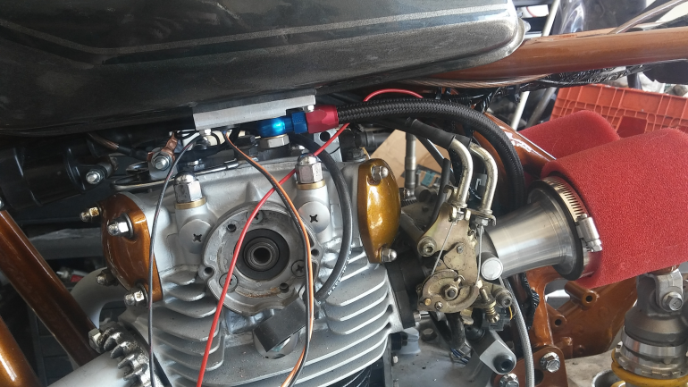

 The pictures show the cam wheel and sensor mounted, as well as the right ITB with the throttle position sensor.

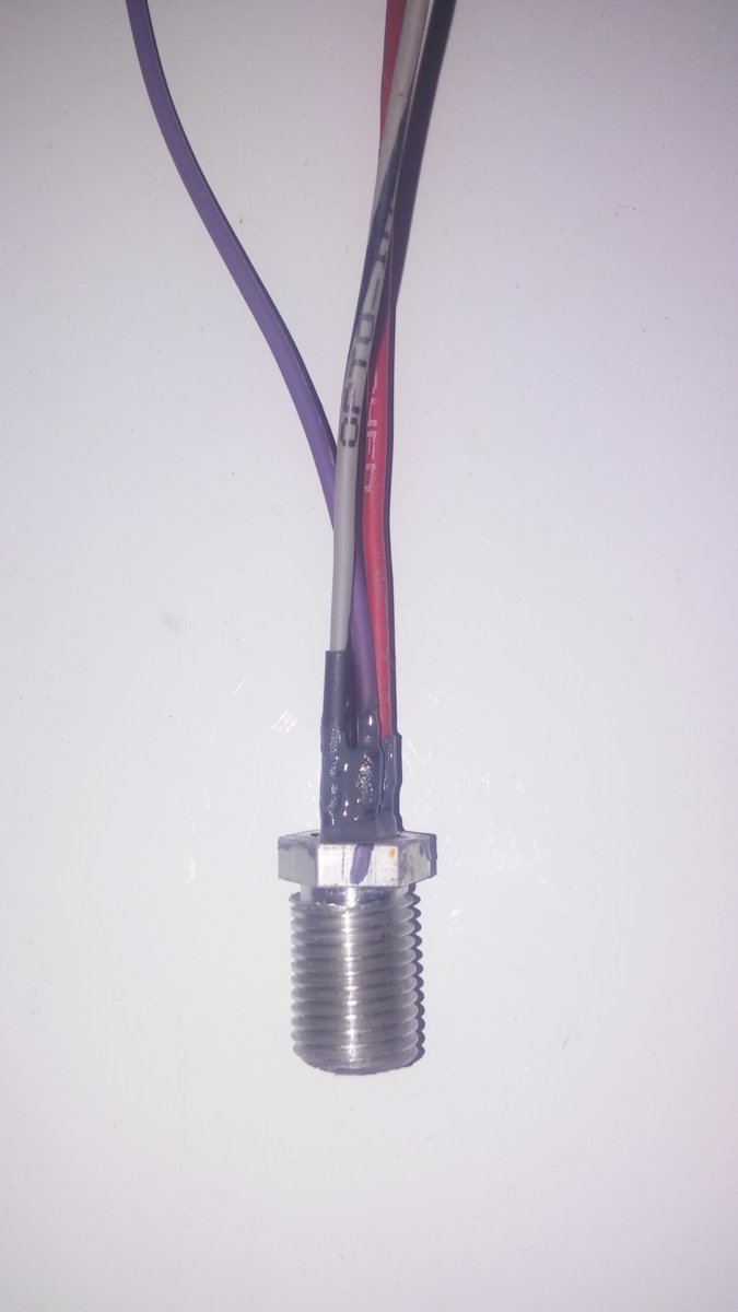

The sensor for the trigger wheel

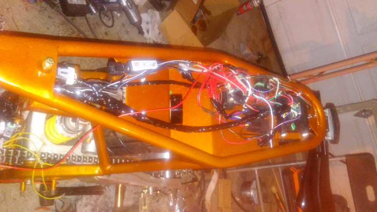

and all the wiring under the seat.
