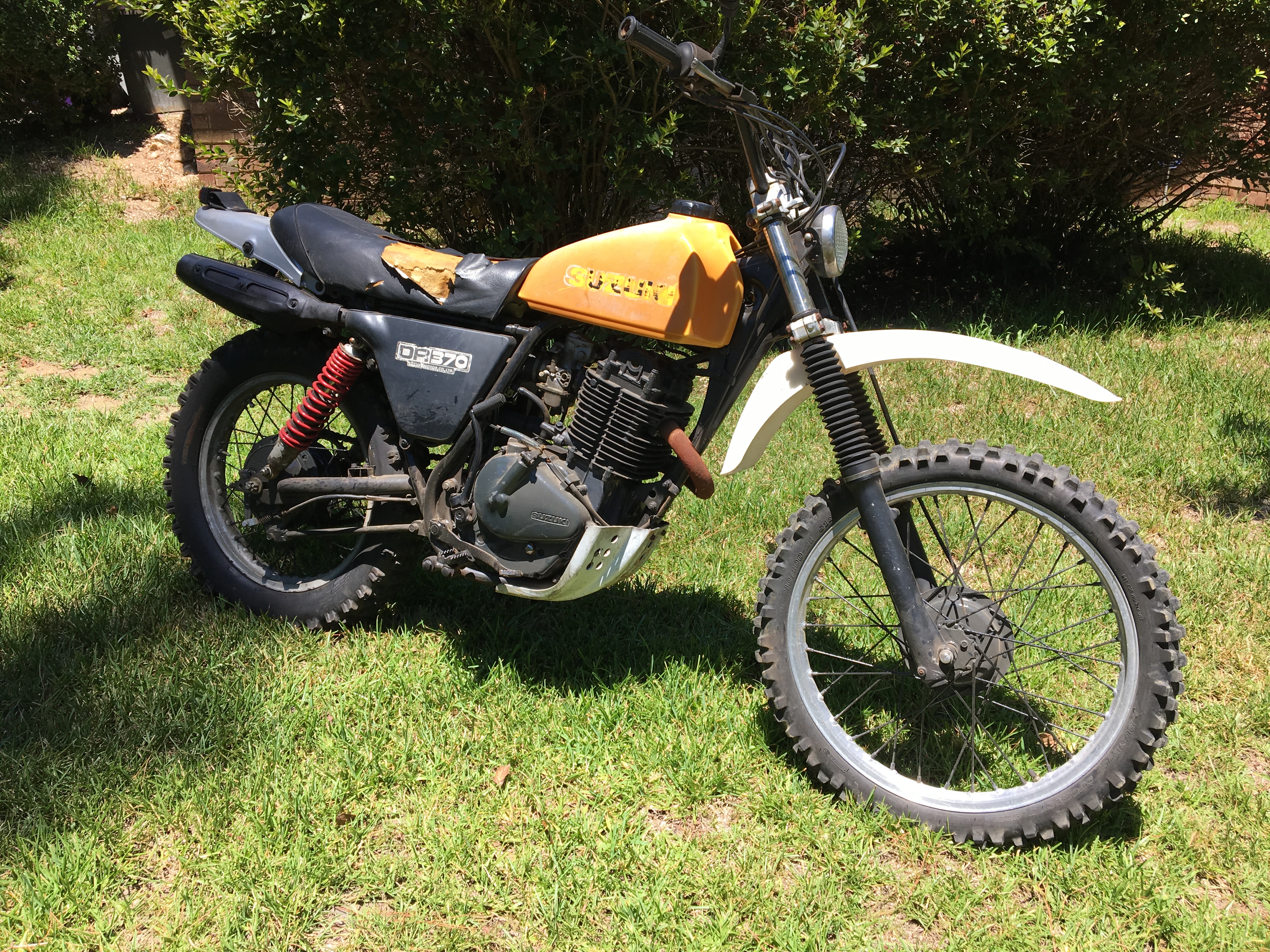

I came back from Mid-O with a 1978 DR370.  It's a good running bike with a lot of painted rust, but the bones are all good. It'll need a bunch of work to make it pretty, but my intention is more to have a bike I can run in AHRMA Post Vintage MX Historic Class races, Hare Scrambles and other events.  Plus one that will handle itself on the trails I frequent many weekends.
Here it is in it's current glory with a PE tank on it for now:

Love those alloy rims with the little extra lip on the side, hope you're hanging on to them?
Offline irk miller
  • DTT BOTM WINNER
  • Posts: 8695
Re: 1978 Suzuki DR370 Historic Class Hellride
« Reply #9 on: Jul 10, 2018, 11:43:53 »
For sure.  The front rim is in great shape.  The rear rim is straight and appears dent free, but seems to have been painted with a silver paint.  The spokes are all rust, so when I take the wheels apart to replace them, I'll clean the rims up.
